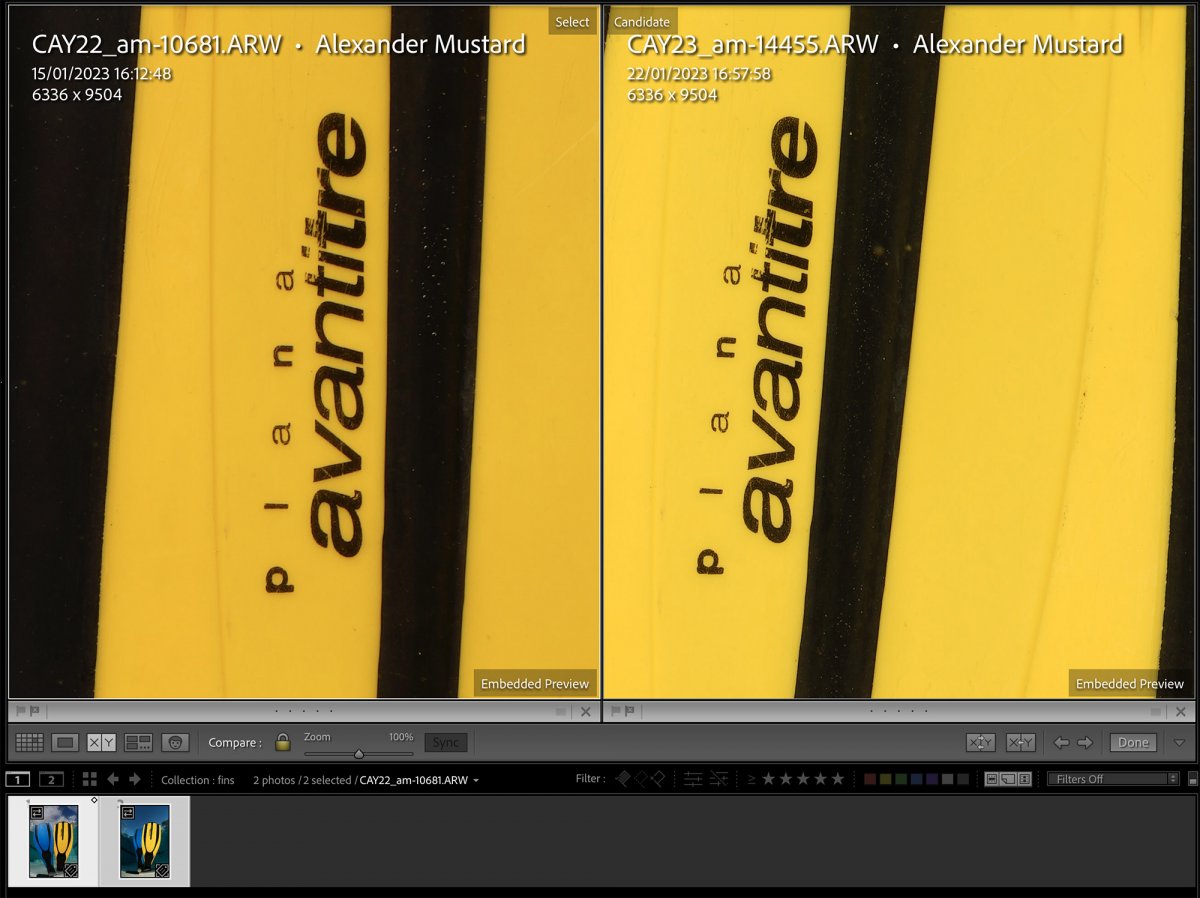

  1. Isaac got me interested in a central frame comparison. And I found this one of a more realistic situation - a subject rather than a wall.
    The WWL-1 photo is on left (this time) and the WACP-1 is on right. Both taken with same camera and lens (A7RV and 28-70mm) - giving 61MP file. DO CLICK ON IT AND VIEW IT PROPERLY, ideally on a monitor.
    The two shots are actually taken a week apart and the camera (on Auto WB has chosen a slightly different WB for each). But the subject is the same and the framing is almost identical (you can see the thumbnails of the whole images at the bottom. They are also zoomed in to exactly the same pixels in the images. The WACP-1 is definitely crisper to me, but the difference is less marked than the corners.

  2. Sorry for my confusion, Alex. I understood that we were just talking about corner crops. What I meant is of the crops you posted the WACP-1 at f/4 is very clearly sharper than the WWL-1 at f/6.3. I had thought you were saying they were equivalent, but now rereading your post I understand that you were saying that the WWL-1 at f/6.3 is slightly worse than the WACP-1 at f/4 but better than it at f/7.1. Based on these examples it's surprising that the WWL-1 improves enough at f/7.1 to overtake the WACP-1 shot (because at f/6.3 it's not close).
  3. Hopefully this image loads and can be viewed large enough to be useful. WACP or WWL for Sony.
    I have compared the corner performance of the WACP-1 (left) and WWL-1 (right) in the pool. The two shots are both taken with A7RV and 28-60mm @28mm. Left with WACP-1, right with the WWL-1. They are not perfect test shots, but close enough. The images are scree grabbed from LR to compare the pool tile detail in the top right corner of the image (zoomed 100%).
    From the tests I would conclude that the corner performance of the WACP-1 at aperture f/4, is about the same as the WWL-1 between f/6.3 (show) and the next step, f/7.1. I think at f/6.3 the WWL-1 is slightly worse in the corner than the WACP-1 at f/4. At f/7.1 is ever so slightly better than WACP-1 at f/4..
    Alex
    Alex
    Thanks for posting this
    It is really a shot at the edges so the quality is what it is and different to the other poster I don’t see even that the WACP-1 is better
    However the fact is that the lens performance changes through the aperture range and the corners will get better as you stop down while center sharpness will drop
    The 28-60mm is the kit lens for the a7C a 24 megapixel camera and although I have found no resolution test I doubt that this lens will resolve the 61 megapixels of the sensor
    In general I doubt we can even see more than 40 megapixels except in macro
    It would be useful and time consuming to take a series of shots at f/4 f/5.6 f/8 f/11 and see when you reach acceptable sharpness overall
    A German site did this and concluded f/5.6 was excellent on the WACP-1 and f/7.1 was good on the WWL-1 that stopping down didn’t bring overall much benefit as centre sharpness drops
    Personally if I was getting the WACP-1 I would be looking of the tamron 28-75 gives better results instead of going for the sony 28-60mm or even looking at the wacp-2 with the sony 16-35 GM
    If you don’t stay small go big or go home
    Assuming the maximum benefit is 1 1/2 stop for this comparison I guess the WACP-C is likely to be in the region of 2/3 stops so an even more difficult decision
    Alex
    Are the aperture numbers the same as in the images taken from the corners (f 4.0 for WACP-1 and f 6.3 for WWL-1)?
    => It is a pity that one cannot like postings from moderators/supermoderators. So I take the occasion to thank you for for this enormous effort. This thread (and the one on WACP-C) has already given answers to important questions that I was searching for long...:good:
    Wolfgang
  6. 26 minutes ago, Isaac Szabo said:
    It’s not surprising that someone who doesn’t understand how monitor pixel density affects the ability to evaluate image sharpness cannot see the obvious sharpness difference in those images.
    Pixel density affects nothing other than the distance you need to look at the image. If you have a lower resolution monitor you need to look further away than a higher resolution monitor. Obviously if you want to stay in a fixed point resolution matters but I guess anybody has the ability to move close or further away from the screen.
    Second comment the images are not comparable the WWL-1 looks 1.25x larger and therefore depth of field is impacted. In that regard the WACP-1 image also does not look amazing it is a bit better but will it make or break an image I do not think so. It is possible if the shots are taken exactly in the same point that the WACP-1 has actually a larger field of view of the wet lens
    Ultimately in a reef scenes nobody goes and peeps at the corners unless there is something interesting in it.
    Corner sharpness is much more important when you shoot burst of subjects that move fast, the subject may not be in the right place and if you crop edge sharpness matter. In most other situations including underwater wide angle you have composed the shot, the edges are impacted by many things like lack of light, further distance etc who cares what goes in there
    I am really not sure not sure if 1 stop corner improvement matters much considering those adapters are not really for close focus shots. Yes of course you can get close but if you were really close you would have a fisheye and if you wanted straight lines you would have a rectilinear lens
    If you shoot something close with a rectilinear lens also topside it looks weird and the corners pull why would you expect underwater to be super sharp I am not sure
