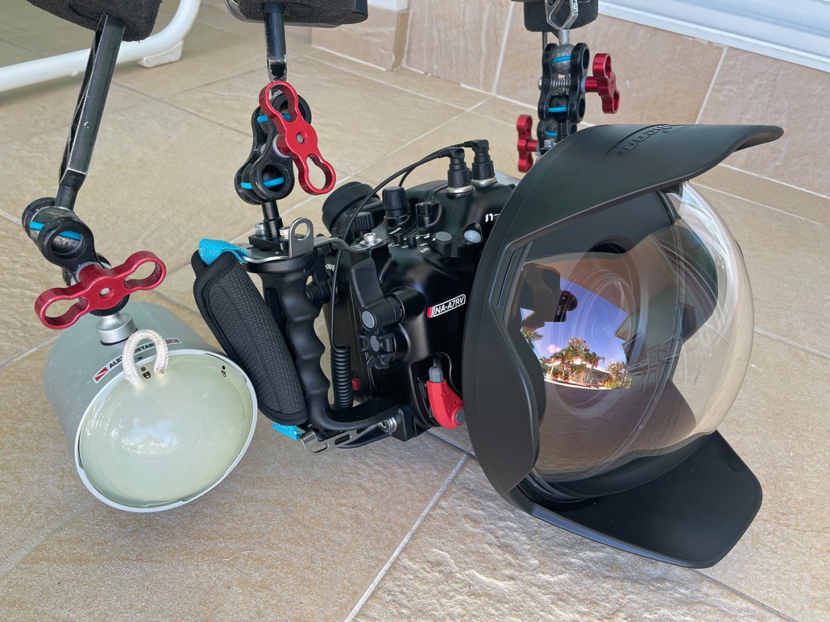

  10. I will be giving the A7R V a run over the next couple of weeks here in Cayman. Will surely be back for advice and to share findings/pictures.
    Which lens do you have mounted in there?
    Are you also going to be testing any of the WACP-X variants?
    Thanks,
    - brett
  12. Canon fisheye. Fisheye is the best lens for this destination.
    I also have both WACP-1 and WWL-1B to test with the 28-60mm. I'll try and do them on back to back dives so I can comment on how they compare.
    Alex
