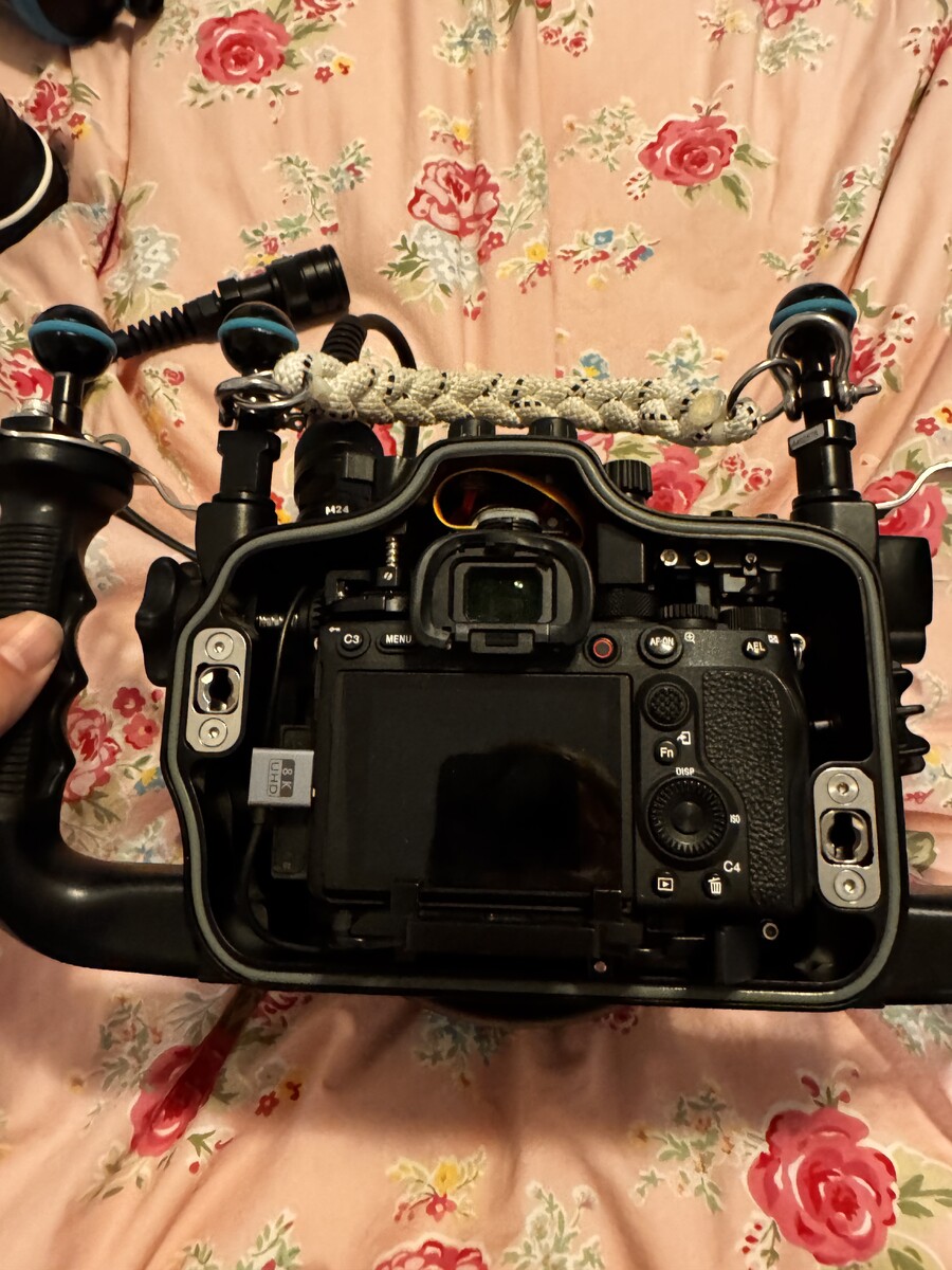

Hello - I have followed this forum for a few years, and became a member about a year ago but had never posted an intro. I am replying to the forum related to the Kraken 5.5" monitor which I have used for about a year.
I am a novice underwater photographer. My current gear includes Sony A1 camera/Nauticam housing/Sea and Sea YSD-3ii strobes, kraken 8000 lights, and UW technics flash trigger, a kraken 5.5" and mosty the WACP1 wet lens (with 28-60 mm sony lens).
I found the Kraken 5.5" monitor to be easier to use than the Atomos Ninja in housing (the Atomos does record - Kraken doesn't, and the atomos in housing is far less negatively buoyant in water whilst the Kraken required I add buoyancy). I find some of the functionailty of the Ninja to be challenging in the housing though and some not available when in housing. By contrast the controllers on the Kraken are easier for me to use underwater and for my needs, the functionality of the kraken monitor outweighed the travel weight, buoyancy challenge, and lack of recording.
I fully agree with the others who commented on the ribbon HDMi controller. Its very frail and caused flickering, required that I downregulate the quality of the HDMI output from my camera and sometimes just didnt transmit signal at all. I switched to this :
Duttek 8K Right Angle HDMI Extension Cable 1FT, Ultra Thin Coaxial 90 Degree HDMI Male to Female Cable (48Gbps, 8K@60Hz, 4K@240Hz) Support Dynamic HDR, eARC, for GH5S, PS5, PC
I purchased on AMAZON. There are right and left right angle versions - I can get both to work with Sony A1 in Nauticam NA-A1. I did require Kraken to provide me with a modified bulkhead so I could use this cable. Prior to my using that Kraken sent me a right angle HDMI cable for inside the housing with the modified bulkhead to the external HDMI cable and Nauticam has an option. But these are more expensive, more bulky, less flexible. For me this inexpensive HDMI cable inside the housing was a game changer and I went from being very frustrated to enjoying the monitor. Also, looking at Amazon it appears that there are other versions of this cable that I purchased over a year ago that may have replaced it or are alternatives.
Regarding the HDMI output, on my camera at least, if switched to "AUTO" it worked just fine (it needed to be at 1080p when I was using the annoying ribbon cable).
Hope this helps.
Anyways, pleasure to meet you all and thanks.
1ft cable?
You have a lot of space inside. In my GH5 I have the original Nauticam (maybe 15cm) and it's nearly too long.
Could you post the Amazon Link? From Italy I can't find it.
Thanks for the feedback

Hello - sorry for delay. The amazon link is shared below. Apologies i hadnt considered the cable length - I think thought that this is because the cable is so thin and flexible that I was able to easily fold it in the housing without issue. I cant speak to the other housings, and i dont know if the same cable or style exists in shorter lengths however a cursory online look at B&H showed other 8" thin HDMI cables as well. I can say that this this cable at 1 foot was far more manageable in the housing than the ~15 cm cable that was provided due to flexibility.
https://www.amazon.com/Duttek-Extension-OD2-5mm-Support-Dynamic/dp/B0DCS5ZH4Z/ref=sr_1_3_pp?dib=eyJ2IjoiMSJ9.2VpuRMLwZ81tMjasc6JY-aqK1vIp7vSnRy0ZBBGgVGfqVFc7EGOu8XRi9EQMpye3hn_l85gNQ5qGfMipOGpJu25apRzDaEryAx4OgTF5-7lwpQEGXiyy9_sPlJBbk5vVgEgb26OFLwqoa3JtCla3b16srO6HJywz-6O84FYqzYxLrS4Fri_h4S3QCe6U664M9CNtef1v2X3mT8RP-VPVftk4zHUArpXA2vO_vX3-FeY.gHbtksFa1GwUAT_VaqP8OWvLBd42gSTFQ7CYIx1-wHA&dib_tag=se&hvadid=695201706934&hvdev=c&hvexpln=67&hvlocphy=9060420&hvnetw=g&hvocijid=9878799745913222723--&hvqmt=b&hvrand=9878799745913222723&hvtargid=kwd-305243972538&hydadcr=18917_13353551&keywords=hdmi%2Bcable%2B90%2Bdegree%2Bangle&mcid=24e5b35e7cf431958426eef549481662&qid=1758025793&sr=8-3&th=1
Personnally, I've been using DIY FPV HDMI cables. It's cheap, compact, easily replaceable available on Aliexpress, Amazon. You just need to properly insulate the PCB for the HDMI plugs. No soldering required. I've been using that on my GH5s and Z8 for years without issues.
Those ribbon cables are also present inside some UW monitors like the Weefine WED-5 and WED-7 and also Gopro housings from Hugyfot.
Edited by eocean-eu
I simply use basic electric tape most of the time (laziness) but you can also use heat shrink tube or insulating spray (best option since this is what people use in the FPV drone world). It's possible that PCBs are already insulated but I haven't checked and there are a few manufacturers with slightly different PCBs.
Edited by eocean-eu
