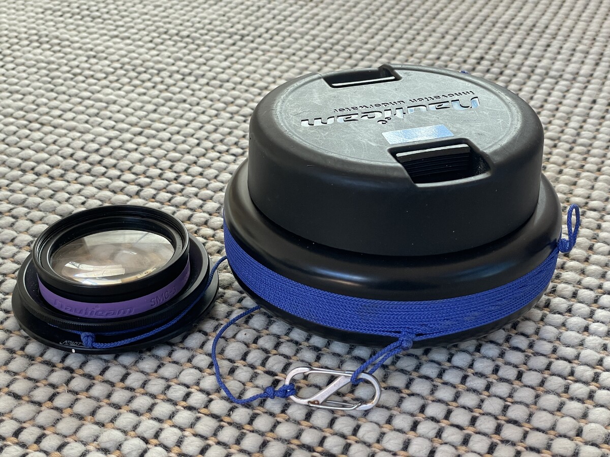

On my lens I replaced the rubber grip with 2mm cord (Aldi special) with a couple of lanyard loops and coincidentally used exactly the same clip. Because I sometimes take the WWL-C off during a dive to use the 24-50 and very occasionally with the SMC-3 (stupid small focus range and hard to use but better than nowt!) I have a nauticam bayonet mount for the lens attached to my right hand BCD shoulder strap so the security lanyard is a great backup :-).
I think that I perfer your soulution so will have to comandeer some of the TPU in my wifes office.
