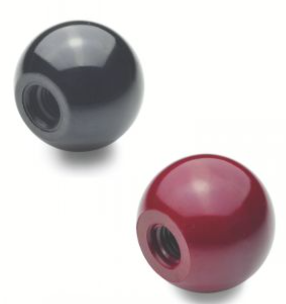

You will find some by Amazon or other providers.
I use such pieces since over 10 years... I never had any problems with it.
