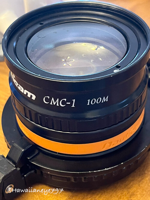

@Babydiver It appears you can physically stack the MFO-1 and CMCs - but whether it works will require some testing.
