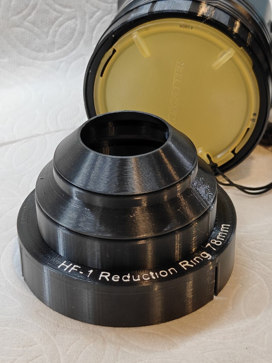

FYI - Retra just confirmed in a email exchange that they will not make an LSD adapter for the HF-1. They also understand Backscatter has shelved the idea of a snoot for it as well. The reason given was it “is not suitable for shooting.” Too bad, both the LSD and HF-1 are quality pieces.
Too bad. Meanwhile...
FYI - I am adapting this for Retra so there is an alternative to paying them $150 per strobe for a few grams of plastic.
Edited by Dave_Hicks
Once again Dave Hicks for the 3D win!
