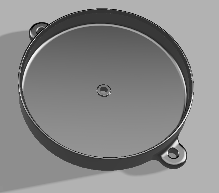

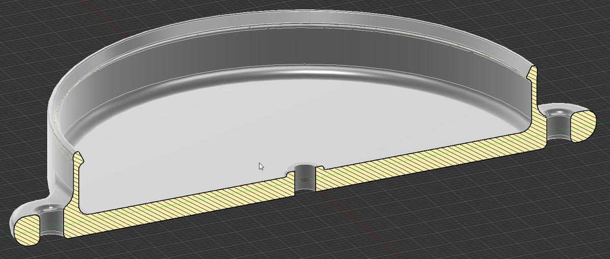

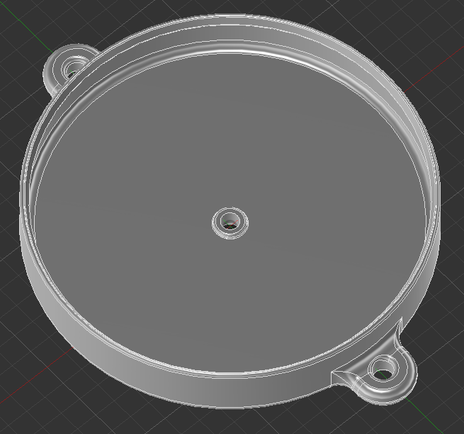

I found that the original cap have some problems.
  • nothing to hold it when not on the lense
  • Heavy (relatively ;) )
  • Black... I don't like ... seriously difficult to find if it his lost.

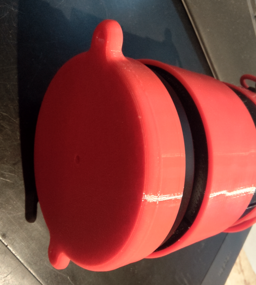

I build a new one, to print with TPU
You can print it in red ( like I made it) or black and why not pink or some phosphorecent TPU....
If you want the 3D STL... ask I will sent you the file.
If you want some modification same ask...
Marelux
  • Author
The result,
I need to attach a small bungee and it is ready for the trip

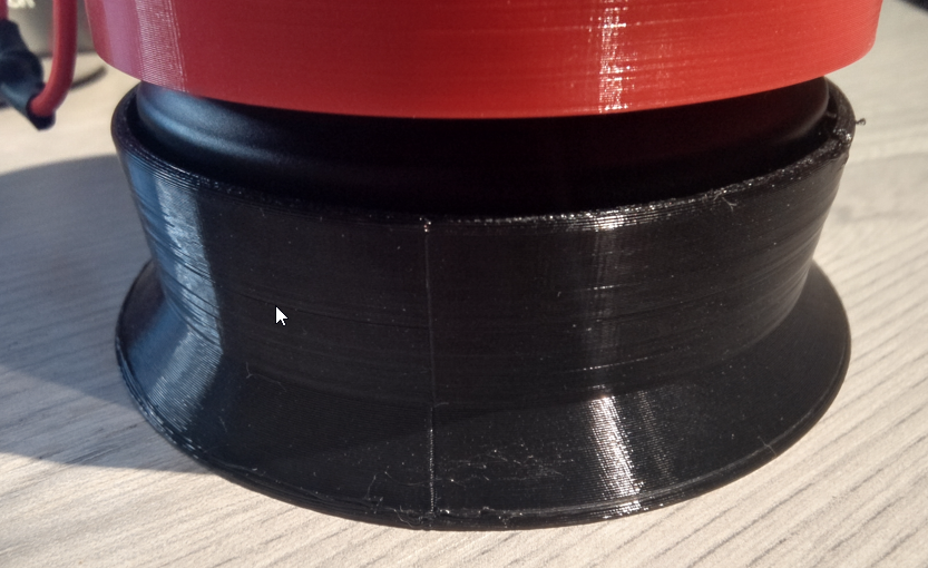

I'm working on it, built a TPU version but it doesn't fit with 82mm cap (which is common for the original lens cap), the Nauticam 57$ m82-filter-holder-for-mfo-3 inspired me to make a refined version, shall be ready in couple days.

Not a bad idea... on the other side the MFO-3 is for larger subject.... normaly the glas didn't approach coral or other things...
I have the base to build a short hood I'll make that today
Edited by CaolIla
  • Author

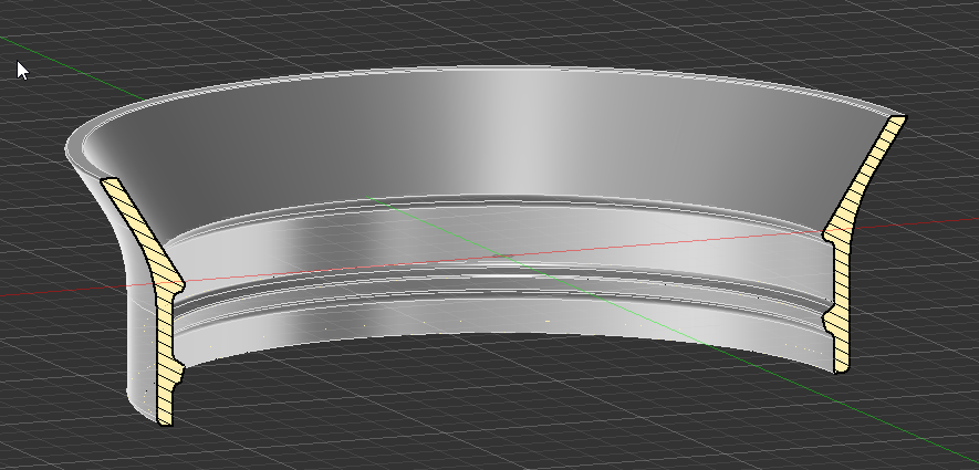

It tooks more time as estimated Printing with TPU need to be patient more that with normal PETG or PLA. It is very slow.
The last version

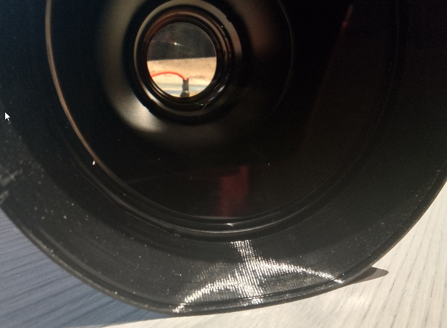

First print the part on the top was vertical... not good I saw the hood thru the lens
I made a second with a top larger but to thin probably. It is ok but I'm not happy. Now I increase the thickness of the part in the top In 2h now I'll have THE hood ;)
The hood is a little bit visible thru the lens (really only a little bit) but in the water I'm sure it will disapear.
Second version
The hood is 18 mm deep, for surr it will provide a good protection at the front glass of the MFO-3. It is firmly in place it can't be loosed.
If you want the STL, ask I'll sent you the file in a MP.
(Sorry @Davide DB I didn't publish the file, I want to know who is using my "work" to many consumer... and no feedback, it's my point of view please respect that. Thanks)
