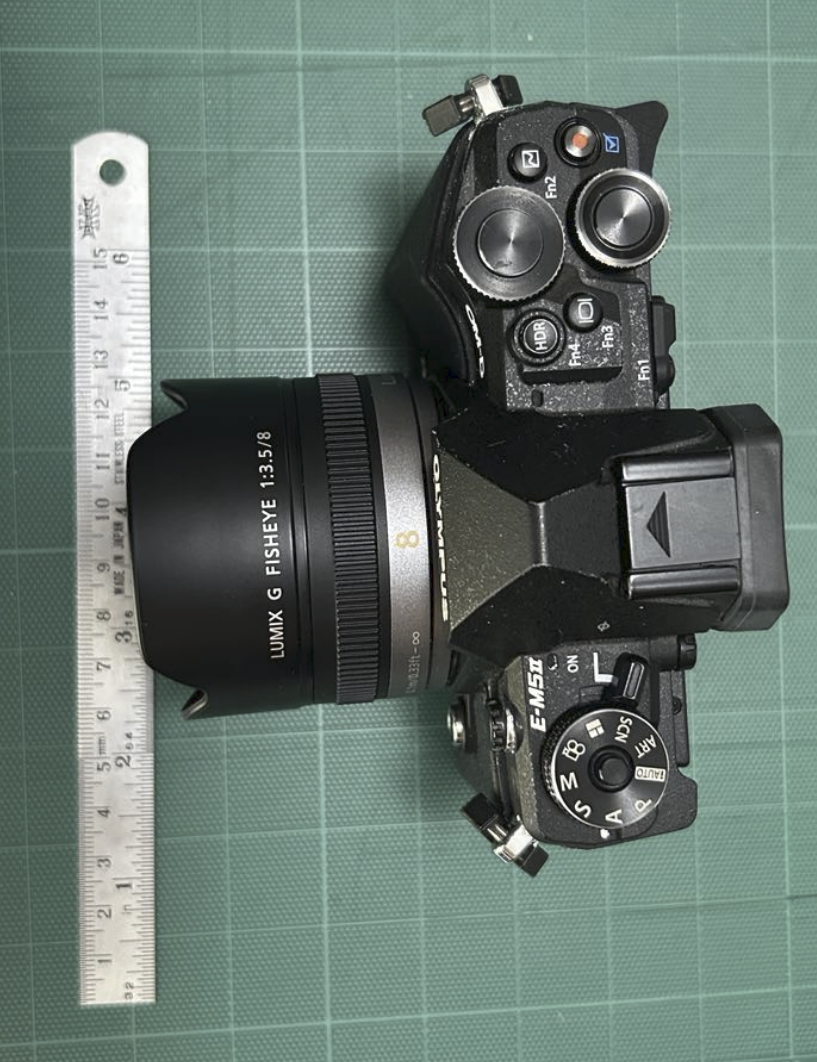

Quite a few things to consider, first thing to think about is the budget you have in mind. Secondly the camera body may be small but full frame lenses are large and expensive and the ports to house them are larger and more expensive. Then there is the matter of ports, wide angle rectilinear lenses demand large ports. You mention the 14mm f2.8 lens, in Ikelite their basic recommendation is to use it in a 6"port which seems a bit on the small side for a 14mm lens and the corners will likely be soft. Ikelite also mentions that the DLM port system used with the A7C II housing can't use the larger lenses that other Sony cameras can in their system. 14mm rectilinears are not that popular UW and fisheyes and wet optics like the WWL are used much more often. Fisheyes are very useful UW as there are few straight lines except perhaps wrecks and for the most part you could never tell a fisheye was used.
To demonstrate the size difference here is a a comparison of the A7CII with 90mm macro and an OM system OM5 with a 45mm lens, they both have the same reach and both achieve 1:1, however the whole package is a lot smaller with the m43 macro lens which will also fill the frame with an object half the size of the full frame lens and arguably you wouldn't need wet lenses:
https://cameradecision.com/size-comparison/7en0_idfy-FtDC_KsMO-t
For wide angle UW I'd suggest considering a fisheye. For Sony that means a converted Canon 8-15 fisheye, while for m43 you could use either the Panasonic or Olympus fisheye, which has a number of advantages, besides being small and light it works very well in a 4"dome for reef scenics and CFWA and will focus right down to the dome surface. Here's a photo of an EM-5MkII with a Panasonic fisheye lens attached:
The EM-5 II is the same size as the current OM system OM-5.
So the summary is that camera body size is a very small part of the overall weight and bulk for travel of an UW system, the lens size, weight and price is much lower with m43 equipment and the ports to house them are significantly smaller. The sensors in m43 are a good step up in quality compared to the RX100. Don't get me wrong a number of people are happy using the A7C cameras, but they don't provide the compactness you'd expect based upon their camera body size.
