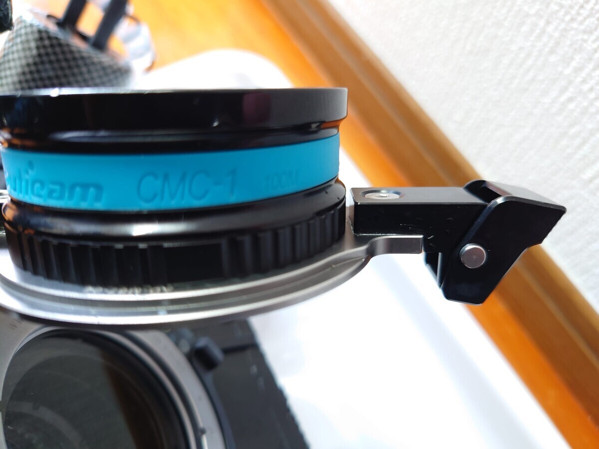

I use the AOI double flip, and plan to use it with MFO3 when I get one.
The AOI flip works fine (I use it with an Inon UWL-H100 wide lens + dome port, it holds the weight), but keep in mind that you need to use the small Nauticam adapter to use their wet lenses (the AOI adapter itself is not deep enough, more details here: https://waterpixels.net/forums/topic/2611-question-on-dual-flip-lens-holders/page/2/#findComment-19553 and here https://waterpixels.net/forums/topic/2611-question-on-dual-flip-lens-holders/page/2/#comment-23000 )
Edited by bghazzal
My MFO3 came with an M67 adapter, seems to be a different one to the one you linked in your post, the glass sits back behind the end of the adapter when it is installed, so should attach to most any M67 accessory.

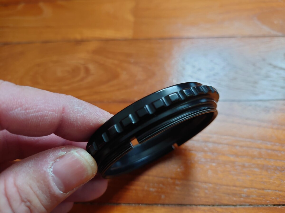

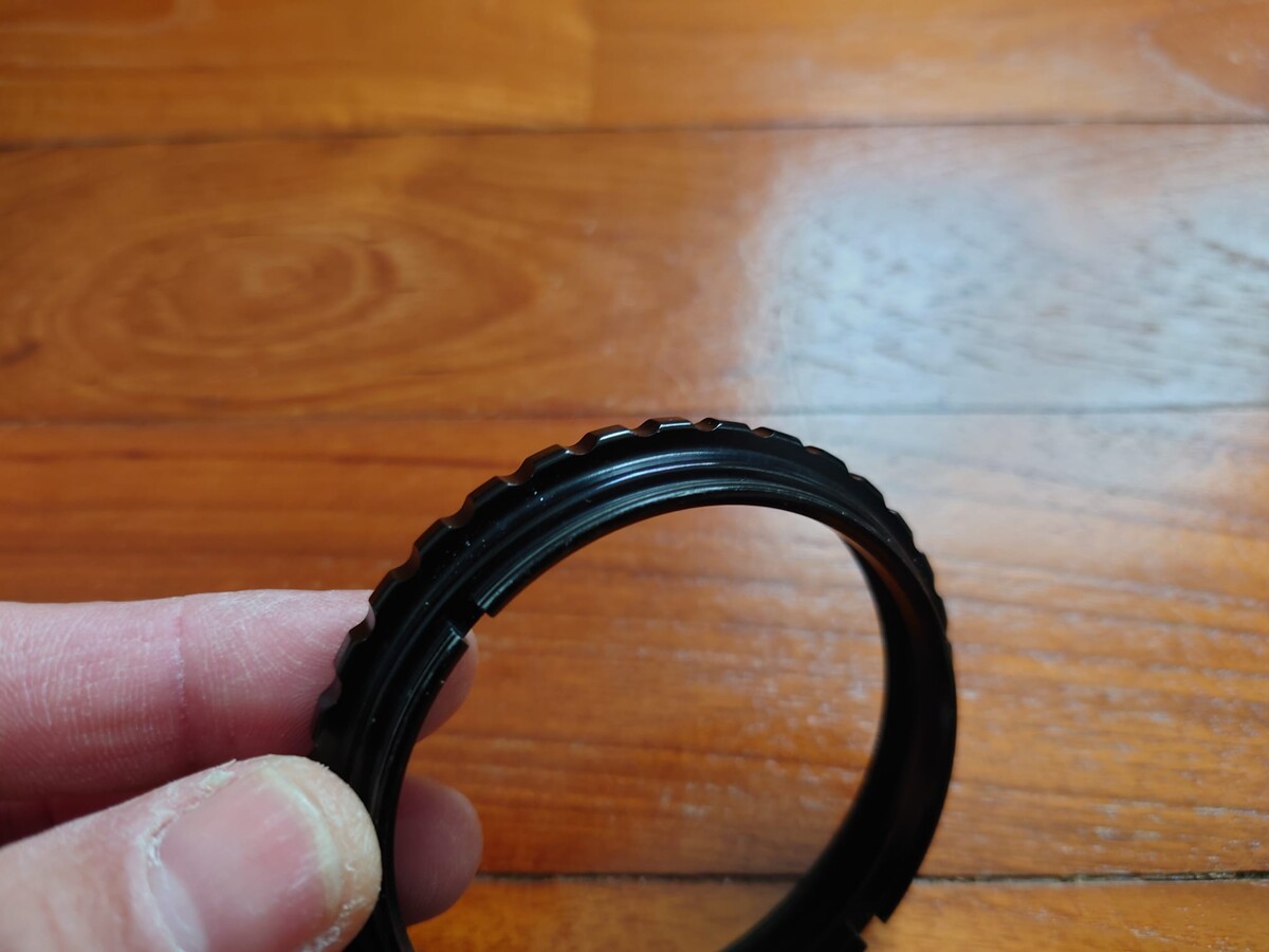

Is the 67mm adapter provided with the MFO3 like this one? (this is the one that comes with the CMC diopters and a few others)
WhatsApp Image 2026-02-23 at 15.43.35 (1).jpegWhatsApp Image 2026-02-23 at 15.43.35.jpeg
If this is the case, then it's not possible to use it with AOI flip unfortunately - the adapter can't be screwed onto the flip holder because of where its locking mechanism sits, the adapter's protruding toothed section gets in the way.
It's also not possible to use Nauticam diopters with this kind of design without a 67mm adapter on the AOI fllip because the rear end sticks out too much (the flip adapter base is too shallow) - the diopter hits the port glass and this prevents the locking of the adapter when the diopter is fully screwed in.

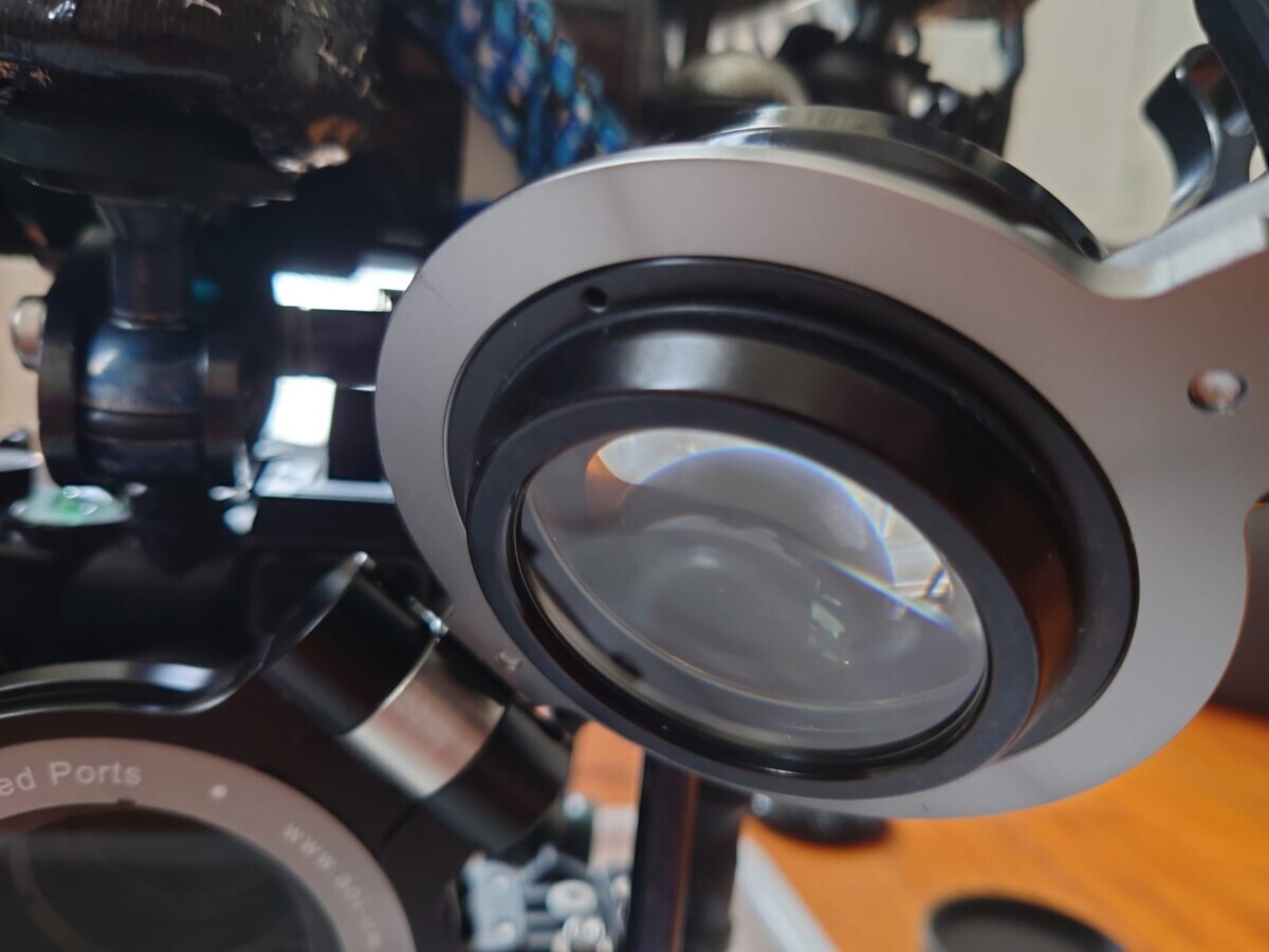

Fortunately the smaller adapter (which has to be ordered from Nauticam) works, since the toothed section doesn't protrude as much and clears the flip's locking mechanism by a few mm, like this:
