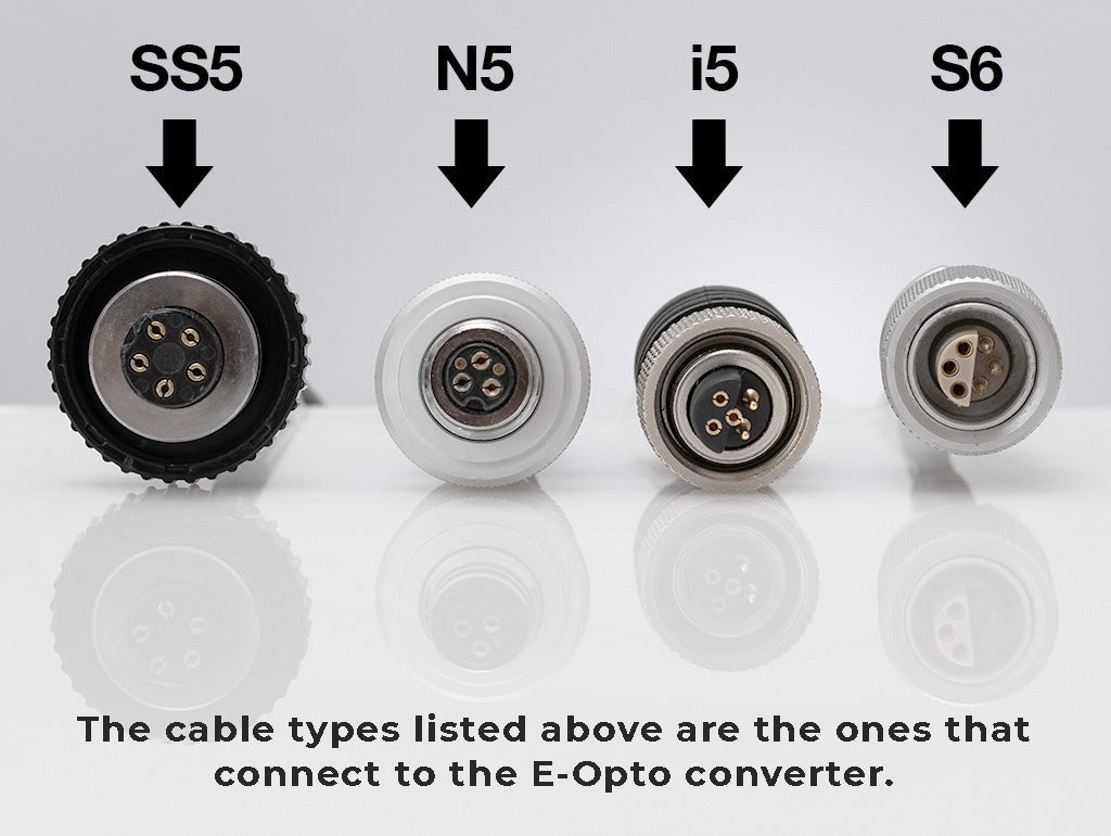

This converter from Retra might work, particularly if you are using a Retra strobe:
Retra UWT
No image preview
E-Opto converter
The E-Opto converter is a simple and reliable optical trigger that generates optical signals from electric input. The E-Opto converter comes with pre-installed batteries that will last for more than 1
You would need to confirm your Nikonos is wired the same way , it should work with other strobes on manual, but as you will note it is not guaranteed to work with strobes other than Retra.
