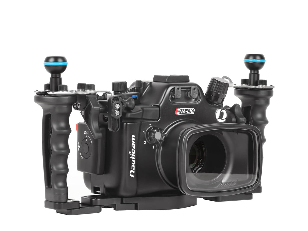

Design seems very similar, need to see how Nauticam handles it
As a reminder, the NA-LX100 housing turned out like this:
VS. this format for the NA-LX10
Pietro Cremone of Nauticam Italy wrote about it days ago.

This housing is very NA-LX100 looking (and there is an error during the product photoshoot with a Canon lens showing up along with some accessories).
