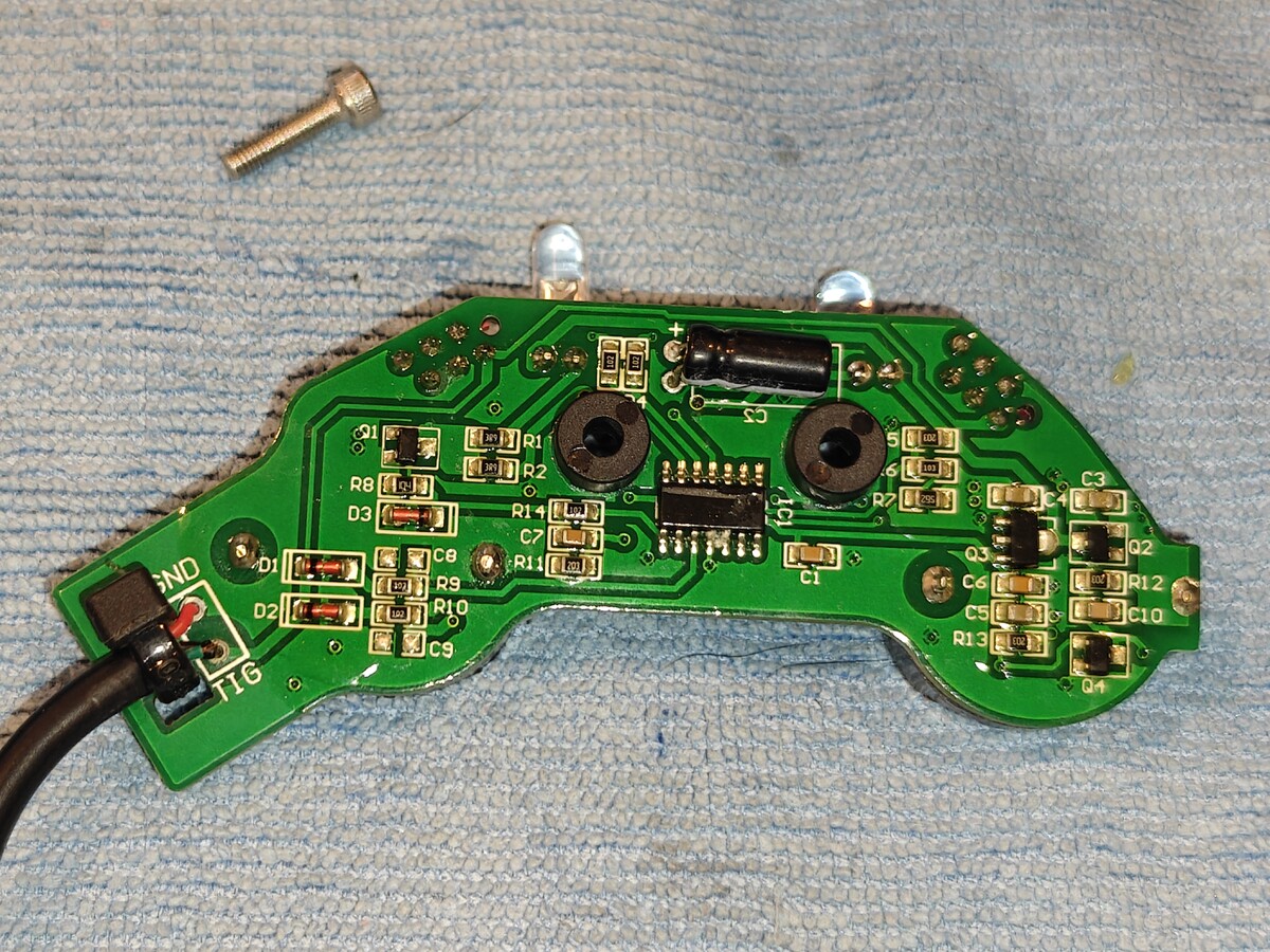

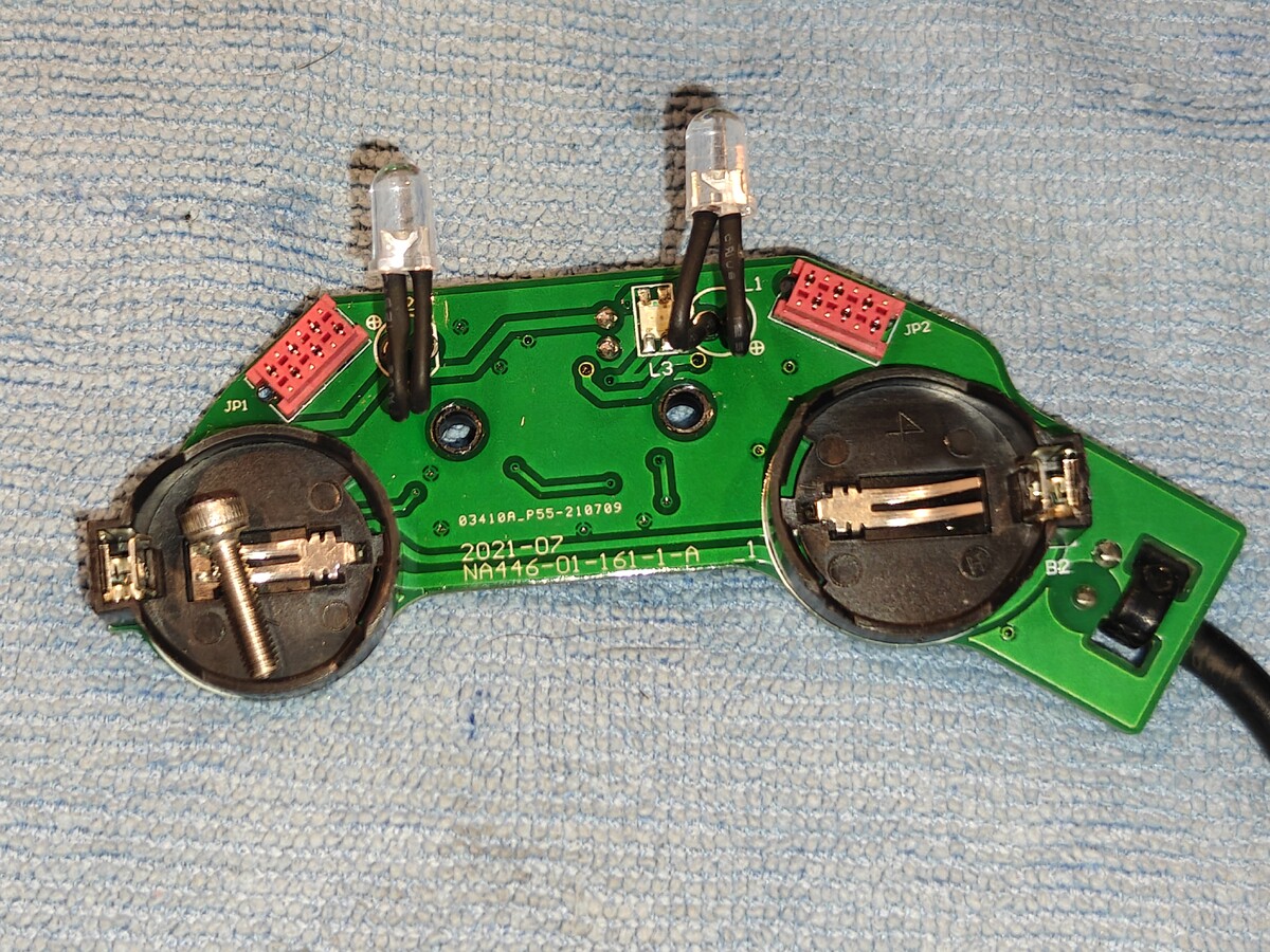

This is the "good" version of the Nauticam trigger. It's seemingly the same as yours by the numbers.
However I am not sure the hardware tells the full tale, there may be a firmware component as well. There seems to be only one IC on this circuit board, and I have no idea if it is programable.

The PCB layout looks exactly the same as mine, but apparently my trigger still doesn’t work properly at 1/200s.
