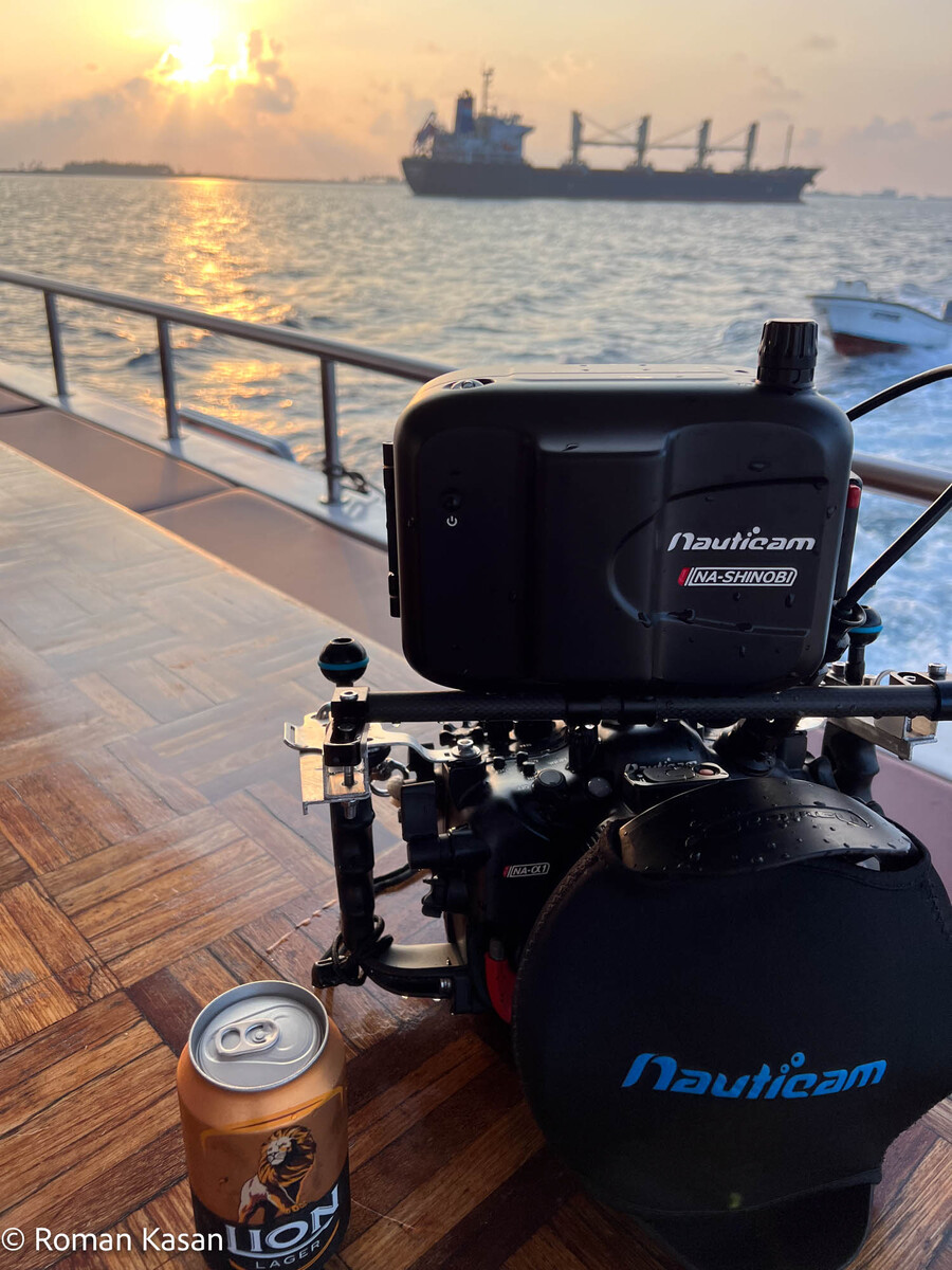

Nauticam A1 II Housing + Nauticam HDMI 2.0 Connection
Ahh! I did not realize that A1II has different port layout than A1mkI ! I certainly could not use this on my camera as my USB-C port has been made absolutely inaccessible by that L Hdmi... good luck then! π (btw the picture you shown is that of A1Mk1. Your HDMI will be lower and that cable will get bent hell of lot more so beware (!!)) When I was using Shinobi (still have it but now switched to WED5Pro) I found the LOG-HDR conversion indispensable in highly lit low contrast shots (imagine closer to surface shooting with surface in shot or like milky kind of environment like I was filming galapagos sharks at Malpelo at the surf brake zone and overcasted). That environment combined with overexposing slog3 produced white screen so even though I would know where I was with exposure with waveform I would have no idea what am I shooting :-). Even if I had view assist in camera ON. Obviously you cant use it as it would get recorded like that. While with Shinobi HDR tone mapping it really was WYSIWYG without affecting underlying footage. But I was able to make do with Shinobi as I left it on HDR tone mapping and just got used to the fact that my stills were a bit brighter in colors on a monitor preview π€£. Or I shot stills with Slog3 and called it a day π€£. Having said that even though I have now option to switch log conversion on and off with wed5pro I found myself that for me I should simply choose a dive being either video or photo as the mindset is just completely different but I guess I am getting old π€£ Making a decision on FX5 myself :-) OCN1/2 looking so tempting but as always caveats what is available and where and how re:framerates and also no reports on CWB yet. Good luck!
I say you are out of luck. Not using HDMI 2.0 but HDMI 1.4 for my Shinobi. From what I know the 2.0 cable has - must have - the same philosophy which is to go from top through zoom ring to the bottom and then up and so the HDMI right angle connector will obscure the USB-C port underneath. With 1.4 solution you might be able to do some woodoo as 1.4 cable is separate from the rest and so you may try some ribbons etc but 2.0 cable is all in one piece if I am not mistaken so no woodoos there I am afraid... You've probably made your orders and I know I am stretching it but for the price of Ninja solution and then some you may have some internal RAW recording solution from elsewhere... Like Ninja total cost will be like housing for FX5... just saying... For hybrid shooting with Slog3/HDR preview I did not have the best experience with Shinobi - excellent image in one of two scenarios but cant really switch between noLUT for stills and HDR processing for movie underwater and I think it is going to be the same for Ninja. That touch screen interface and Nauticam solution for it dont cut it for changing setting underwater. Good luck though.
