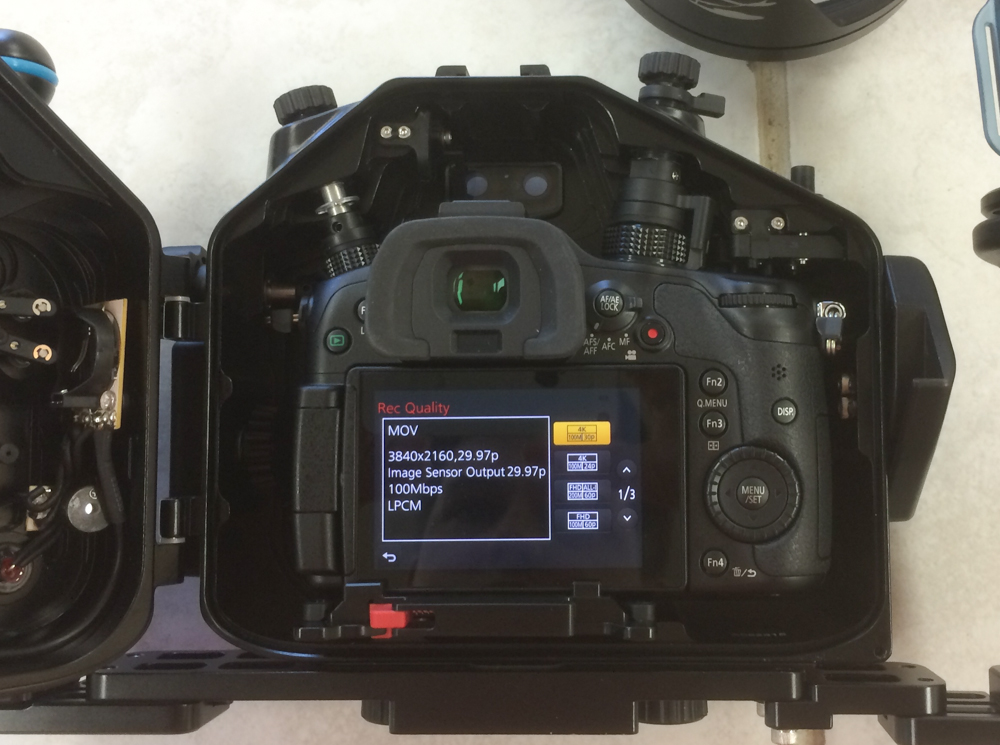

  10. One of these was out diving in Palm Beach this weekend too! Hopefully some images will be available soon.
    Edited by Ryan
  11. Ryan, was that retro fitted with any official upgrade kit???? - was that altered by hand for it to fit??
    Edited by thetrickster
  12. He was Edward Lai with a fake beard and a GH4 housing :lol2:
  13. This housing was unmodifiied. I expect something to take care of the mode dial lock interference will be released at some point, but we are busy diving the camera now as is.
