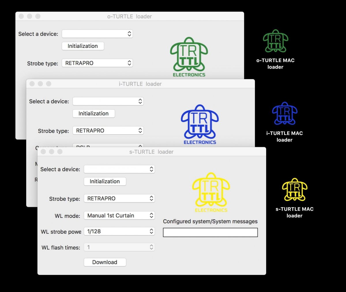

  8. Dear All,
    I would like to inform you about the TRT-electronics and Retra Pro TTL characteristic.
    We updated the i-TURTLE, s-TURTLE, o-TURTLE software on the website to use the Retra Pro in TTL mode.
    We are working on the HSS possibility and the new orders will contain this function in manual mode.
    Best
    Balazs
