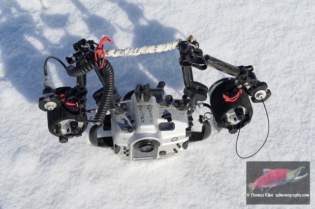

  5. I would like to report some success with the new Pro. However, there were two more failures requiring re-termination of the fiber optic. I did two outings. First, looking at nearby freshwater sites but all were quite frozen where it was deep enough to shoot so I was forced over to the harbor that has floating docks and stuff growing on them. So went into a polecam operation. In the topside pic you can see the tide was a few meters lower than high tide (where the snow ends). I made a shear guess: shot both strobes at 1/4 power at ISO100 at f/11. The histogram was well-centered so just did this one site. I am showing both the full frame and a blow-up so it is possible to see that there were mussels in the shot! Used the RS28mm lens.
    Have you tried with multi-core fiber optic?
    From your ealier pictures, it seems that you are using mono-core fiber, which are typically more brittle than multi-core fibers, and therefore break very easily.
    Good question!!!  It is the fiber optic cable that came with the strobe.
    Oskar told me: "The optical cable we are using at the moment is a multi core 613 type which has an official bending radius of 1mm."
    The more recent failures were not due to obvious cable breakage but much less light came out the failure end compared to the other strobe after attempting repair after the fiber optic came out of the adapter while it was in the bathtub when I rinsed the setup after my shoot. One troubleshooting step is to unplug the fiber optic cables from the strobes and look at the ends while firing the camera. I have ordered some Tos Link cable (suggested by another Wetpixel thread) as the original cable is getting short.

  14. A quick update.
    I got a pair of ULCS handlebar clamps to hold the fiber optic adapter close to the strobe. I got some Toslink cable. Toslink is a tad stiffer than the stock fiber optic. I tried one more time to fix the original fiber optic and failed again. Then I cut a short section of Toslink and on the first try it worked. I suspect the issue was with the fiber optic.
    The spot were I took the photos got no sun just a couple of weeks ago. You will note the one with a shorter fiber optic is on the left, which is the Toslink.
