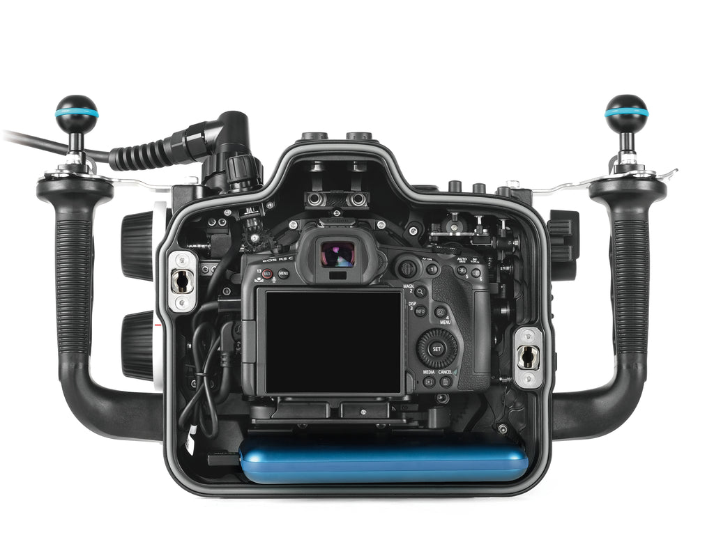

Even now for a consumer monster like the Canon R5C, the housing comes with a built-in slot. The camera only films 8K with the external battery and even in 4K, depending on the codec used, the internal battery only lasts 15 minutes.
In your case you could find a DIY solution using the monitor's M16 port and an external waterproof case. But the whole thing becomes more cumbersome.

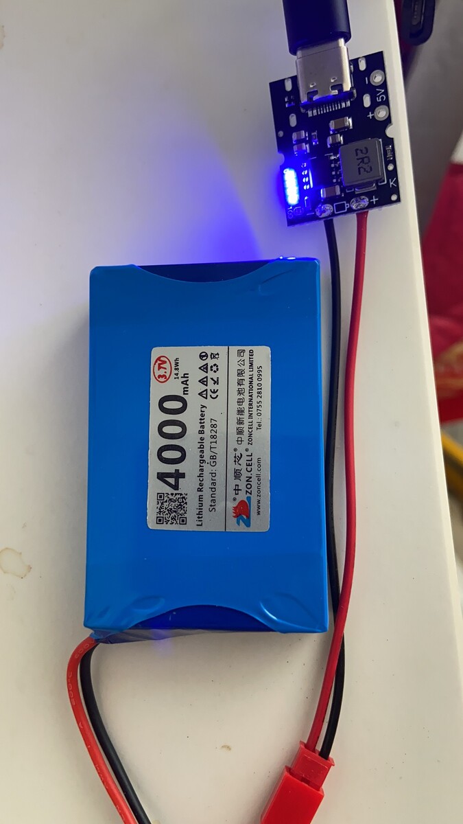

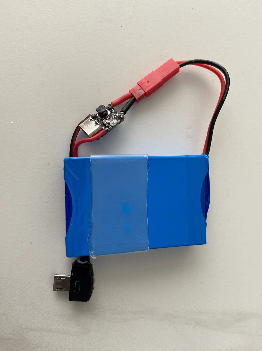

If your housing has a space reserved for flash trigger. It can be used to install a lithium polymer battery. It's a rudimentary method, but it works and will last for a day's diving. No need to open the housing.
battery are cheap and can be recharged over and over again .

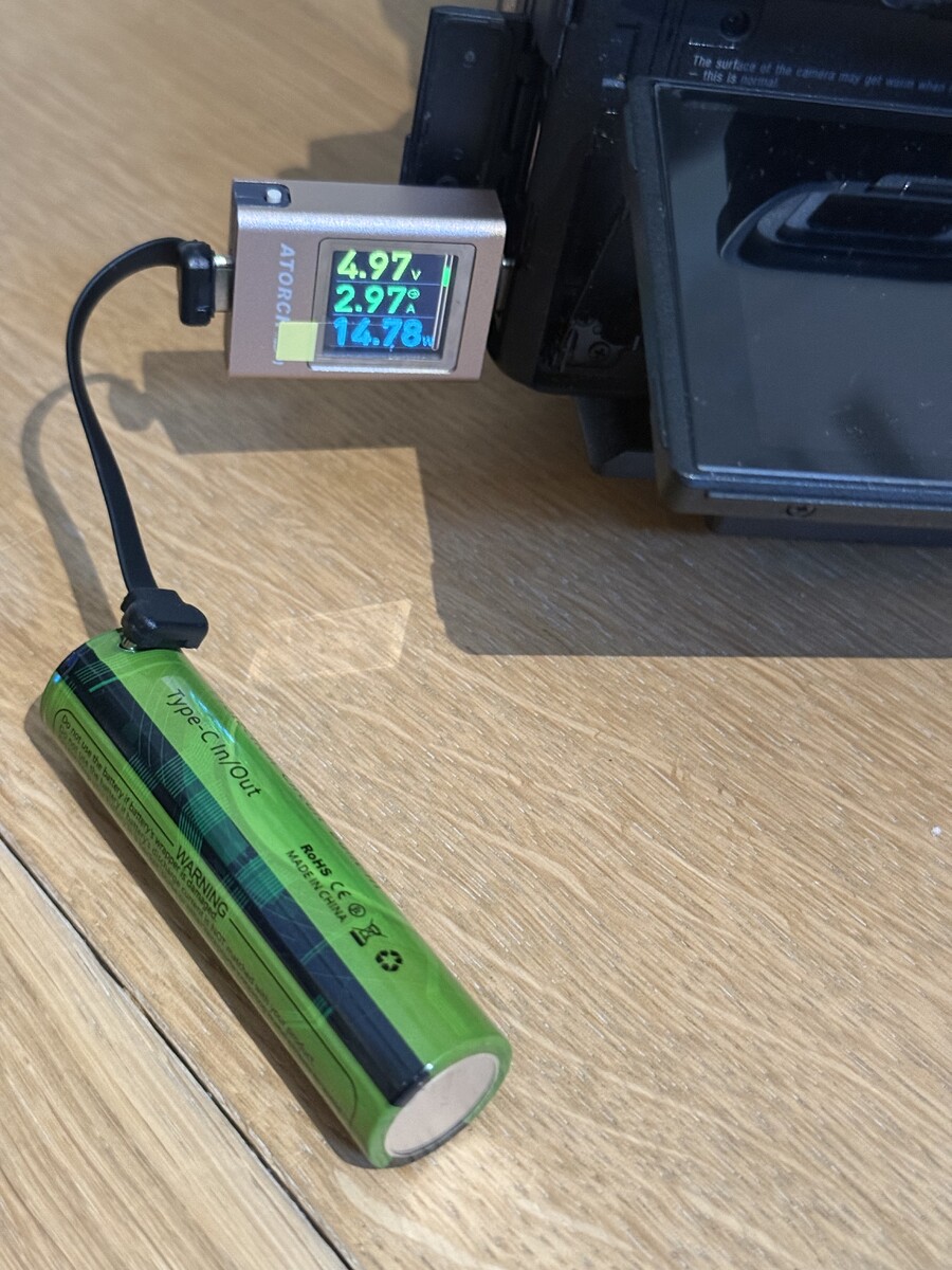

For the Sony, I bought a GoPro 3 housing many many years ago that had an external battery holder for 1x 18650 battery (at the time it was like over $500, and it came with a custom aluminum gopro case that I didn't even need). Anyways, I cut the wire on the battery holder and then soldered a USB cable to the other side. Before connecting the wires I ran it through a Nauticam Socket Extension and then I just made sure my wires were split up pretty good and fully inside the socket extension and epoxied it inside. This worked amazing for about 6 years, and then I started getting an insanely small vacuum leak (only on land, stayed sealed when testing with some toilet paper in the housing and the housing in a 5 gallon bucket of water). I never got a drop of water on the toilet paper, but I ended up just using a Dremel to remove about 2cm of epoxy and re-epoxied it and hasn't been a problem since.
It's a super simple cable that could have any tip (Micro USB, USB-C, etc), and because it's magnetic it makes it super easy to install in the housing (there's a million on Amazon, here's an example), mine has a little light that comes on so you know it's connected. The battery has an on / off switch which can be annoying but it's been so nice. You get an entire day without having to open the housing and swap batteries.
Here's some pics of that...
Edited by insomniac

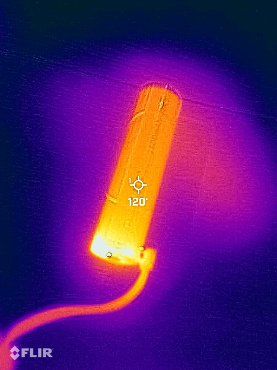

I just finished up the 18500 battery pack, it fits amazingly well and has an insane 9600mAh of power (enough to last 8+ hours)... I made this one with a slightly fancier board, that shows how much battery is left (and when charging how full the battery is).
Edited by insomniac
I also just confirmed I can build a 2x 18500 battery pack to likely fit in most full frame camera housings (I have a Sony A1). It would add 4800mAh of battery life (enough to get you through a full day considering the full frame batteries (for Sony, and likely others) are already pretty descent). That said, I use a flash trigger in my housing, so they are too big to fit with that. But I am now curious to see if I can come up with a solution that will work with my camera (down the rabbit hole I go).
