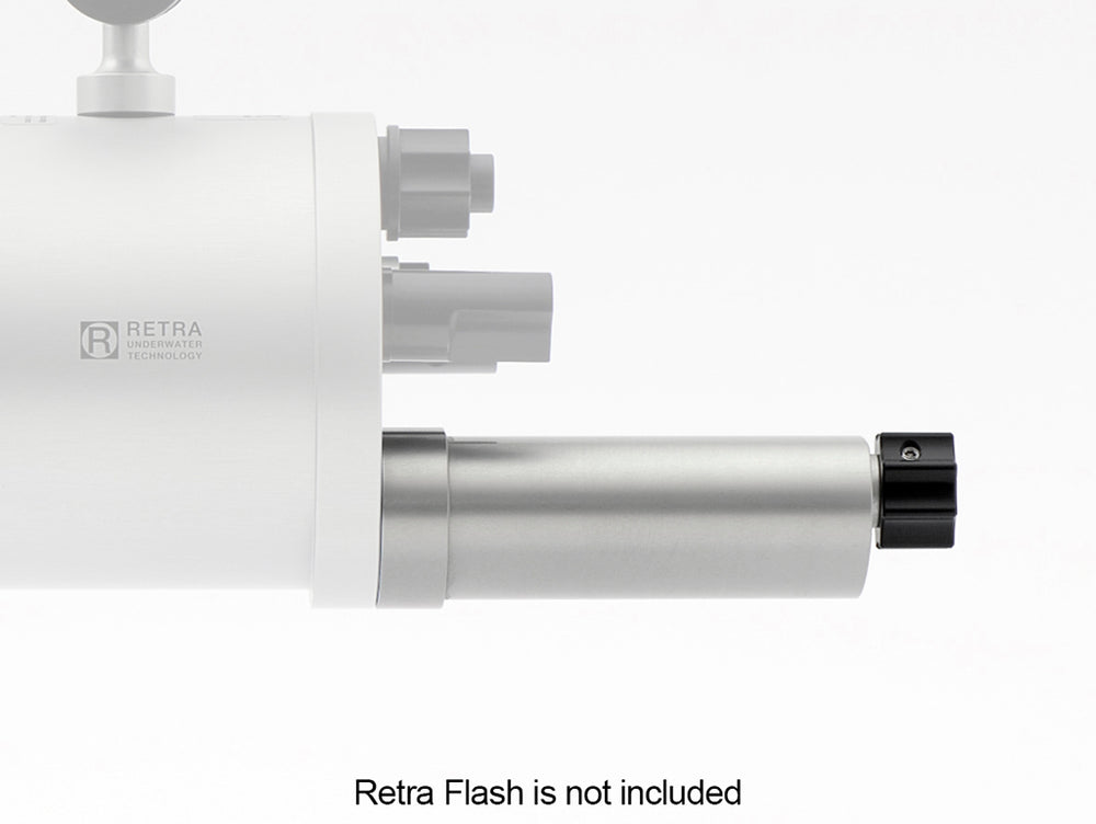

The detail for the new battery pack was just posted.  So far from what I read it looks like it is a big improvement over the 8 AA batteries and the lifetime exchange really adds to my probable need for the new toy.  Also since most of my other electronics are based on USB connections this will limit the number of batteries that I will need to take along on trips and free up some space in my bags.  Looking forward to see what others think.
A little bit more than 800$ for a pair (50$ saving for each if you order before 8th of July).
This is not cheap, but if you compare with the price of empty 4 to 8 AA booster...
It's double the battery life, so you can probably dive 1 day with only 2 packs instead of 32 AA...
But recycle time is only 10% better. Expect more for a Li-Ion strobe....
And I love (or not...) the sentence "NOTE: The USB-C charging cable is not included with the Retra Power Vault."

That is outrageously expensive for what are already very high-priced strobes. I guess that know their market.
$ per Wh is the same or currently even better when compared with the AA configuration:
- 8xAA + Booster + chargers have around 20-22Wh and cost about $250 or $11-12 per Wh.
- Battery pack has 40Wh and is currently $400 which is $10 per Wh.
Potato patato... I choose the battery pack any day of the week for the practical charging, consistent performance and no more chasing loose cells on the floor and underneath furniture!
Recycle time with these strobes on 8xAA is already not an issue and honestly I don't feel like deep frying the pupils of any marine life with my strobes, no thanks.

This is perhaps my personal preference but the new Booster design is way too short... I couldn't use it as a handle to manoeuvre the strobes the same way as I could the first generation Booster which was about twice the length. The added length is a welcome addition, in my opinion. And looking at the spec sheet it looks the buoyancy is substantially improved as well. With the battery pack the strobe is now practically neutral without adding dry weight.
It's the same length as the Backscatter Mini Flash, here is a clip from the hands-on video:

Quote
The Retra Power Vault takes approximately 3 hours to charge to 80% when using fast chargers. This translates to about 140 full power shots for every 30 minutes of charging.
--> 3 hours --> 6 x 140 = 840 full power shots
100% charge --> 1050 shots

Just examined the battery packs on offer at Backscatter's website:
Ikelite battery pack: proprietary batteries with proprietary charger 21.6Wh at $250 or $11.6 per Wh
Keldan battery pack: proprietary batteries with proprietary charger 49Wh at $430 or $8.8 per Wh
OneUW battery pack : proprietary batteries with proprietary charger 14.6Wh at $185 or $12.7 per Wh
Seacam battery pack: proprietary batteries with proprietary charger 14.7Wh at $381 or $25.9 per Wh
Retra battery pack: proprietary batteries with integrated USB-C charging 40Wh at $399 or $10 per Wh (when pre-order sale finishes $11.2 per Wh)
Honestly, I don't understand the complaints about the pricing. It aligns with what other manufacturers charge for their proprietary battery packs.
However, there is a significant difference, in my opinion: Retra is the only company offering their pack with a standard USB-C charging port. Additionally, the strobe can still use 4xAA or 8xAA batteries if an airline bans lithium batteries for any reason.
