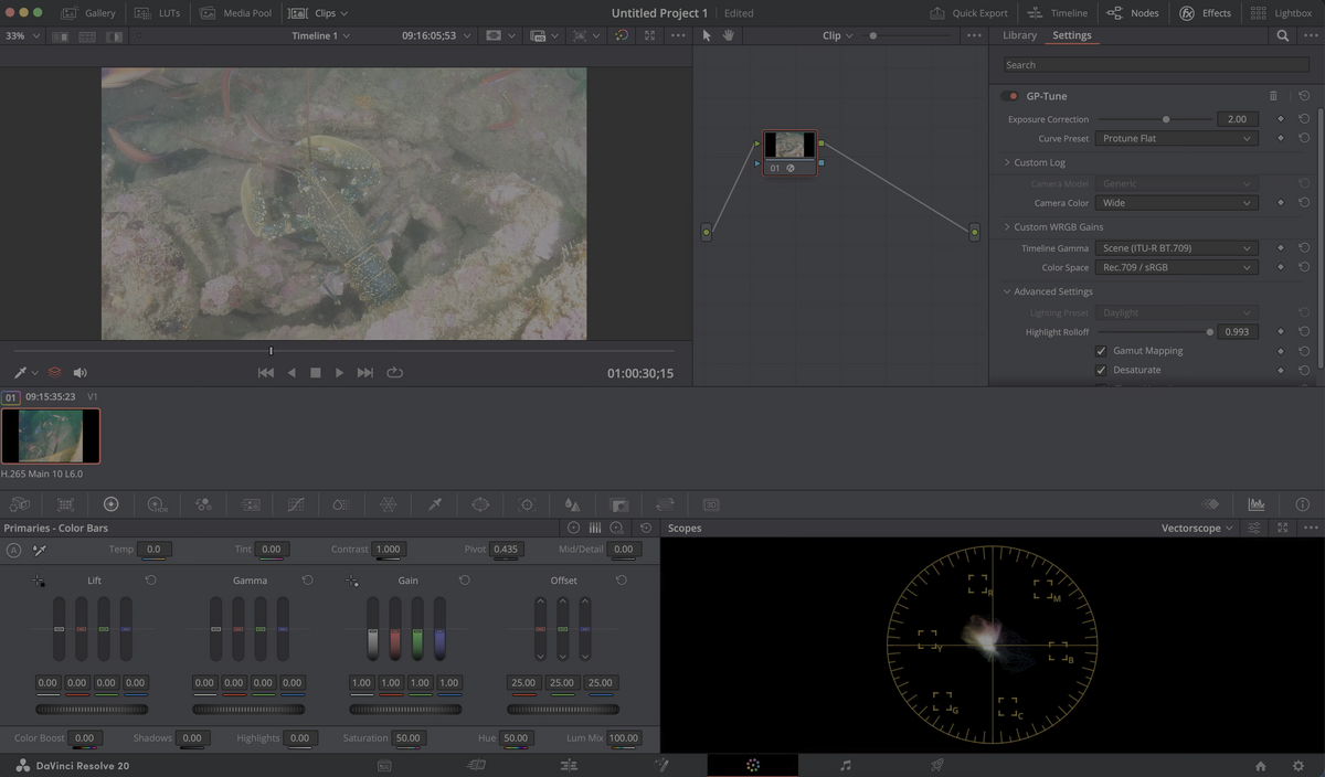

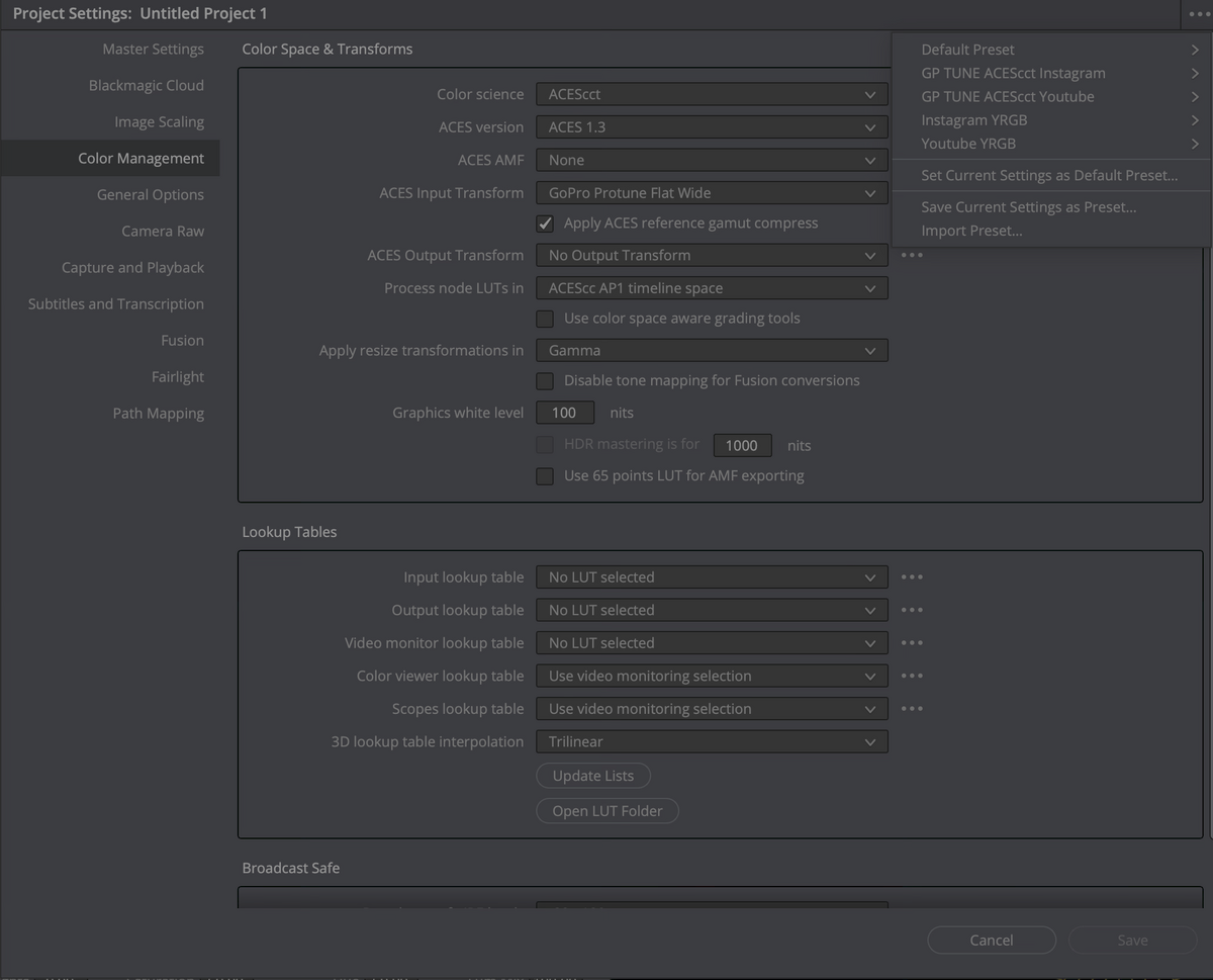

I always use Davinci YRGB..its much simpler to use... but the configurations are flexible depending what you want output or the project requirements
  • In Non-Color Managed YRGB: You apply the plugin to normalize footage to Rec 709 manually.
  • In YRGB Color Managed: To use the plugin, you must set the clip's Input Color Space to "Same as Timeline" and set the project's input DRT to "None" to avoid double-management, as explained in the GP-Tune Tutorial.
Ok @Nando Diver , thank you.
One more question: I use GP-TUNE as IDT, I correct WB and contrast if necessary. I didnt understand if the last node should be a CST to get rec.709 before delivery.
Whats your opinion for better results?
Bye
  • Author
With GP-tune transform im having mix results, and since im using the free davinci resolve im limited.
What i do is, i have saved presets, and quickly i can change from gp-tune to IDT

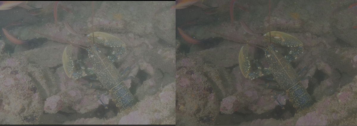

  • Author
With gp-transform (right image) there much less saturation in color.
But the flexibility of GP-tune plugin, i can correct the exposure without making a mess.
Edited by Nando Diver

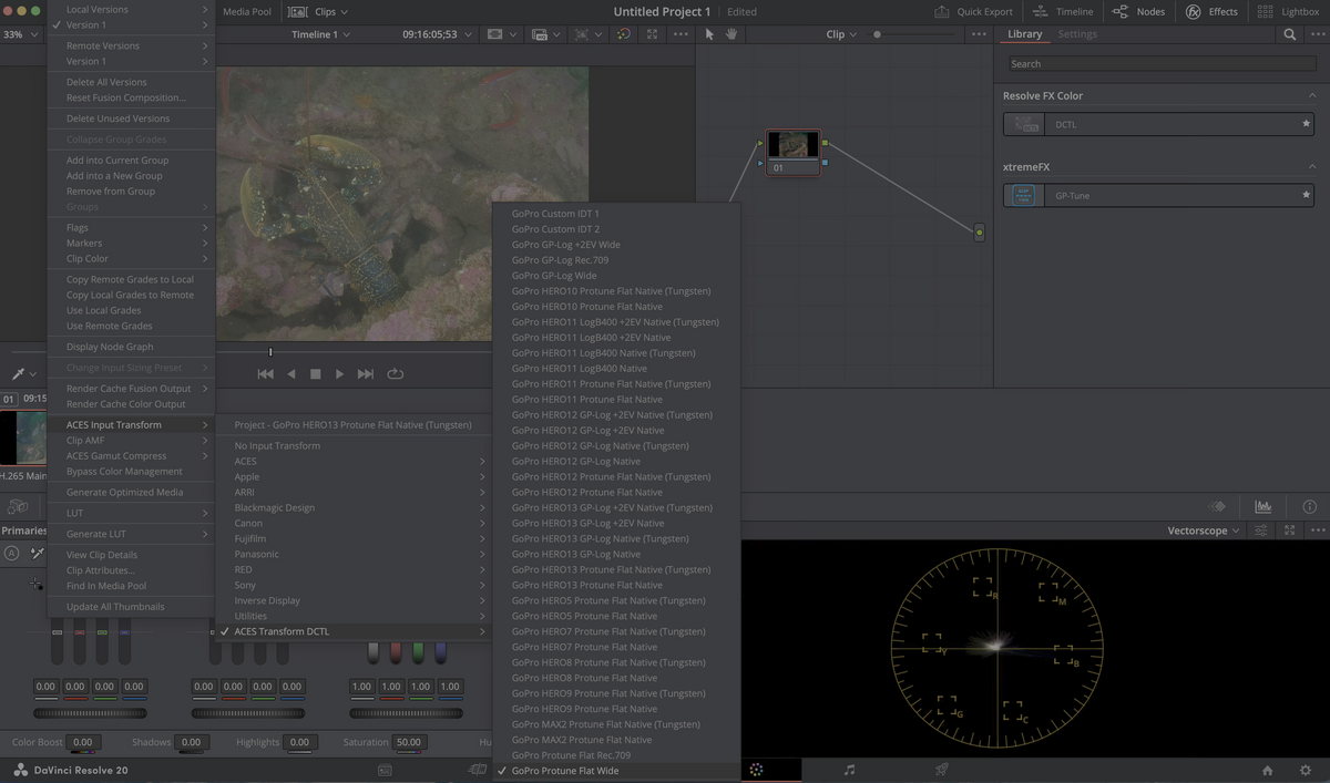

Recently i bought used ipad mini (A17) + Apple pencil... i want something more portable than a computer to take with me on liveaboard/Hollidays and do small color grade tasks..
Test it for couple days with davinci resolve free version....Aces transform ( GP-Tune transform) but the colors/algorithm numbers dont seem good enough for GP-LOG2 use... The xtremesuff developer told me to use DCTL i need the studio version for the iPad..
Decide to give it a go on davinci studio for ipad, and im able to use DCTL and full version of GP-TUNE transform, the diference is night and day... but the ipad version has some limitations that for my use case is not big deal.
Did side by side color grade Ipad 8,3" vs Macbook pro 16" and they match, but sometimes is painful and frustrating to use the ipad to color grade, since theres a small learning curves, like cut full audio from the clip..... the job can be done, but for extreme details i will keep the computer.

Yes you need gt-tune transform for ACES + free davinci version, grading is not so flexible if you have diferent cameras and shot with different settings..
Yes you need gt-tune transform to use DCTL + studio version (for ipad or computer )
ps: davinci Studio for ipad and davinci studio for computer are not the same ....
