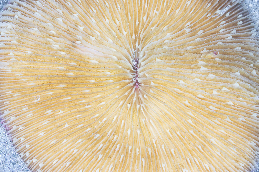

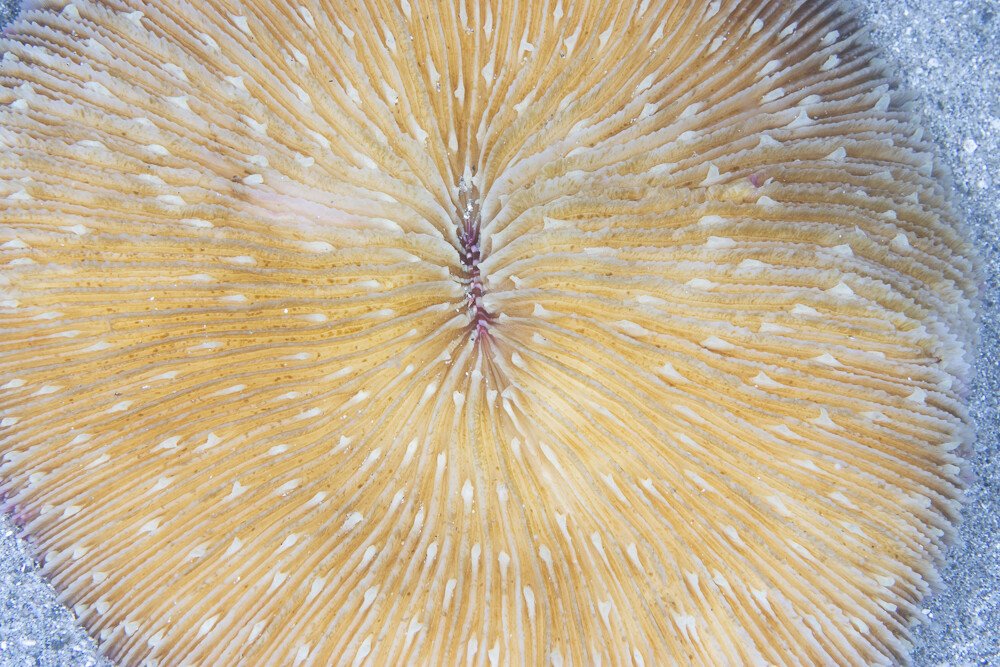

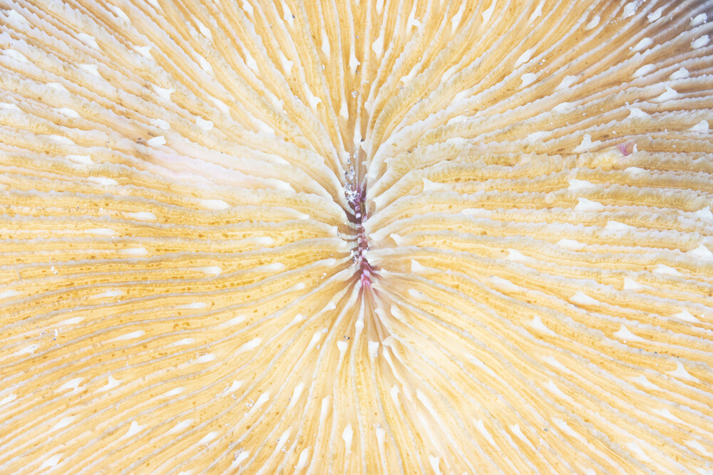

Since there is so little posted pictures taken with an MFO-1, I thought I would share my experience.
Here is the short story
Canon R7 with RF100mm,  1/250  f18 iso 320 on all shots.  All pictures unprocessed.
without MFO-1
with MFO similar distance
with MFO moved back to get similar size of subject compared to shot with no MFO-1
without MFO-1 100% crop
with MFO-1  100% crop
Now the long story. My main reason for buying the MFO-1 was to help focus hunting issues I was having when shooting fast moving fish like wrasses and in particular, flasher wrasse. I was very excited to find some flashers on my first dive with the MFO-1. I spent 30 minutes shooting them and did not see any noticeable improvement in focusing with the MFO-1. Many times I would preset a focus distance and when the flasher swam into focus, I would half depress the trigger and the camera would immediately go out of focus and hunt back and forth, just like it did without the MFO-1. I have had this problem ever since I got this camera a couple of years ago and even sent the camera back to Canon for repair but they did not find any issues.. The camera is awesome once it locks focus and works great on slow moving subjects. I was so disappointed I did not plan to use it again on my trip.
After a couple of days, I thought it would be interesting to test the enhanced image quality the MFO-1 is suppose to provide. This is where something interesting happened. I started the dive with the MFO-1 attached to my flat port. When I took it off to shoot without it, I was shocked to see lots of air bubbles escape! Was I shooting through air on my first dive with the MFO-1? I did several shots with and without the MFO-1 to test image quality (picture above) then kept it on, excited to try shooting a wrasse without any air bubbles. No flashers but when shooting other wrasse, the same focus hunting problem occurred.
I am not sure if my camera is causing the problem.  I plan to send it back again to Canon again. So take my results with a grain of salt.  Anyone want to buy an MFO-1 that was used for only on two dives? And just to show you I do know how to use a camera, this shot below was taken from my first dive with the MFO-1, maybe through an air pocket?

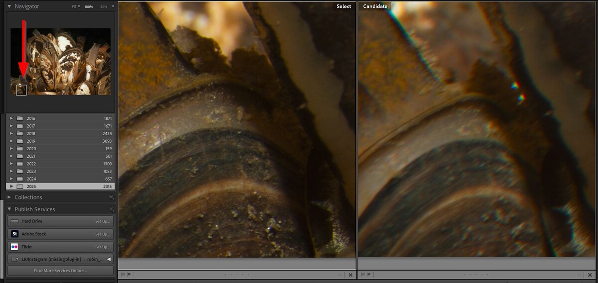

Here is a 100% crop at the corner.
no MFO-1
With the MFO-1
18 hours ago, Alex_Mustard said:
I think camera body makes a big difference to how well the Sony 90mm focuses.
Agreed, but A7RV as tested; also A7CR.
Maybe the MFO needs the A1!

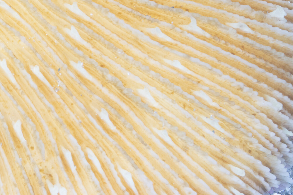

on my first dive with the mfo I took a picture with and without the mfo, just to try. Free floating in drysuit in a silty lake in the Netherlands, so a little shift in position. This shot is from a 105 macro (AF-S 105mm F/2.8G IF-ED VR) in the bottom corner on fullframe DSLR. No sharpening, removal of CA etc. F16 1/60 iso 100. In the centre the difference is still there, but less noticable. Left mfo, right no mfo
No doubt in this case that the MFO increase the quality
Thanks for this comparaison
I'd like to see center frames. It's where usually my subject is. From what I saw so far this WCoptics degrades an image quality a little compared to bare lens. Microcontrast and shapness... the pop.
I doubt the one testshot I made is very usefull for a fair comparisment. There is difference in composition, distance and perhaps exact point of focus. Anyway here is the centre shot, same settings, left MFO right no MFOwith without mfo centre.jpg

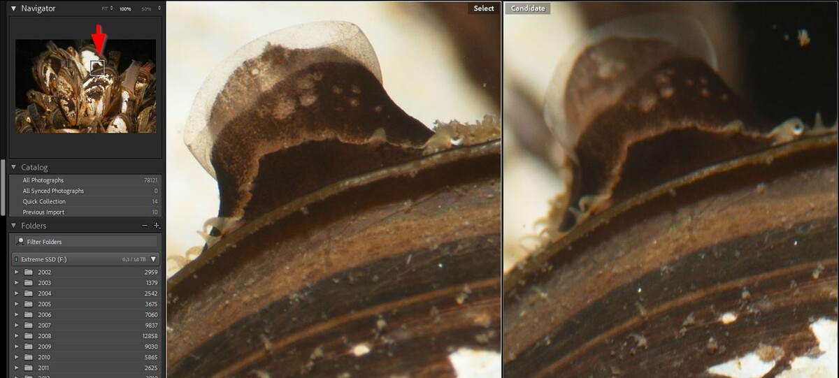

I think Robin D has the right idea. The 105VR lens is no slouch so one has to find its weaknesses especially those when used under water. For example see attachments. A 105VR shot done with a Nikon D800 so 36 Mpixels. One jpeg is of the whole frame. Looks decent at 1000 pixels for the web. Next shot is the upper right hand corner at 300%. I did a screen grab then converted to a jpeg to make the file size quite a bit smaller but still larger than the whole frame shot. The color fringing not evident in the whole frame image now is. One gets more of this (fringing) with out of focus high contrast edges. FYI, chromatic aberration correction was turned on (in Lightroom).
