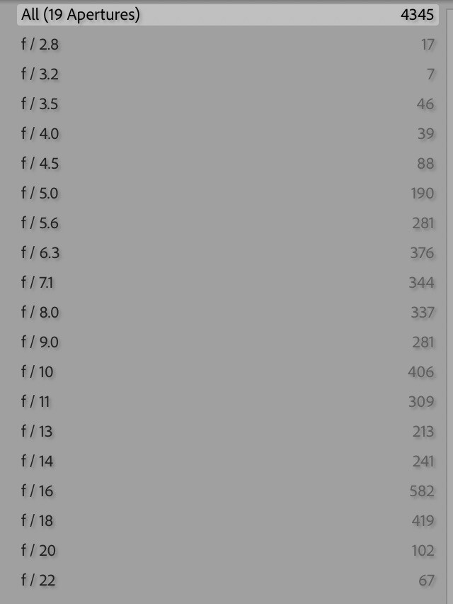

While I fully agree that smaller sensors give more depth of field, there seems to be a mistaken belief that the goal of macro photography underwater is all about maximising depth of field. Sometimes it is. But usually it isn't.
I shoot on full frame. And this same thinking would mean you would imagine that I always have my lens closed down to maximise depth of field. Instead you will see a very wide range of apertures used.
This, as an example, is the apertures I have selected for the 4300 macro shots that remain in my Lightroom (after culling) from my shoots over the last 12 months.
I share this to make the point to show the fallacy of the sweeping statement that saying that one camera system giving more depth of field makes it better for macro.
Point taken!
So, can we rephrase that a larger Depth of Field helps us, mere mortals, achieve decent focus? 😇
