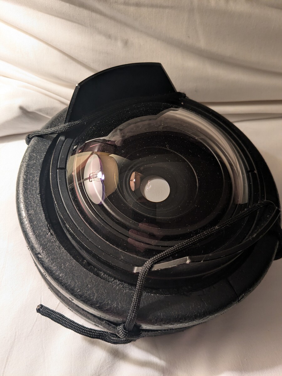

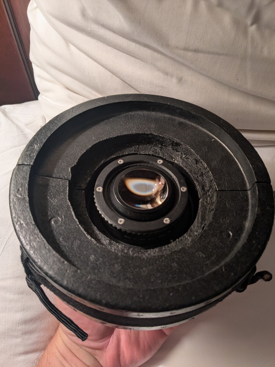

I adapted an AOI collar to my UWL100 using a hot knife. It's not perfect but works rather well.
Importantly it's perfectly neutral so if I remove it and put it on an arm it's not changing anything. That's what I was hoping to achieve.
UWL100, as in Inon? is so, would you have a picture of your DIY job? thanks!

Just heated a utility knife with a propane torch and cut until it fit. The bungees hold it in place and aren't visible with my housing. If you didn't intend to remove it the bungees wouldn't be necessary.
I found out the flat BTS collar would just float it but the cost works out to 2x as much as the Stix per unit if floating.
I do have some BTS floats to try on my arms but conditions aren't ideal at the moment. I might drop one in my friends pressure pot which goes to 10bar.
Wow - very nice, thank you. Is it the AOI FC1 float collar for UWL-09PRO & UWL-09?
That is correct. I don't think I'd need to take as much off if my port wasn't the wide Seafrogs. But it still only took perhaps an hour.
