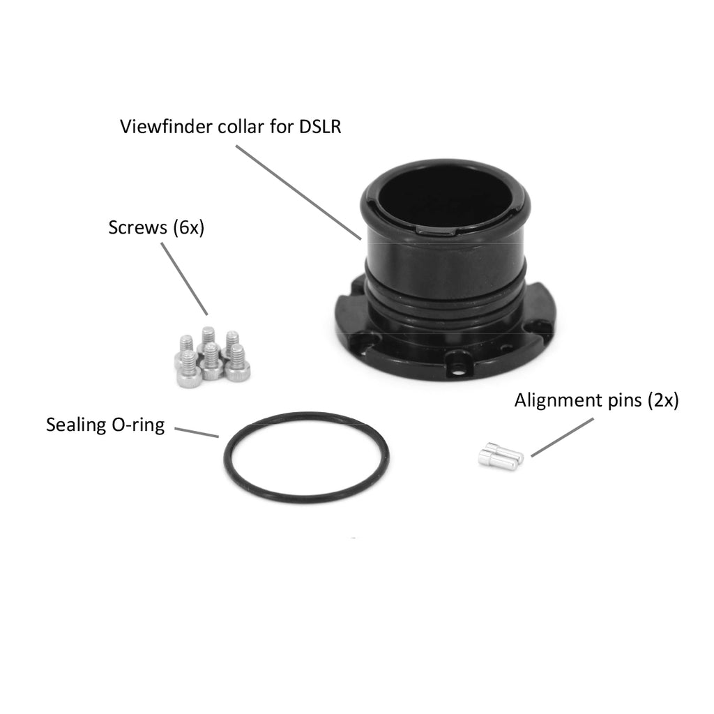

I have been using the attached 45 viewfinder with my Nauticam OM-1 housing and wanted to use the same viewfinder with a Z8 housing however it does not appear to fit well as it is 'too short'.
I have seen different collar adapters online but I am not sure which one I need as I dont know the exact model of my viewfinder, it could be a na-32205 or na-32203.
Does anyone know what collar adapter I need for it to work with a Nauticam Z8?

That one looks like the original 45° viewfinder, the difference between the two versions is the nosepiece that fits into the housing. This is the manual which shows the difference, one of which is the 32203 has alignment pins while the 32205 has a flat section cutout. Your looks ike a 32205:
https://www.nauticam.cn/upload/portal/20190124/201901241132017209.pdf
When you say it's too short what exactly do you mean? Does the nose go in the viewfinder hole far enough to fit the retaining o-ring? If not you need a different nosepiece. I believe this collar adapter is what you would need to turn your 32205 into a 32203:
No image preview
Viewfinder Collar Adaptor for 32204 (from A153408) and 32...
Allows for the 45/º viewfinders to be adapted from MIL to DSLR housings. Instruction Manual PDF Download
Again you would need to confirm this with Nauticam or a dealer. If someone can confirm they are using a 32203 on a Z8 housing this seems to be what you would need to adapt it.

Thank you. Yes I meant the collar is not long enough so cannot fit the retaining o-ring.
This clarifies and confirms I currently have a 32205 but I need a 32203 to fit my NA Z8 housing https://www.nauticam.cn/upload/portal/20190124/201901241132017209.pdf
My confusion came from the fact that the description for the 32203 says 'DSLR' which the Z8 is not so I assumed I needed a MIL collar adapter instead of a DSLR collar adapter.
It looks like the old 45 DSLR viewfinder just works on the Z8
https://waterpixels.net/forums/topic/3071-questions-about-45%C2%B0-viewfinder-na-32203/#findComment-20934
I will ask my Nauticam dealer anyway but I wanted to avoid the 'is not fully compatible' response as I understand this can be resolved by reducing the viewfinder size on the Z8 to small which has appeared in multiple posts already.

So you could see if you buy the viewfinder collar adapter to attach to your viewfinder this converts a 33205 into a 33203. Link is provided above. It's Nauticam 90156.
