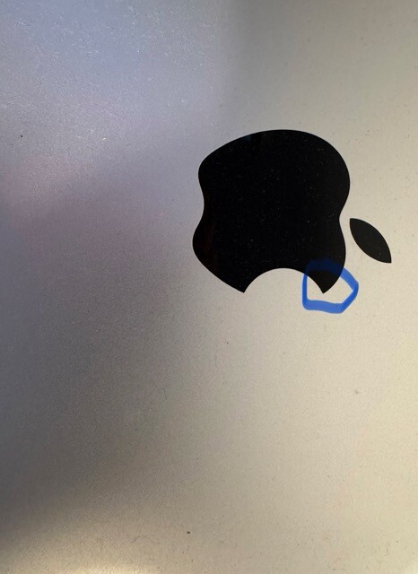

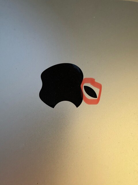

Hi Davide, many thanks for your interest!
Yes it's only with stills. Before a few weeks I posted about it, using cont. autofocus without AI object detection doesn't work precise enough for macro work, on land or underwater makes no difference. And its also not about too less focus light or bad autofocus conditions. I try to explain, please excuse my English but I'm no native speaker :-) :
Please see picture one, this is my motive, setting the focus point (small) to the red mark, which I want to focus on, second picture is where my focus ends up in blue, when I move my camera while focusing. The pictures are only for illustrating what I mean. In reality the output is, that for example the eyes are not sharp. This happens not with A1, A1 II, A7V, but with A9 III it's the same problem. I already talk with Sony about it, they had the explanation that the sensor of the A7R5 is too slow, hmmmm, but that can't be the case for the A9III, we tried it in a shop together with a Sony guy and with different cameras, Canon R5 was the best result :-( .
Would be really interested how your thoughts are! I have the A7R5 from beginning on and I think at the beginning this was not the case, it worked much better and I had better results.

it happens in different cases, one is when I move the camera a little bit to have the subject more left or right for example. The other case is, when the subject is moving and I try to follow. This is also on land with the camera fixed on a table and moving the object a little bit.
My main issue is that the AI tracks and then decides its not the subject.
Like stationary(some movement but you know) nudi, initial focus on rhinopore and its stays there 5-10 seconds, then the AI just suddenly decides its not where to focus and goes to the gills, body or sand. Insect, Animal, eye/head/body doesnt matter. Ok nudibranch isnt the most common subject that the AI has learned im sure.
Also tried little bit with tripod, to minimize camera movement, and set focus on point x and thought its good, but camera actually focuses on point z that was just outside/edge of the box.
This happens without the AI subject recognition also.
