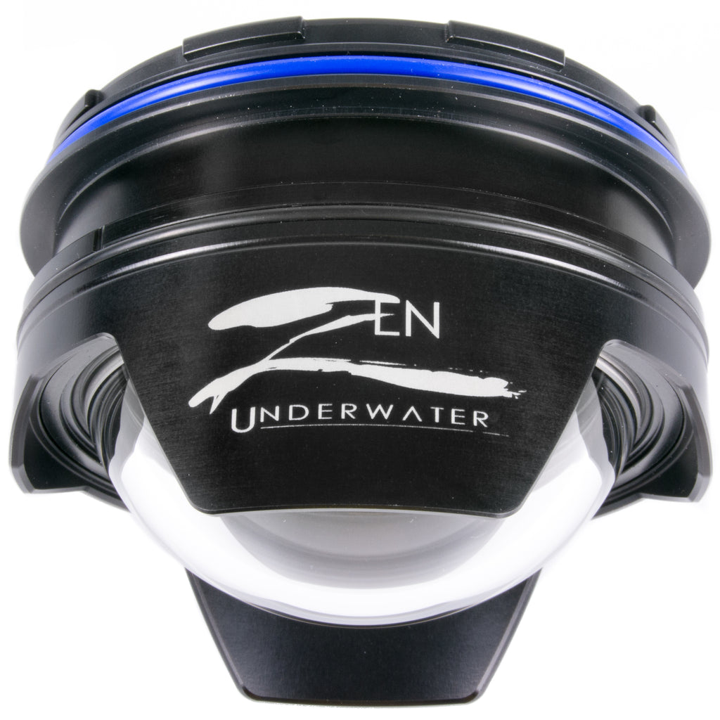

Hi all thx again for responses. I am now a proud owner if a second hand Canon 8-15 and a Metabones Mkv adapter. I know v little about using teleconverters. Are they needed? I have the 100 to 120 Nauticam adapter but now need to know what port to put this all under? I have a Zen glass port from my old Sony system and a Nauticam acrylic dome for Sony A7rv. Do I need a Canon 120 port. Looked at port chart not very clear. Any help I would be v grateful

Hi @Terri - congrats on your new Canon 8-15 and Metabones V. This will work perfectly with your Sony a7rV. I own an a1 in a Nauticam housing with this exact lens / adapter combo.
Which specific Zen dome do you have? It does make a difference. The Zen 100 is not the best choice for a high res FF body due to the ultra small dome size. There is also a version made specifically for the Tokina 10-17 which is different than the one made for the Canon 8-15, again neither are recommended for the high res systems.
The N100-N120 adapter with the zoom knob and Nauticam c815-z gear is how you will zoom the lens. Add an N120 30mm Extension for the 8-15 and Metabones for proper mounting. If you later add a 1.4x TC an additional N120 20mm is needed either as a 20mm added to the 30mm or using a separate 50mm Extension.
I use the Nauticam 140 dome port with my Canon 8-15. It is a full hemispherical dome which is what is best for the fisheye lenses and the smallest size that will provide good corners for high res FF systems. Teleconverters also work with this dome whereas they cause a horrible "smearing" in the corners when attempting to use it with the Zen 100 designed for the 8-15.
As others have said you need to know which DP100 port you have - it should be labelled, they have different amounts of extension built in, the one designed specifically for the Canon 8-15 is the DP-100-N120CR, this is used with no extension when added to the N100-N120 Nauticam adapter. this is the N120CR dome, you can see the built in extension: Assuming of course you are referring to a DP100 dome, we need to know which one to recommend the right extension.
No image preview
Zen DP-100-N120CR 4 Inch Glass Dome Port for Canon 8-15...
Zen DP-100-N120CR 4in Glass Dome Port for Canon 8-15 /4L, Nauticam Housings, Removable Shade So you think you need a huge dome port to take advantage of your fisheye lens? Think again! Canon 8-15 /4L
If you have a different model Zen DP 100 you will need to work out the extension required.
If you have the 8.5" acrylic dome port it uses the 30mm extension on top of the N100-N120 adapter. it won't be as good for CFWA as the large dome pushes you further back from your subject.
Another option other members have been happy with is the Howshot 140mm, about half the price of Nauticam.
