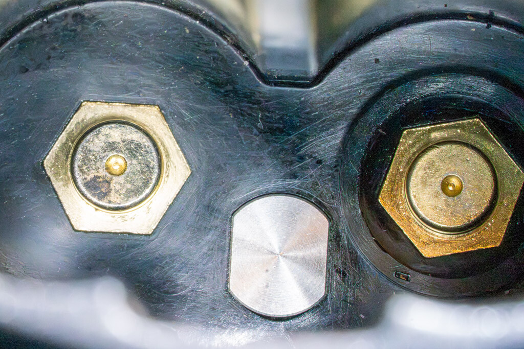

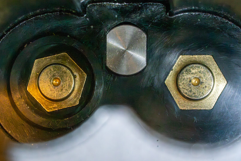

I am not clear here. Did Backscatter state the specific reason the strobes quit working was "stained" contacts and that there is no other malfunction involved?
I was in contact with the service department before sending in the strobes and have send photos of the contacts (after cleaning with a Dremel tool and with alcohol). I was told the reason are the contacts, some "stain" from corrosion (there were still remains of this stain to see on the photos). According to Backscatter, this can happen even without direct contact with water (and there has never been a contact with water)...
At present the strobes are at Backscatter for repair and they will tell me the details after the repair. I will report here then...

The contact marked as "Corosion..." is exactly how my contacts looked (but the corrosion was much less intense in my case).
Here the photos of the contacts after cleaning, rests of the stain can still be seen (unfortunately I did not make photos before). One strobe was working after cleaning (upper photo), the other not (lower). Backscatter said better send in both since the problem will reappear soon...
