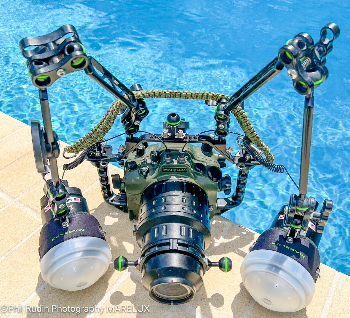

I now use Marelux macro port 71 for the Tamron 90 macro with 20mm extension, Sigma 105 macro with port 71 and 30mm extension, Sony 70-200 F/4 macro from 100 to 200 with port 71 and 100mm of extension and the new Sony 100mm should work with port 71 and 45mm of extension a 30mm and 15mm. The Sony 90mm would also work with the port 71 but needs a 25mm extension which Marelux does not now offer. For travel being able to carry two or three macro lenses with only one macro port and extensions I would already be carrying for other lenses is a big upside.
The photo is the macro port 97 (the Sony 90mm port) using 75mm's of extension with the 70-200mm macro which is 1mm longer than the 71 port combo.

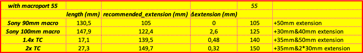

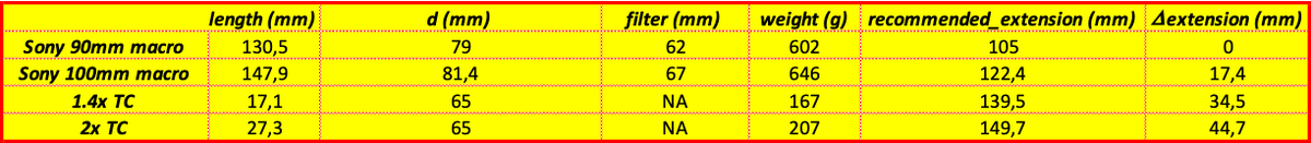

I have considered the physical dimensions of the lenses and TCs and figured out how to house them within the Nauticam N100 system:
First the physical dimensions of lenses and TCs, together with the extensions recommended by Nauticam (recommended extensions for Sony 100mm combinations calculated from physical length difference to the 90mm lens):
Secondly, the N100 flatports and N100 extensions that are, at present, available (before using a specific flatport, I would better ask at Nauticam whether the inner diameter of the port and possible obstacles (e.g. focus knob) are compatible with the assembly (I am sure they have the lens and all items and can test out)):
=> Already at the current state it should be feasible to house the new Sony 100mm macro using the 105mm flatport with the 30mm extension (as Romi writes), but, as Phil writes, there will be a gap of 12,6mm between front of the lens and the glass of the port, what may be unpleasant, especially when wetlenses as e.g. SMC-1 are to be used (also less than perfectly cleaned portglass will lower IQ the more, the larger is the gap). The 105mm flatport, however, will work together almost perfect with the 1.4xTC using a 35mm extension and probably, quite reasonable, with the 2x TC using the 50mm extension (a gap of 5,3mm will be present).
A huge number of combinations of flatports and extensions is possible, here, as one example, the housing using the N100 macroport55:
=> Both lenses and Sony 100mm with both teleconverters fit perfect. Exception is the pure Sony 100mm macro lens, but the gap of 2,6mm should also be o.k (normally extensions are fabricated at 5mm intervalls and the next, best fitting, extension is chosen (maybe even the 30mm & 35mm extension would fit perfectly (2,4mm too short in theory), but this has to be tested out by someone who has these extensions at hand))). ...
Edited by Architeuthis

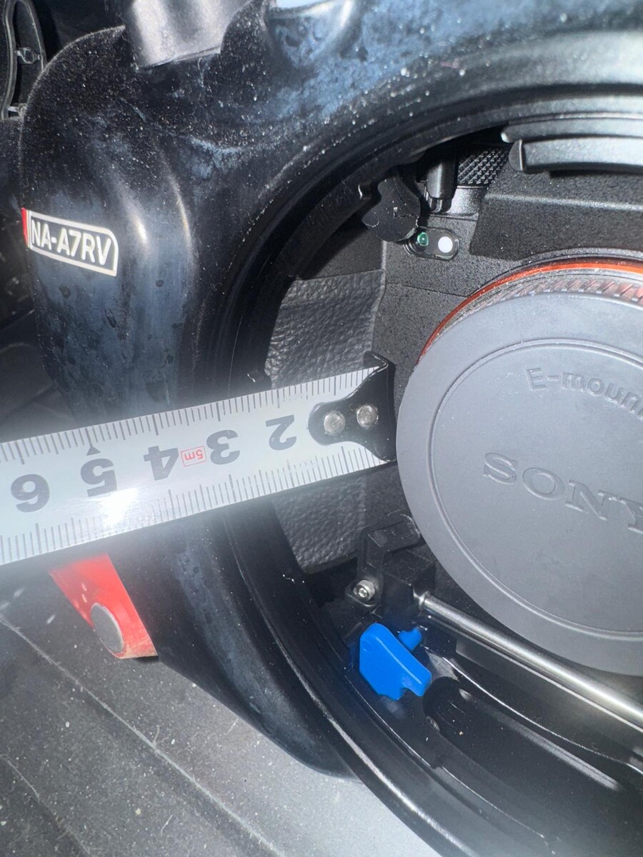

But also the camera body doesnt sit right on port opening, its some 30mm inside the housing.
Sorry bad picture.
Edited by Sokrates

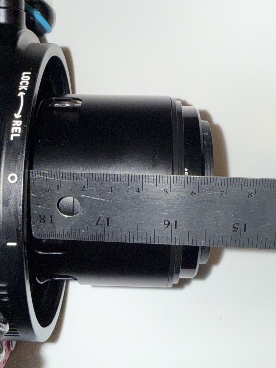

Here's a look (i know it's not the best) at the A1 housing with the current Sony 90mm mounted to the camera with the N100 to N120 (NA-37305) adapter installed. Appears to be about 66mm from the edge of the adapter. I would appreciate a solution that used this adapter; as it would make switching from shooting macro to my FCP-1 slightly less burdensome. If things fit together as I would expect; it would be 66mm(ish)+17.4 = 83.4mm (within 3.7mm of the Macro Port 87 which seems reasonable to me - but I could be wrong).
UPDATE: I've also measured this with the dumb ruler about 10x and the measurement I get varies anywhere from 66-70mm (ish). I think it's closer to 70mm than 66mm (as pictured).

According to Sony, the diameter is 81mm (https://www.dpreview.com/news/7072539149/sony-100mm-f2p8-macro-gm-lens-annoncement ). Diameter of the 90mm macro is 89mm (https://www.dpreview.com/products/sony/lenses/sony_fe_90_2p8_macro_g_oss/specifications )...
=> So no worry, it will fit in case these specs. are correct...
Wolfgang
I am really excited about this new lens. Very likely to become a legendary macro lens and an excellent argument to go with Sony FF UW...🫶
12 hours ago, hellhole said:
81.4mm (100) vs 79mm (90)
Right, thank you, 89 is a typo (cannot correct anymore) - diameter of the 90mm is 79mm...
