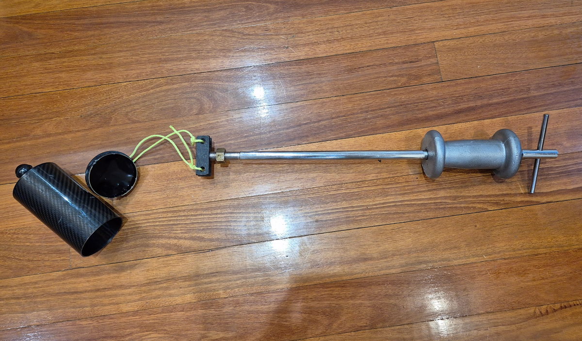

Prepping for a dive trip - checking my gear and realise by two big float arms are water logged.
As you should, you pull out the artillery and get them apart. Using my bearing puller and aluminium jaws in the vice, I've managed to pull one end off the float. The carbon tube is actually very solid.
Now the difficult part. I can clean up the open end and re-epoxy that. However, the end that's still left in the carbon tube - I can't think of a delicate way of getting that one out without making up some elaborate jig to hold the carbon tube as I try to pull the remaining end.

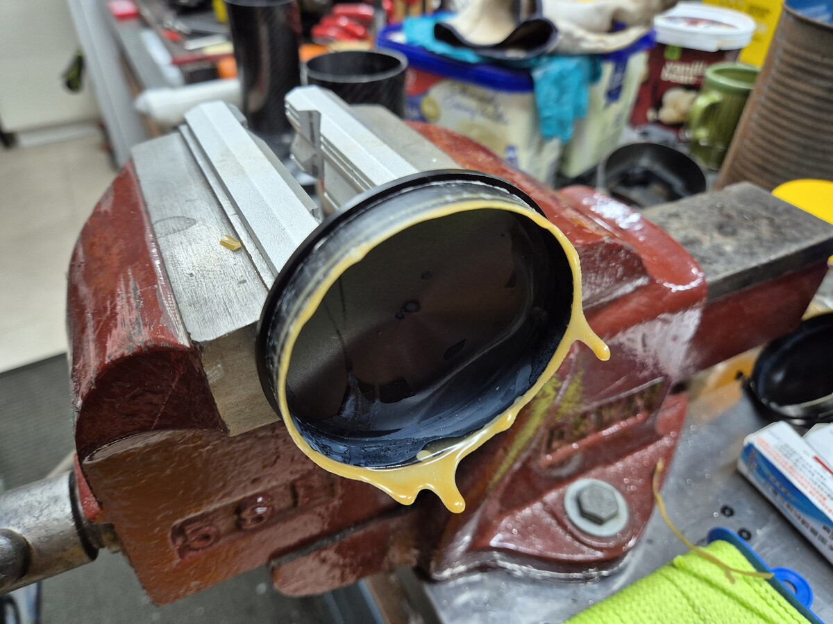

The heating method worked. I used a heat gun. I imagine the glue would weaken over time with heating in the sun too, so maybe there's a lesson here not to leave them exposed.

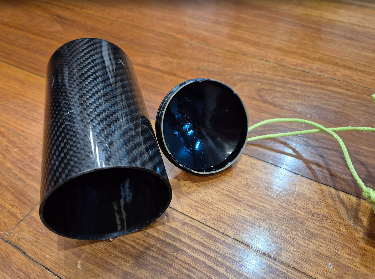

Meditating on this for the last hour, I think one of the structural weaknesses is with the key into the carbon tube.
The aluminium end cap actually has a groove for the adhesive to key into. But the carbon is just the smooth bore, perhaps roughed up a little.
The carbon tube is 2mm thick, so what im going to do is create a number of very small keyways in the inner bore of the carbon at the cap/glue interface. Maybe even a complete ring groove that aligns with the groove in the cap.

Update on this. Did 9 dives on the repaired floats. I ended up cleaning up all the old adhesive off both the aluminium ends and the inside of the carbon tube. I used a small dremel to create a shallow notch all the way around the inside of the carbon tube. This created a good key for the new epoxy. The aluminium already had key grooves.
I used this epoxy to put them back together. Available in Australia, but possibly elsewhere:
