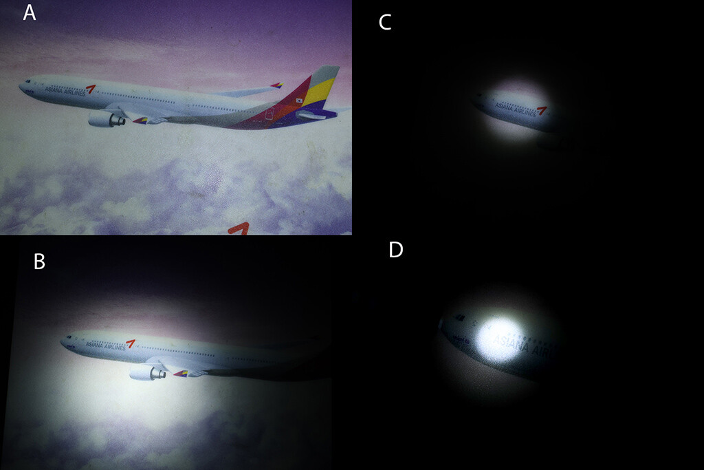

So far I can notice you have 2 problems : one is the black hole inside the light which I guess is the signature of the circular bulb, the other one is that you have a light "fall off" spilling outside of the snoot hole (the outer ring of subdued light around the main light).
For me, it's due to the absence of a condenser lens that would both diffuse the circular light into a flat light and make the light converge to a focus point this avoiding spill off. We (my guide and myself) usually take continuous torch lights when we do macro, that we use when I need precise lighting other than the main snoot light or when two snooted lights are needed.
All of these small torches are equiped first with a lens like this one https://www.uwcamerastore.com/weefine-optical-collector-with-m52-for-smart-focus-6000?gad_source=1&gad_campaignid=21961101493&gbraid=0AAAAAD6tS_h9daR4-OxoqiVVd9_zdO1Lf&gclid=CjwKCAjwr8LHBhBKEiwAy47uUpyg-mpCh6yNn1-WSBCsL9CNJP9mI_UhLEkk2WRtWjKc90Kuc_xbshoCXKoQAvD_BwE
then screwed onto the condenser a plain metallic black funnel to reduce the light spot. However it wouldn't work without the condenser, which is the most important piece.
Just to show you the difference, I snapped 4 images of my mousepad with a tirch light, the condenser and a funnel.
A= full mousepad image lit by the torchlight, B= condenser on, the beam is reduced and condensed, C= condenser and funnel on, exactly what you expect from a snoot, even though I was not aiming at the sweet spot distance, not much light loss, same distance as withe condenser only D= funnel but NO condenser, I had to put the light much closer because of the loss of light, light spills outside of the main focus point, you cannot clearly see it but when I put the light close there are distinctly patterns of the LED light inside the main focus point.

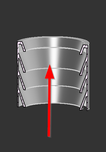

In the tube a try with good results this shape
important printed with a black mat filament to avoid a maximum of the reflexion and have a nice boundery beetween the black and white zone on the picture.
