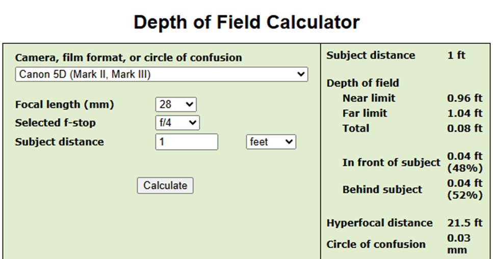

I’m looking for advice on close wide-angle photography at night. I’m photographing fish in a river which are very light sensitive so I cannot use a focus light but an occasional strobe is ok. I’ve found that I can use back button focus to first focus on an object at a set distance and then try to get the same distance away from the fish and take the image but that doesn’t always work because the total depth of field is very small. Since the fish are very light sensitive I can only take an image ~once a minute so if my distance to the fish is off a little and it’s out of focus then the fish might move and I might miss that opportunity. Are there any other options I should try?

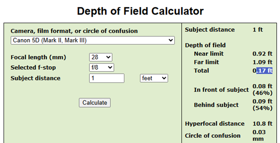

According to a DOF calculator, shooting a subject that’s 1ft away at F/4 gives me .96” (24mm) of total depth of field which is not a lot of wiggle room to get the distance to my subject correct. Shooting at F/8 gives me 2 inches (50.8mm) of total depth of field which is better but I’d have to crank my ISO way up and still isn’t a lot of wiggle room to get my focus correct. It seems I have no good option and my only real path forward is to decrease the aperture and crank my ISO up while keeping my shutter speed as low as possible but would love to hear how others do it.
