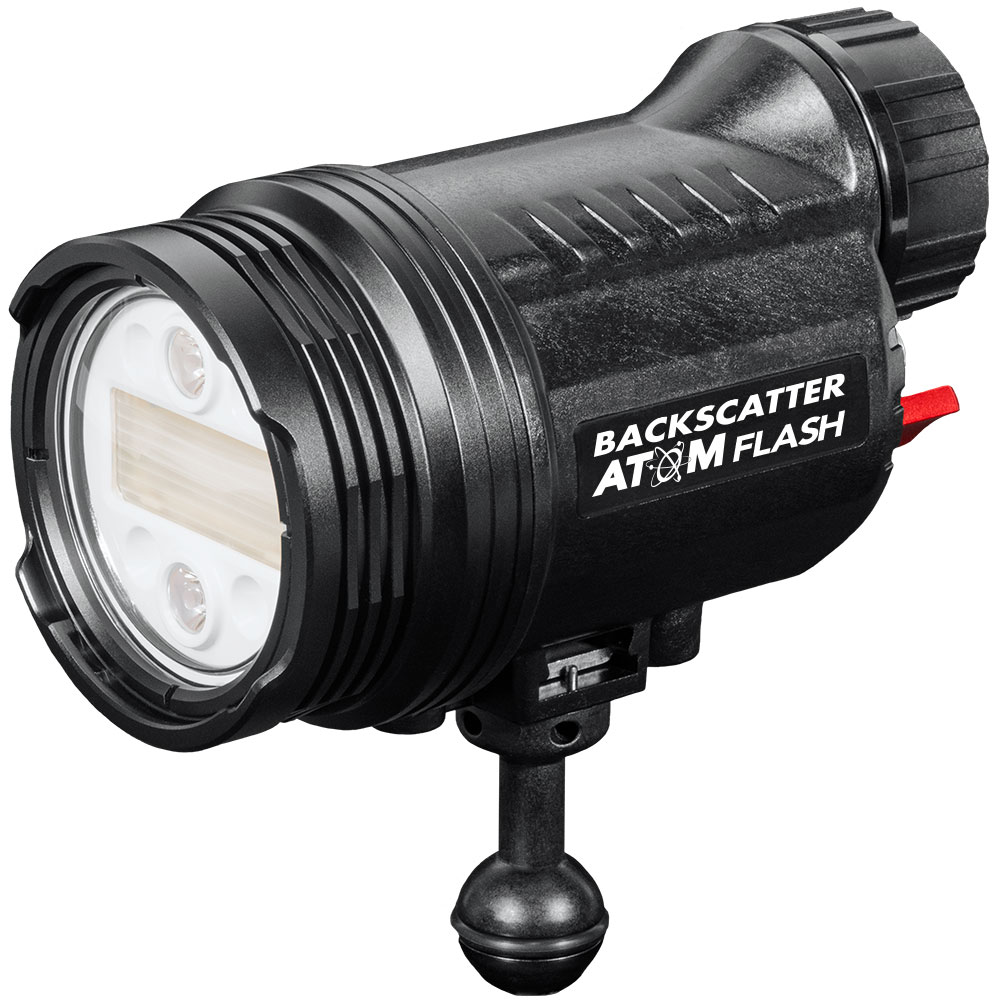

BACKSCATTER announced the Atom Flash:
bs-af-1_01.jpg?resizeid=6&resizeh=600&re
Backscatter.com
No image preview
Backscatter Atom Flash Underwater Strobe AF-1
Backscatter Atom Flash Underwater Strobe AF-1: With an underwater guide number of ƒ28, the Atom Flash packs serious flash power for its size, lighting everything from the biggest wide-angle scenes to

Well, okay, none of us are expert on this strobe. Per Backscatter it is smaller than the HF-1 considerably and has a UW GN28 which is equivalent to the HF-1 at max power until you set the +1 or +2 settings which I think are GN34 and GN40 respectively.
Per Backscatter and the strobe operator manuals, the Backscatter MF-1/2/3, Atom and HF-1 will only shoot TTL with the Backscatter trigger. If this is not true, explain how this is not the case because I might like to purchase a set but I want to run off my UWT board or the pop up strobe for TTL. Manual of course is no issue with the UWT trigger or the pop up flash but TTL?
