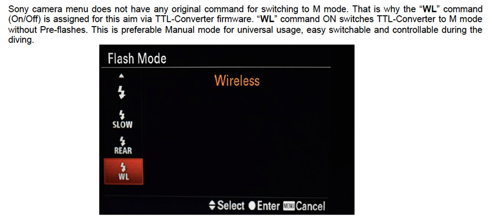

4 hours ago, Grantmac said:
Can you explain how the Sony WL command, which is RF based, works underwater?
Sony's camera menu doesn't have a built-in option for switching external flash to M mode. Therefore, a separate command, which isn't used underwater, was assigned (by TTL Converter firmware) to switch the flash system to M mode without pre-flashes.
UWTechnics TTL converters were the first to use the WL command to switch the flash to M mode. Company developed the controlled M mode, allowing the user to manually adjust the flash power via the Sony camera's menu dial. The same time, the traditional manual flash adjustment via the strobe knob is also available.
Here is the UWTechnics User Manual text:
Edited by Pavel Kolpakov
