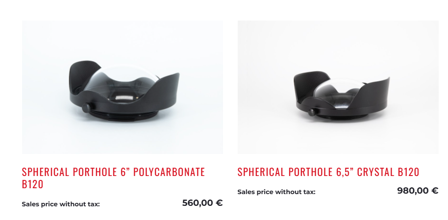

After upgrading to the Canon R6 mkII camera in Isotta housing I found out that the corners in the pictures with the 4" dome port are blurry, so I have to purchase a 6" dome port.
The options are Nauticam 140mm glass dome port, which are really expensive when I finally adapt it to my Isotta, I also can purchase Sea&Sea and Isotta 6" dome ports but this ones are plastic, and in these brands the glass domes are 6,5" which are to big for CFWA.
So this HowShot looks great in size and price, but I don't know anything about them.

Oups I checked it's a 6"5
"Isotta Glas Domeport 6.5" für Isotta DSLR"
I guess is it's too big for CFWA

Isotta have a 4.5"glass dome, you can also use a Nauticam 140mm dome by changing the lug ring to an Isottta/Sea and Sea lug ring.
I was told that new Nauticam version doesn't have the lug rig screwed to the body but machined with it, so if i find an old version second hand would be great. And the Isotta dealer in Spain doesn't recommend this 4,5" dome, he says i still will find blurry corners, a bit less that with the 4" but still a little bit. So I'm looking for different options. And today I have found this Howshot 140 mm dome ports https://www.divervision.com/products/howshot-140mm-optical-fisheye-port-for-seaandsea-nx-s120-mount-ofp-140-s120?_pos=2&_sid=f7fbcc98d&_ss=r
Which is glass, and looks like the Nauticam one but for pretty much half the price, but I don't have any reference of it. So basically at this moment I don't know what to do, the only thing I know is that I need a 6" dome port neither smaller nor bigger, I prefer glass, but If I don't find anyone which fits me in terms of money I'm open to plastic domes.

2 hours ago, CaolIla said:
Isotta dome in glass exist only in 6.5" the 6" is not glass
Yes, I know, If that 6" dome port was glass made I wold probably buy it, but it's plastic.

My 140mm dome has the lug ring screwed on, I know that all extension rings have the lugs machined in as do Zen domes. The Isotta 6.5"domes even though they come in glass or acrylic are not full hemispheres, so you can't position them properly for the entrance pupil for fisheye lenses as the centre of curvature is well behind the dome flange. The Howshot dome looks fine, I've seen and heard of a few accessories they make but don't recall anything about domes, I have heard all glass domes come from the same supplier for the major manufacturers, but Chinese made domes I couldn't be sure.
Unfortunately there's not much other choice for fisheye dome ports - I assume you are trying to house a fisheye?
