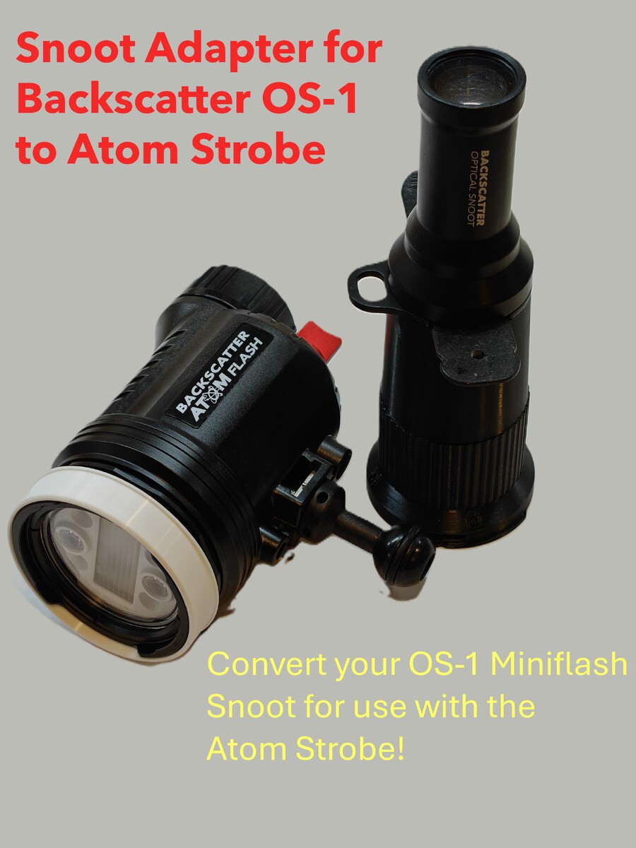

Convert your OS-1 Miniflash snoot to work with your Atom Strobe
https://makerworld.com/en/models/2718050-snoot-adapter-os-1-to-atom-strobe#profileId-3010574
I have had the Backscatter Miniflash MF-1 and MF-2 strobes for many years and love the OS-1 Snoot that this small strobe was designed around. It's probably the best snoot on the market, accurate and easy to use. The new Atom strobe is more powerful than the Miniflash models, but not much bigger. It's pretty much replaced my MF-2 strobe.
But I really didn't want to buy the new OS-2 snoot for it. It turns out that the new model uses the same exacted optics and lens module as the older OS-1 snoot. It just uses a new mounting part to attach to the strobe. I have designed an adapter with very similar dimensions as the OS-2 snoot, and it works perfectly. The light cards from the OS-1 will also work in the updated snoot.
Directions:
Remove the four M3 screws that hold the aluminum optics front end module from the OS-1 snoot. You will need a 2.5mm allen key wrench.
Use four M3 20mm screws to attach the adapter to the OS-1 optics module. Do not over tighten, just slightly finger tight. Do NOT use a screw longer than 20mm or you will very likely crack the glass in the optics module.
Filament Choice:
I strongly suggest using the recommended PETG for this model. PLA might work in the short term, but PLA does not wear well in the water and sun.  It might break unexpectedly when exposed to the elements.

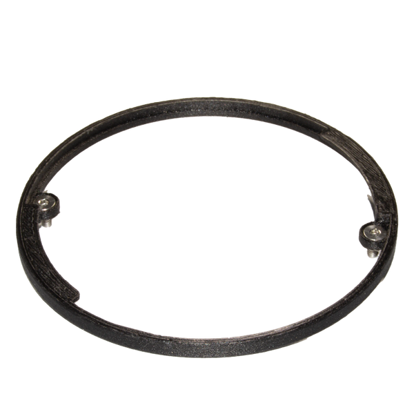

Hi Grantmac
It is certainly possible with some redesigning or an additional interface element.
I just dug out one of my 'back-up' Z240's and offered my Z330 adapter up to it. Obviosly there is no bayonet feature though the 2 filter mounting threaded inserts could be used to attach it BUT then it would be difficult to center the spotting light to the snoot and as this is only 160 Lumen the light is resultant spot is quite weak.
A better option would be to modify or add an extra element to the adapter so that it is a larger diameter and a push fit over the front rubber protective ring. This would make it wider but allow for better aligniment of the spotting light and the optics.
I have just added 2 other snoot elements 77mm and 34mm to my 'work in progress'
Sorry Dave - I did not mean to hijack your post.
TTFN JohnN
