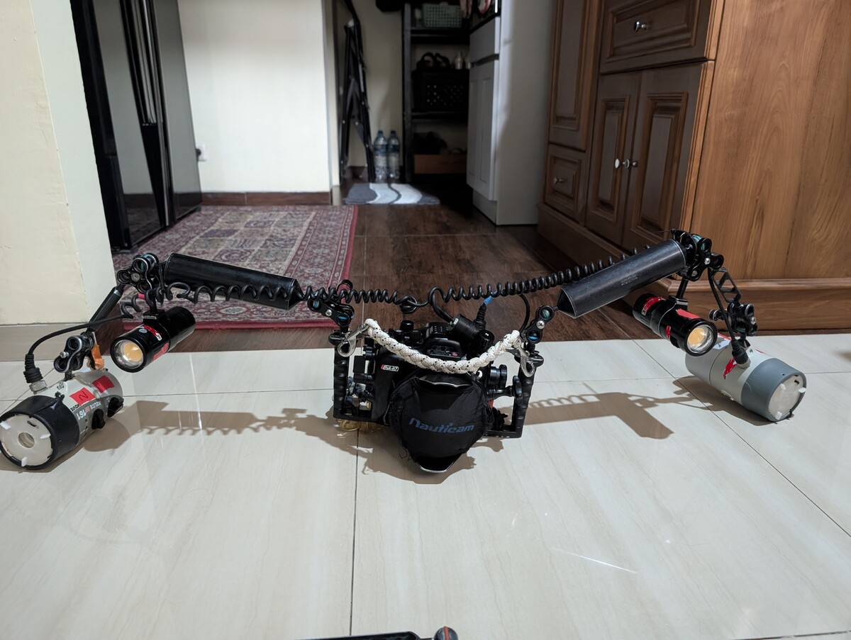

I'm in the middle of upgrading housing (first dives this week) and next task will be strobes and arms. BUT im currently stuck with my old setup.
I find it VERY bulky and messy, especially "folded" (it doesn't - it flops). Its huge, its bulky, its negative. They're DS161s from Ikelite.
I currently have:
2 x 8" Float arms
2 x 7" normal arms
2 x 4"ish normal arms
I use 2 x SUPE video lights on a 3 way elbow mid arm.
This is my WA setup for a Tokina 10-17 on APS-C to give FOV ideas. Its bulky, messy and due to 10 year old clamps, floppy.
For my wide angle, am i better off keeping this setup OR make it neater by replacing the 7" normal size arms with my 5" arms i found in a cupboard (so 1 x 8 and 1 x 5 per side).
Are there any real trade-offs for WA here vs improved in neatness?
Now I've gone mirrorless the abomination of strobe wiring and arms is even more obvious.

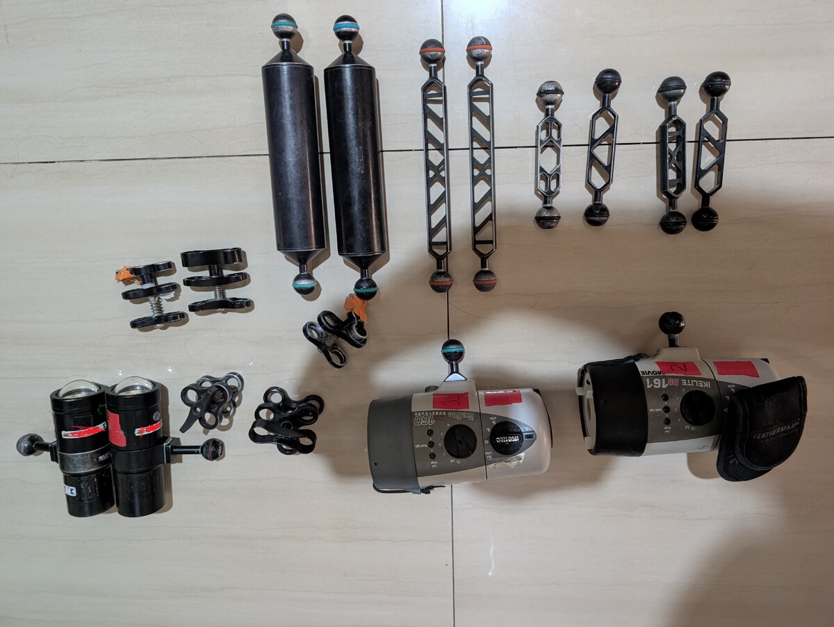

Pictures are the 8" and 4" on the WA setup. Can see its not neat at all, especially when "stowed" and holding the camera by the rope it just flops forward off balance. No easy way to carry. I find it ridiculously ungainly and so do boat crew trying to handle it.
So sugestions:
(i) best compromise WA arm length combo
(ii) Best order of arms and clamps to make it usable U/W but also neater to stow/fold.

Replace the orings on your arms so they don't flop around.
Put the carry lanyard at the top of the first arm segments so you can carry it all without anything flopping over.

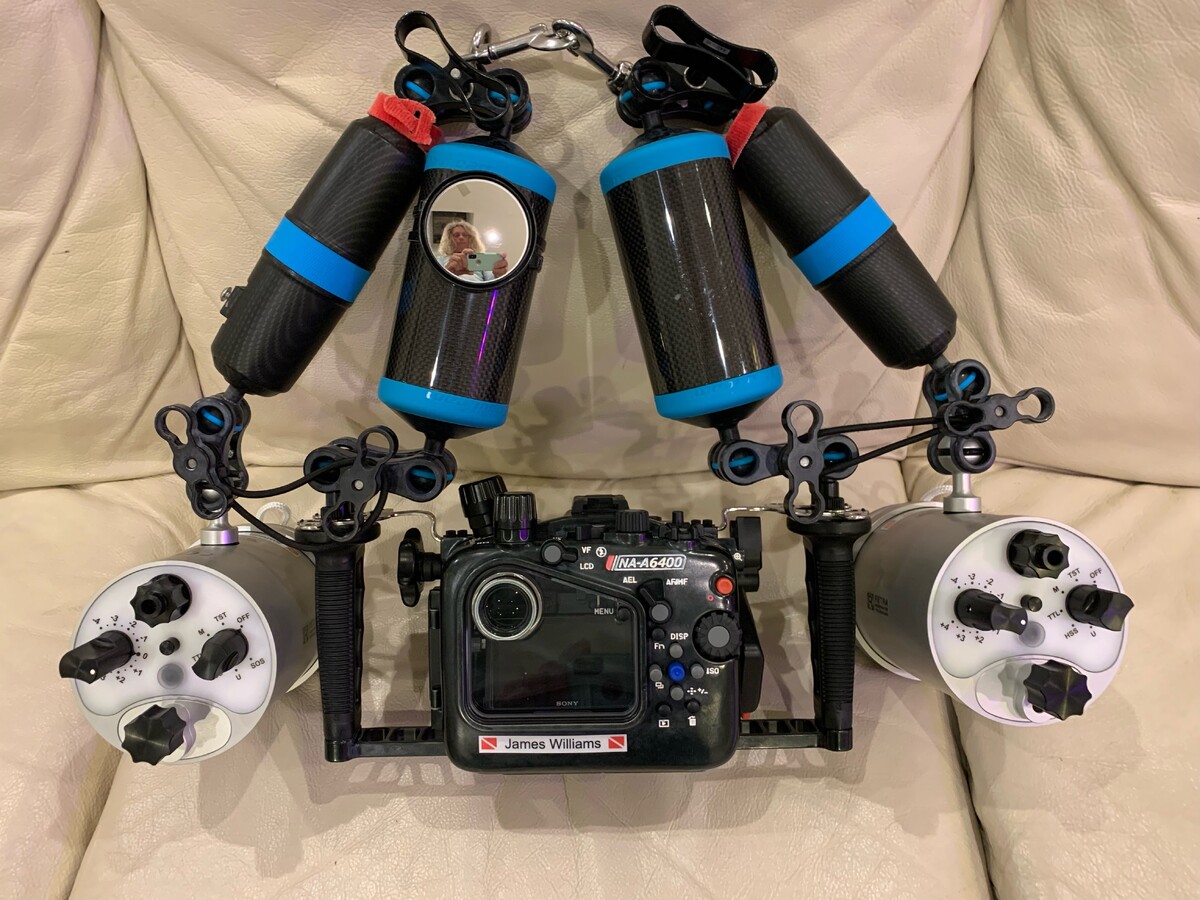

I like my carry handle to be on the center pivot with a "M" set up. So why do I have the additional bolt snaps? They lock the arms together at the upper pivot. The strobes are locked in at the outer pivot to the inner with bungee. Thus when folded up the rig is a secure package for handling especially when the crew has it handing off, no flailing about of the arms whacking the strobes about.
I have at least two regular dive buddies that use TG cameras. Both have three strobes and two video lights. One of them has two YSD3 on the outer arms, two high power video lights, triple clamps and over the top an Atom strobe! They cannot even get their rigs into the rinse basin yet mine slips right in neatly. And they try to call me out for the "huge" camera rig and I repeatedly point out that mine fits in a Sams bag and theirs need a porter! One of their issues in addition to multiples strobes and video lights is that they are using a single arms which makes folding up compactly a challenge for them.
Rigged as shown below your rig will not flop about. And I can set it up to clip off to my shoulder D rings and center crotch scooter ring. The two center pivot bolt snaps in such case go to each D ring, and the lanyard is wrapped around the lower grip intersection and off to the scooter ring. Configured so the rig is held flat to my chest and will not swing and flop about for beach entry/exit or even arms free climbing the boarding ladder with the camera still in my keep.
I do not shoot video and have no interest in video at all. But, I did get my new strobes with the video lights (for potential resale). But for those who try to do everything, combo strobes with built in video lights might be one way to get rid of two video lights cluttering up the rig?

Agree, makes life a lot easier this way, new o-rings do make a difference. Putting the short arm on attached to the handles and the long arm attached to the strobe generally allows the strobe to sit on the ground when folded into an "M", seems like that should be neater and more stable. The ikelites are good strobes but there's other more compact lighter options available these days.

I understand, that is why I too have the clamps with a shackle. And lock my arms at the center pivots with bolt snaps and at the outer to inner pivots with a bungee loop, tight or loose, my strobes cannot flail about like I see so often and with damaging results. I also beach dive often enough and need to be able to walk and enter and exit hands free.

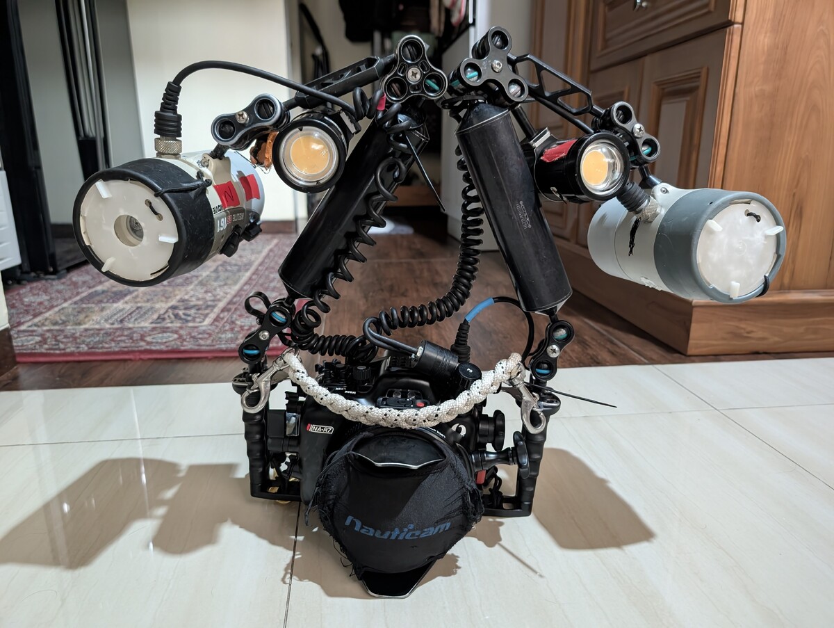

Thanks for that. I hadnt considered putting the rope on the strobe arms to stop it flopping. Not sure if i tries it not to just pull the clamps off though (?).
Changing O-rings is needed if i can source them (arms are different brands) and i suspect my 15 year old clamps arent great. I have to tighten to the point i need a large screwdriver to lever them open and it still flops.
Any suggestions as to which are length combo to use for WA/10mm fisheye on APS-C (180 FOV or so)? Both long arms? Long and short each side ?

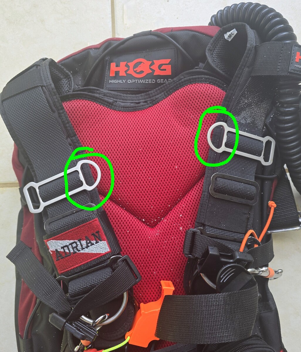

I have these lanyard holders on my ULCS clamps and have no problems with them. Did you install them between the clamp handle and the clamp, as in the picture? Ken actually recommended I install them between the spring and the clamp. This gets rid of all the problems you mentioned, except they do not stay in one fixed position - a small annoyance. Since I also clip them together with a double ender, I fit a split ring into the holes so I only use one double ender.

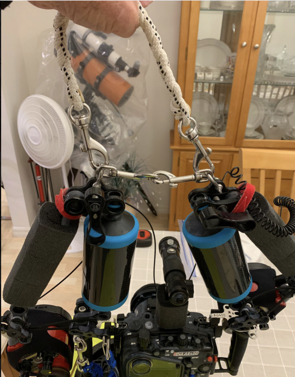

After reading how you secure your gear neatly some time ago, I have been doing the same: a double ender between the middle clamp lanyard holders and bungee loops on the strobe clamps that loop around the handle clamps. It is so much easier to carry the gear or slip it into a rinse tank or bag!
I originally used a double ender instead of the bolt snaps. But I visited the Reef store in Fort Lauderdale and saw those Nauticam shackle clamps and just had to have them and thus went to the dual bolt snaps. But, I have been considering going back to the single double ender. It is more comfortable to hold and slightly more compact and removes some clutter (the bolt snaps) from the camera while in use.
The lanyard would seem redundant sometimes perhaps since I usually carry the rig by the bolt snaps/double ender. But, boat crews fixate on that lanyard, they instinctively know that is where to grab. And during safety/deco stops I will sometimes let the camera hang from the lanyard clipped to one pivot to my shoulder D ring and clipped back to the other pivot afterwards and of course the coil lanyard is still attached until hand off for two point security, the two points being my hand and the coil lanyard or the white lanyard and coil lanyard. Sounds complicated maybe but it is not in practice.

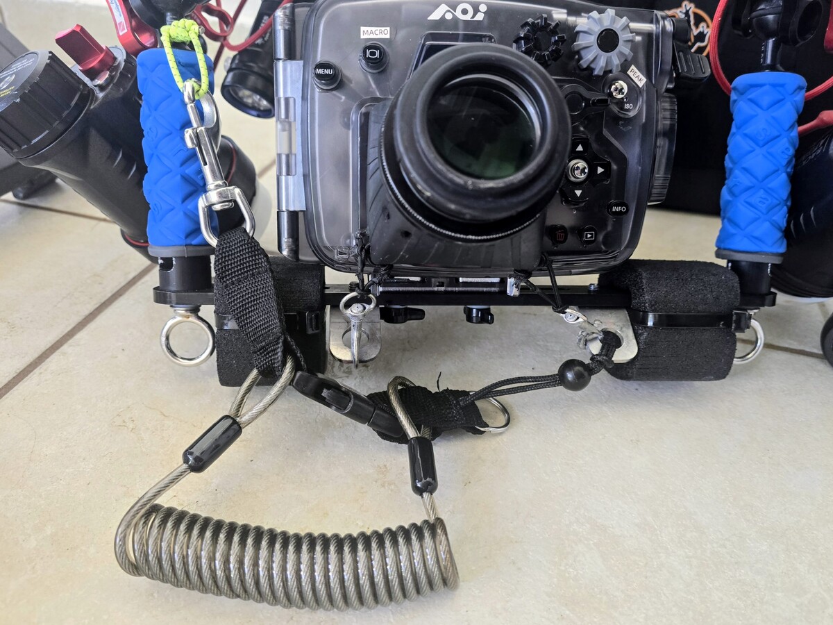

I do like the one 4.5" double ender for caring the great. It fits well in my hand. If I have a longer carry, I put a 5mm neoprene handle cover over it. I take the cover off on the boat. I haven't seen the double ender confuse crews so far.
I also secure my gear to myself, especially for shore entry and exit. The coiled lanyard comes off the parking loop and clips to my crotch strap d-ring. The double ender then gets clipped to one of these dog bone tri-glides. I move another free double ender from a chest D-ring to do the same thing on the other side. The dog bone tri-glides keep the gear higher so it doesn't bounce on sensitive areas while walking on shore. Once in the water, I store the double enders in my chest d-rings. Obviously, I can also attach the gear while swimming at either one or both shoulders, if needed.

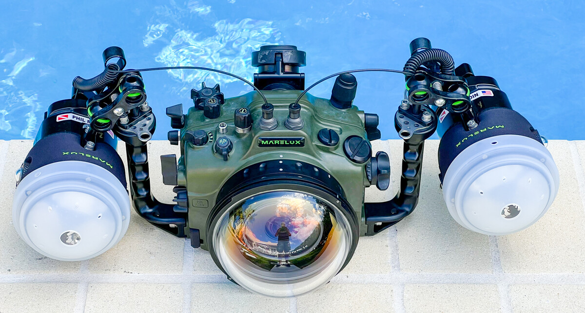

I sometimes use this configuration for fisheye and the Laowa 10/12mm F/2.8 rectilinear lenses.
This looks interesting, I never have dared to set my rig up like this...
Are there certain conditions/circumstances were you use the "short" configuration vs. long arms (= are the long arms just superfluos ballast)?
Regarding mounting the strobes directly to the housing grips this is something I started doing decades ago with 4/3 cameras and the Olympus 8mm fisheye lenses. The secret is to keep the strobes well behind the small (100/140mm) dome port. If you have a set of a bit longer clamps this becomes easer. Advantages are allowing you to have less drag in strong currents, getting in small spaces like moving through a wreck or cave, quickly moving between landscape and portrait orientations and more. Downsides are less ability to configure strobes to where you may want light coming from different angles, some like buoyancy arms to offset the weight of the housing/port system and more.
A photo of my most used configuration with eight and six inch arms is attached. Eight inch on the housing coupled with six inch to the strobes using Ultralight clamps.
