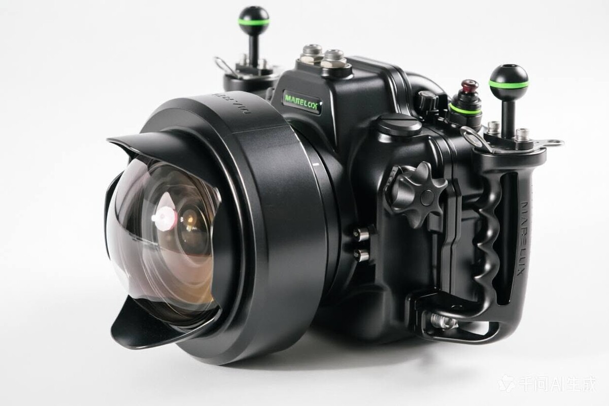

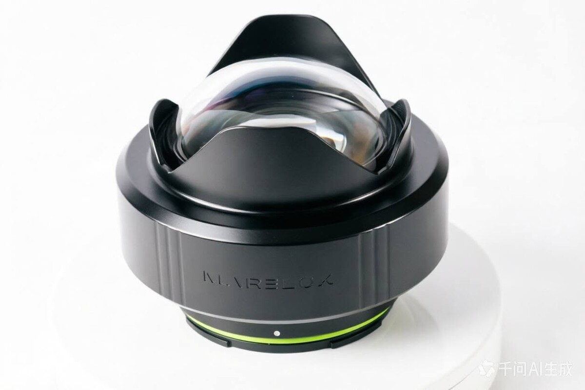

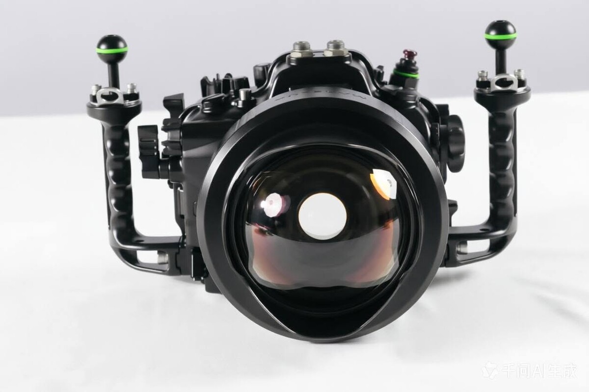

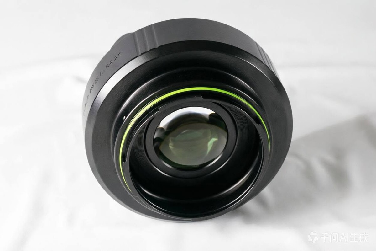

Marelux new Aquista 135D water contact wide angle lens is ready for shipping. This is the third lens in the Aquista line and the first dry mount lens not requiring a flat port. Depending on the camera lens being used the Aquista lens mounts direct to the extension ring required for that lens. With commonly used lenses like the Sony FE 28-60 & 28-70mm the Aquista 135D AOV is 130 degrees. With lenses like a 24-70mmm as you zoom in the lens will work out to 135 degrees (diagonally) at around 26/27MM. This new lens retails in the US For $2599.00. Go to the Optics section on the Marelux.co web site to download the lens compatibility charts.
Technical Specifications
- Dimensions:180mm Outer Diameter x 143mm
- Body Construction:Hard Anodized Aluminum Alloy
- Lens Construction:6 elements in 5 groups
- Lens Coating:Anti-corrosion Coating on the outside of the dome. Anti-reflection Coating on other surfaces
- Field of View (diagonal):135°
- Weight (Air): 2210g / 4.87lb.
- Weight (Underwater) :Neutral Buoyancy
- Port Mount:Series 5
- Depth Rating:100m
