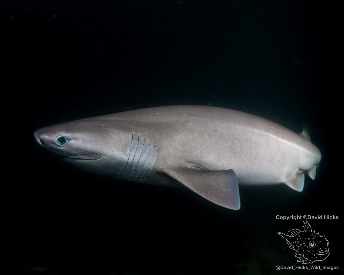

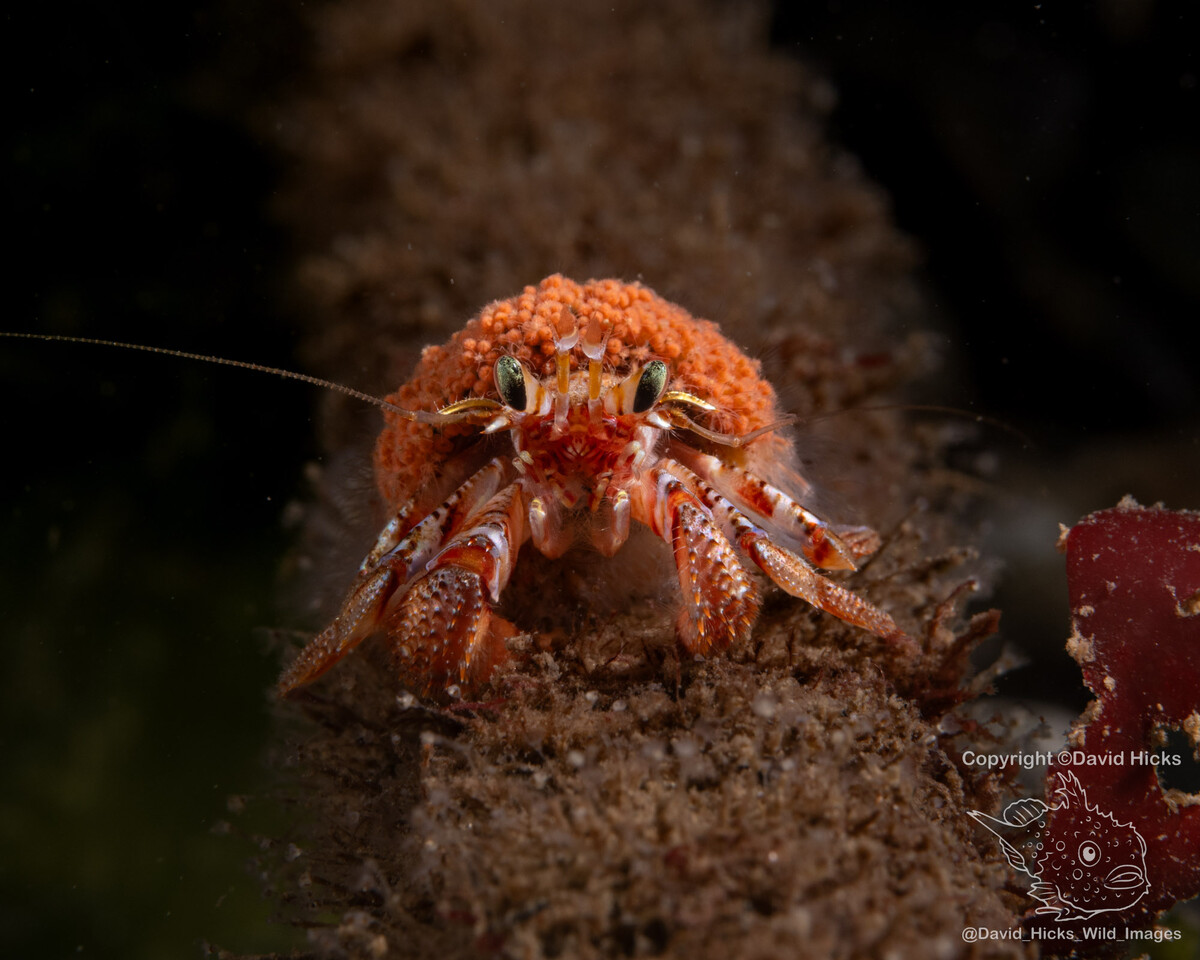

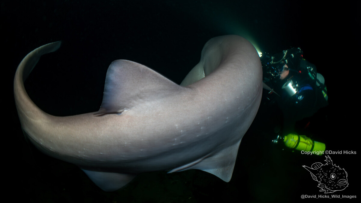

Here is a set of 4 photos taken with the Kraken 09s and Nikon 60mm., all on the same dive. The first three are of an 8 foot long Sixgill shark taken from just a few inches away. The fourth is a 1cm hermit crab taken with the 60mm and MFO-1.
The Kraken (and I presume the MWL) is very versatile. Excellent for CFWA, and then you have the option for true macro with the 60mm. I tend to use it on dives where they might be a chance for bigger subjects, but also good macro opportunities. The Sixgill dives are ideal for it. You spend about 30 minutes (hoping to see a shark) at 90-100 feet until you exhaust NDL then you head up to shallow water with great macro subjects. Aside from that I like to use it for CFWA scenes and not standard wide angle subjects. Corners are not awesome, but that is not always relevant as you can see below.
Nikon Z8 w/Nikon 60mm lens, Kraken KRL09 WA, f8@1/50s iso800, pair of Backscatter HF-1 strobes

Nikon Z8 w/Nikon 60mm lens, MOF, f18@1/160s iso250, pair of Backscatter HF-1 strobes

If the Kraken is in any way similar, that's an exaggeration at best. I often shoot it at f8 and up. The shark photos above were all F8 and they are very sharp.

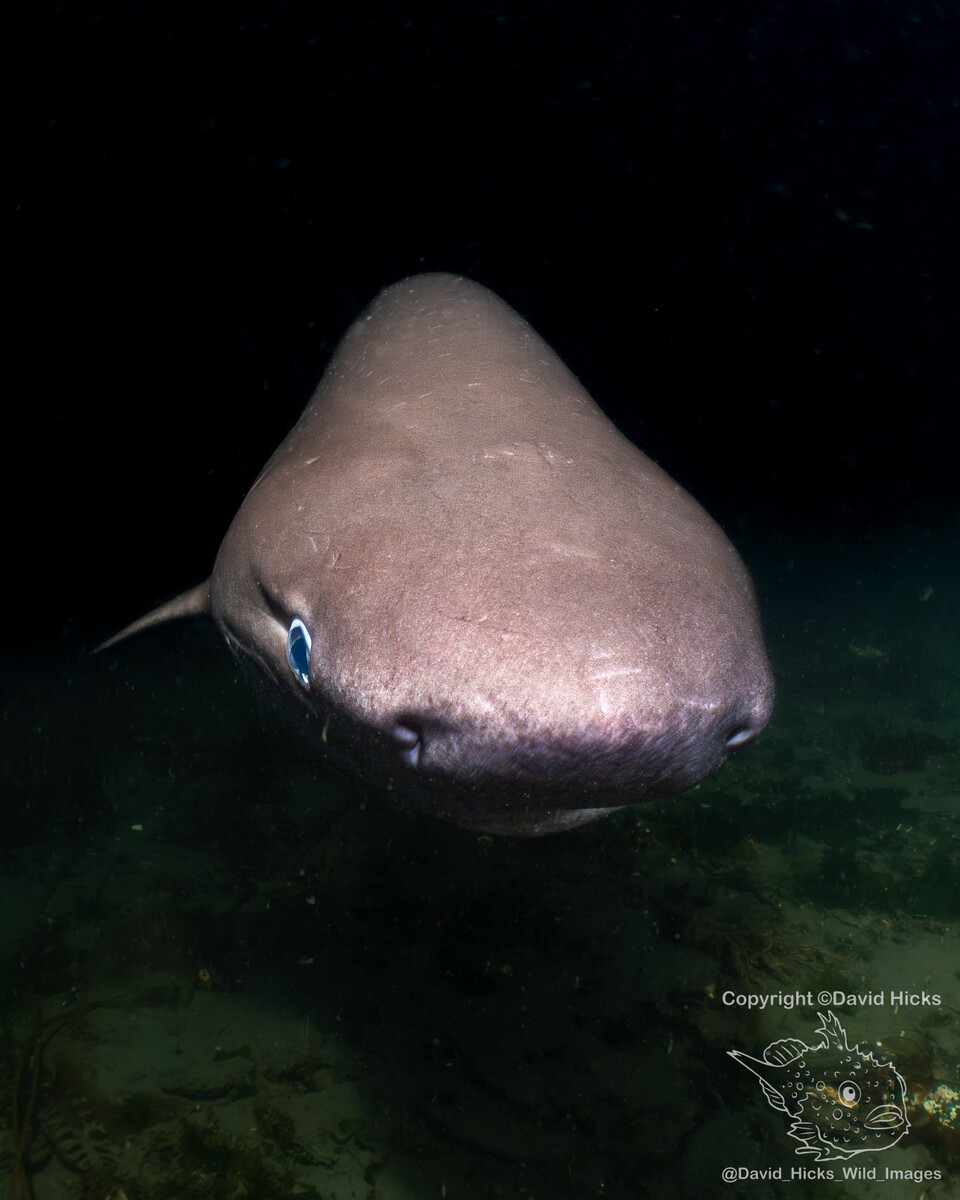

Attaching a photo shot with the Kraken at F11 at near zero range from the subject. This was taken in pretty chunky water, but if you look at the lower left you can get an idea of corner sharpness. The upper right is much further away and not in the plane of focus, plus chunks...
