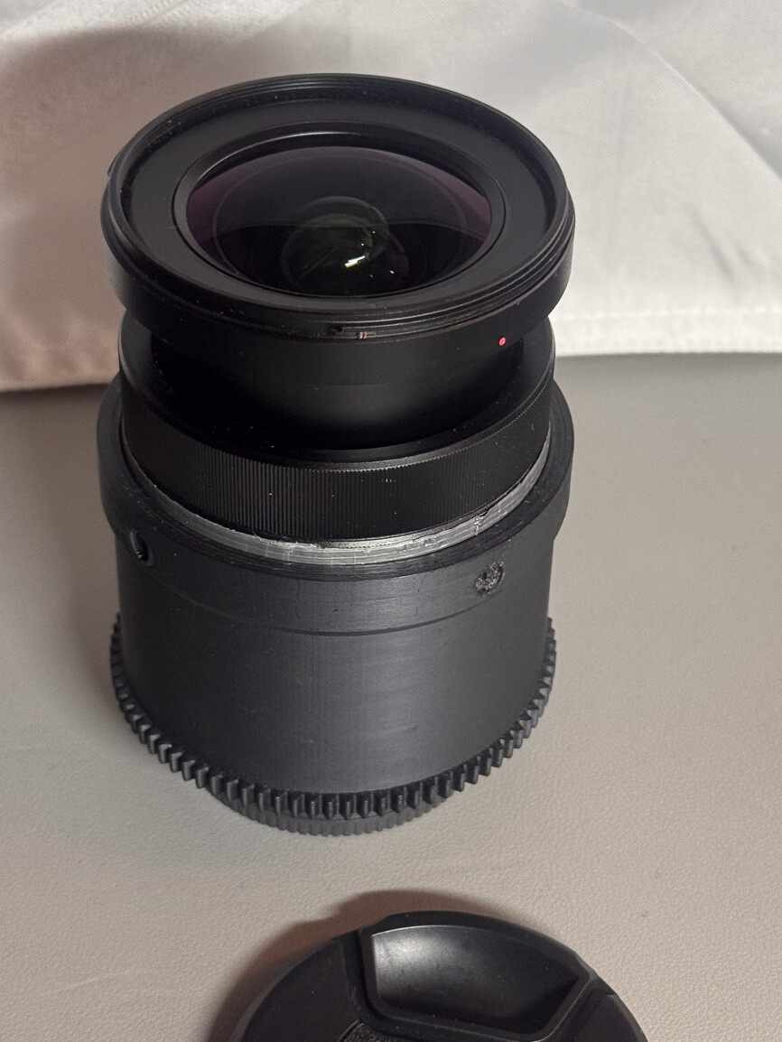

Zoomgear for Nauticam (Sony Housing)
for Tamron 17-28
for Sony 16-35 f4 1. Generation
the zoom gear needs some tape on the lens or the inside of the zoomgear to be stuck ob the lens.
A simple layer of tape on the zooming was enough to keep it attached and still be able to remove it.
ZoomGear Nauticam Sony16-35f4 1.Gen.stlZoomGear Nauticam Tamron 17-28.stl

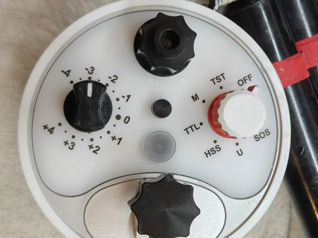

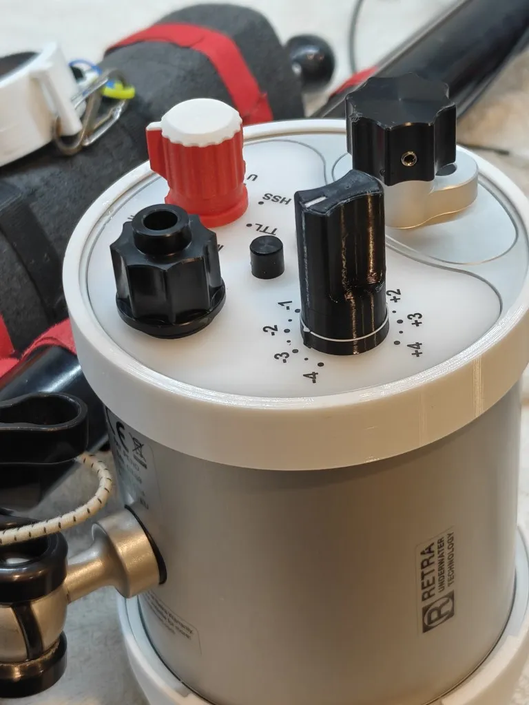

Retra Maxi Custom Knobs
format,webp
The responsiveness and precision of the Retra controls are superb. While the Retra control precision is excellent, I don't like that the Mode Switch and Power Level knobs look identical to each other. The power level is longer, but I found it hard to discern which was which, especially when wearing gloves. This is exacerbated when the strobes are in different orientations, resulting in mirrored positions. Both control knobs feel the same resulting in mistakes that screw up settings.
I love to customize the gear I use, so I addressed this with custom made Retra Maxi mode switch and power level knobs. The Mode switch is rounded with a “fin” to aid in alignment. I choose red and white colors to better distinguish the two controls. I find these changes to the Mode switch work a lot better for my style of shooting.
It also fixes another issue with the Retra Knobs - salt deposits. The Retra knobs are completely flush to the back of the strobe, and they have internal voids that retain water. Even after a long soak and air blow dry, you will find salt encrusting the base of the knobs a day or two later.
My replacements are solid with smaller voids and leave a 1mm gap from the base. This allows any trapped salt water to be flushed out. The included Power Level knob is nearly identical to the original design but adds the small gap for drainage.
Installation:
  • Use a 2mm allen key to remove loosen and remove the inset hex screw from the original knobs.
  • Use the same screw in the replacement knobs. Thread it a few turns into the custom knob.
  • Align the new knob on the appropriate post. Note the hole that will receive the screw.
  • Gently turn the screw with the allen key until it is flush with the knob.
  • If installed correctly the knob will be solidly attached with no wiggle room.

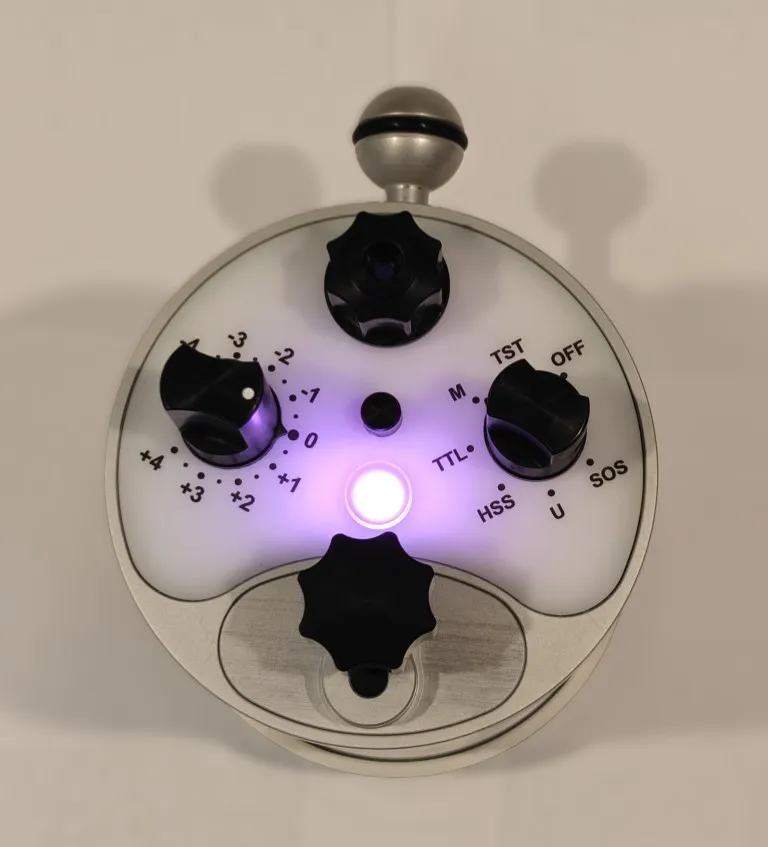

Original:
format,webp
Custom:
format,webp
Download from:
https://makerworld.com/en/models/2290342-retra-maxi-pro-max-replacement-knobs

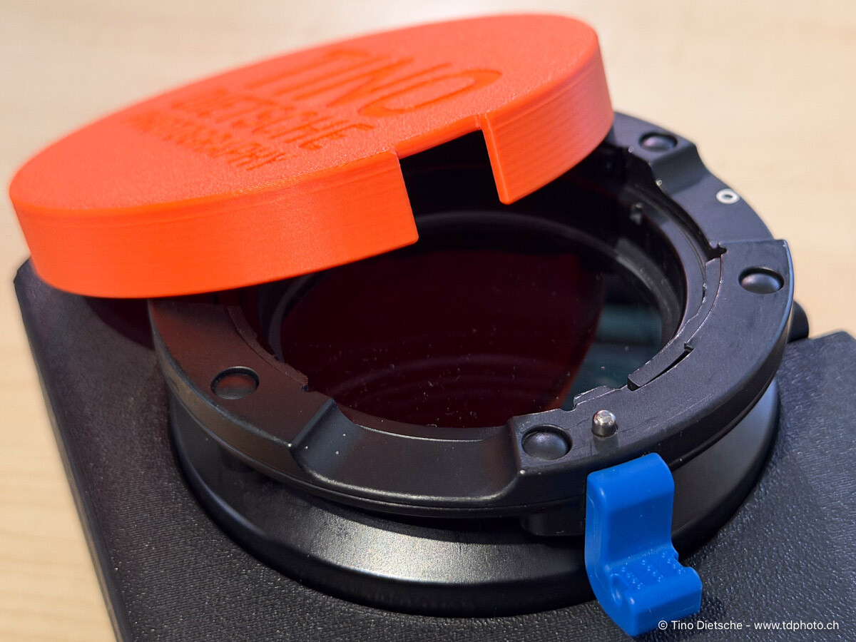

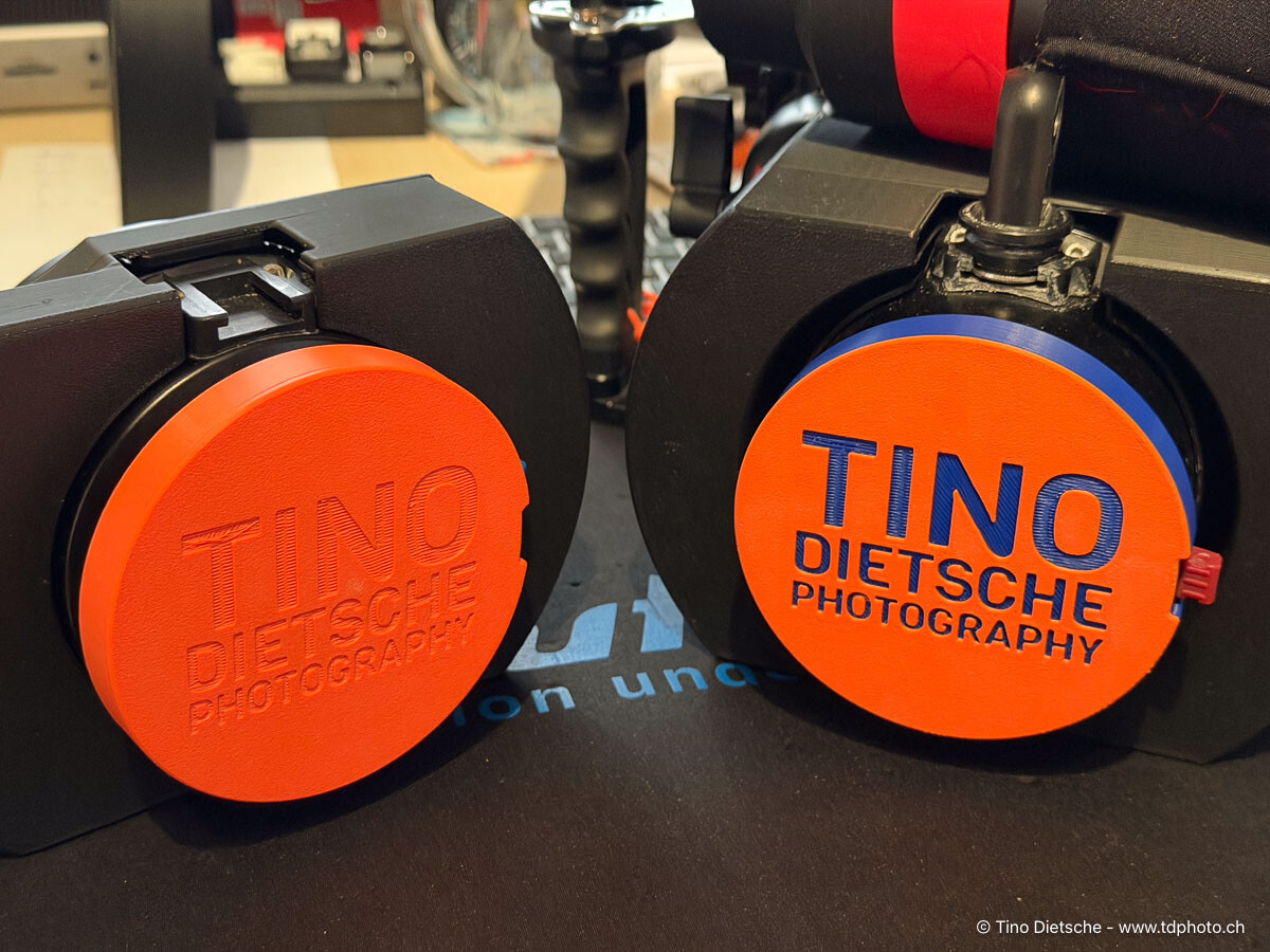

Port front cover for Ports with Nauticam Bajonet Mount (Version I & II)
Since I couldn't find my front protective cover for my ports with the Nauticam bayonet mount attached, I designed my own. Perhaps someone else has the same problem. It can easily be customized. Works with the old and new Version of the bajonet mount.
Download:
https://makerworld.com/de/models/2315559-port-front-cover-for-nauticam-bajonet-mount-i-ii#profileId-2528362

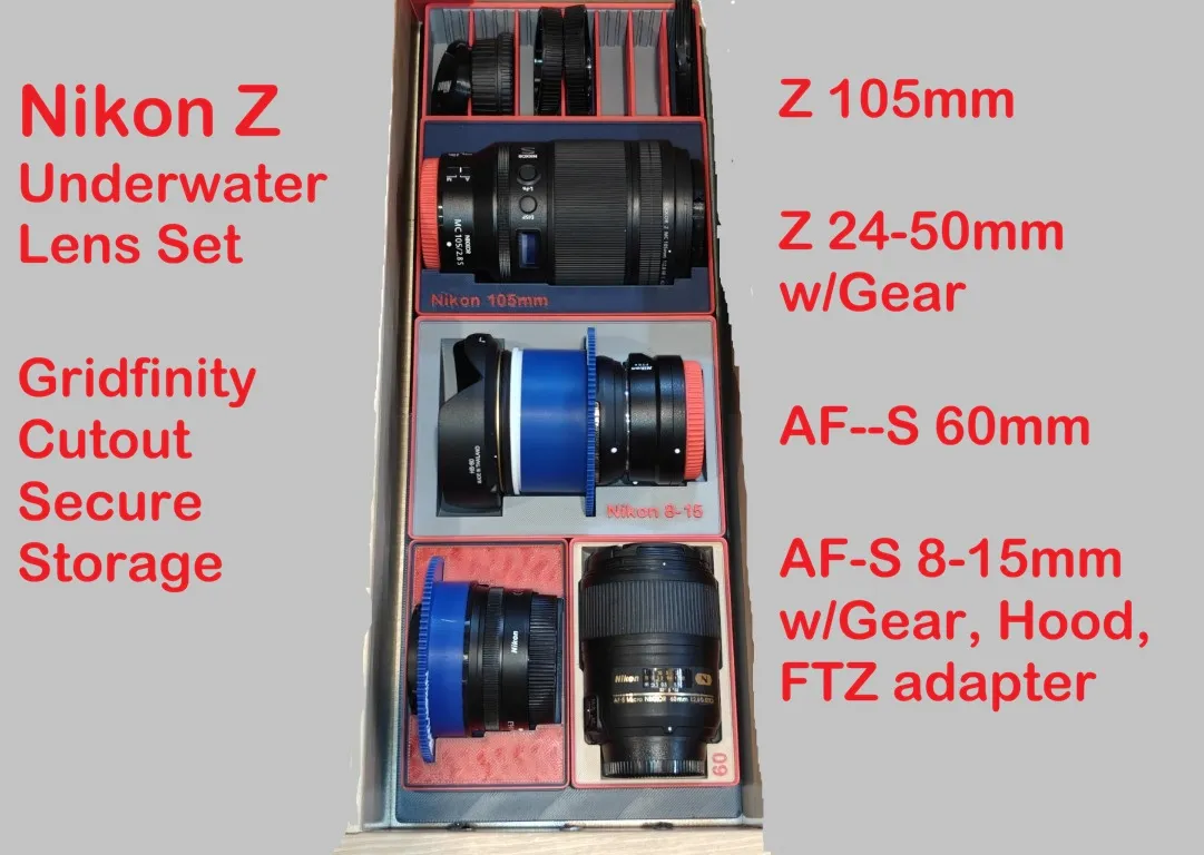

Gridfinity Storage for Nikon Underwater Photography Lenses
format,webp
I designed this set of gridfinity lens cutout storage trays for the full set of lenses that I use most often for underwater photography. Some of the trays will also be useful for any user of these lenses.
I shoot a Nikon Z-mount camera (Z8) and the following lenses:
  • Nikon Z 105mm
  • Nikon Z 24-50mm with Nauticam Zoom Gear
  • Nikon AF-S 60mm
  • Nikon AF-S 8-15mm Fisheye with Hood, Nauticam Zoom Gear, and FTZ adapter
Storage trays with cutouts that fit each of these lenses are provided in the set. Each is on its own plate with STL files available.
The trays are 4x3x7 or 3x2x7 gridfinity units.
https://makerworld.com/en/models/2316979-gridfinity-nikon-z-underwater-photo-lens-set#profileId-2530092

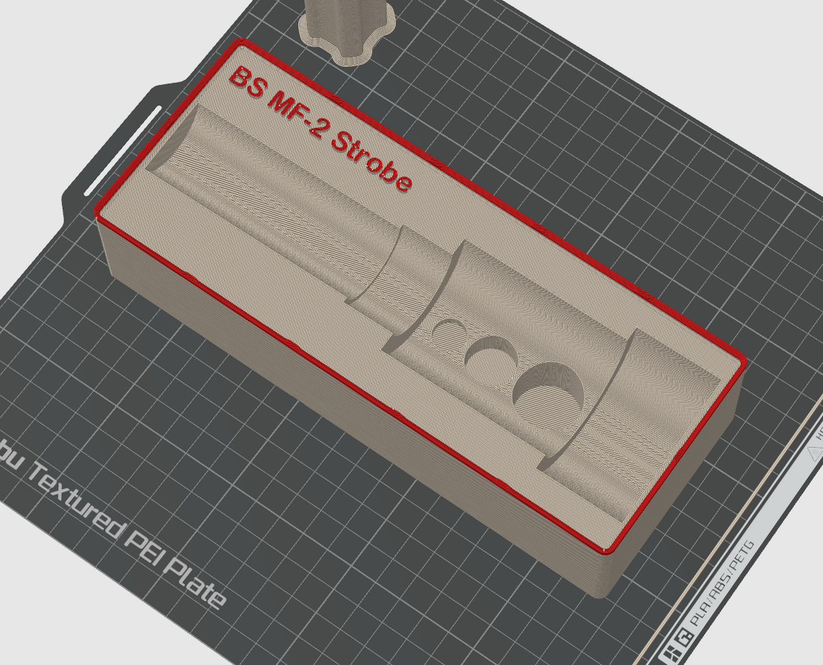

Have you got any tips for making the trays? I've been trying to make one for an MF-2 for a while but I'm hopeless with the 3D models and designing 🤦🏻‍♂️
I measured up and drew the outline, ready to use https://www.tooltrace.ai/ but I can never quite get it right
