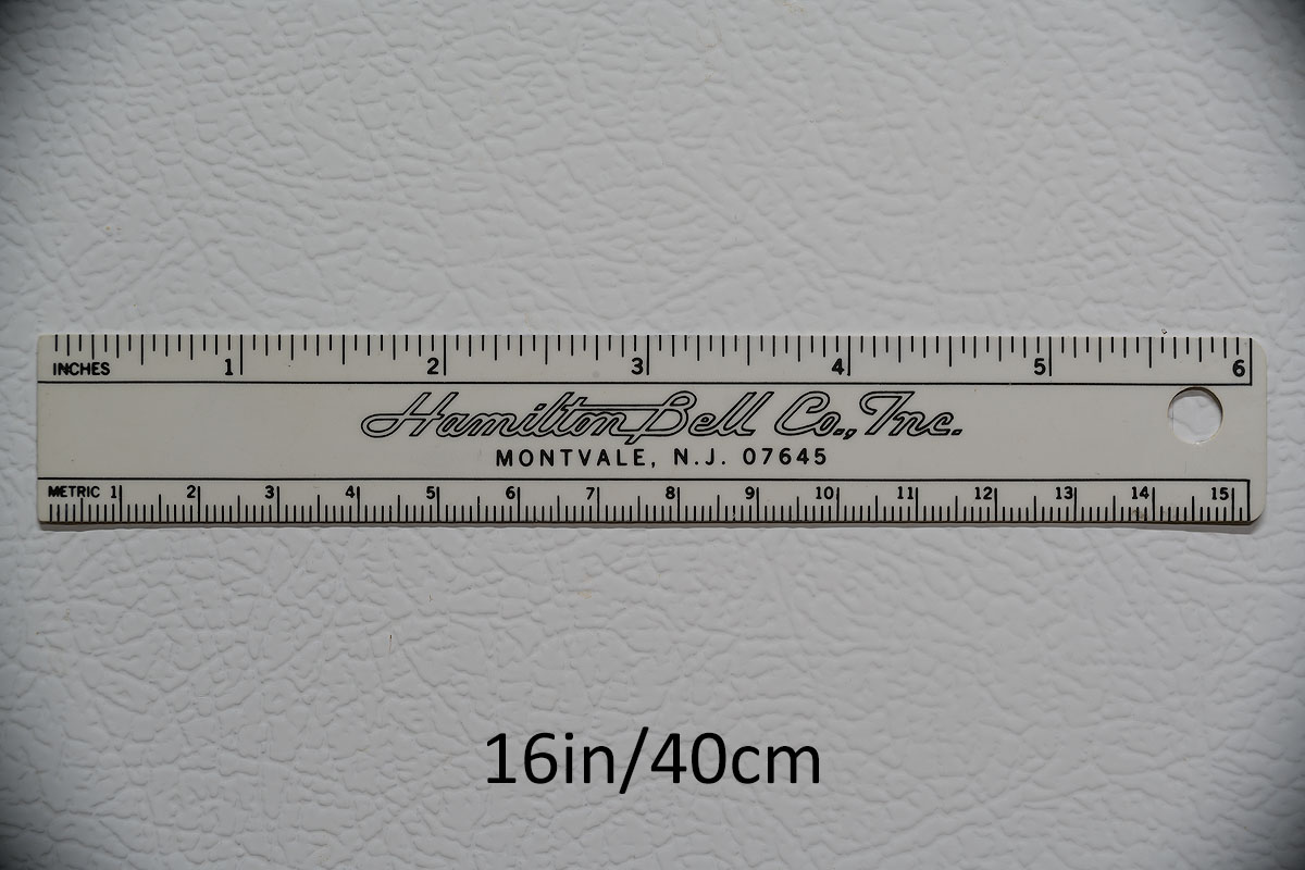

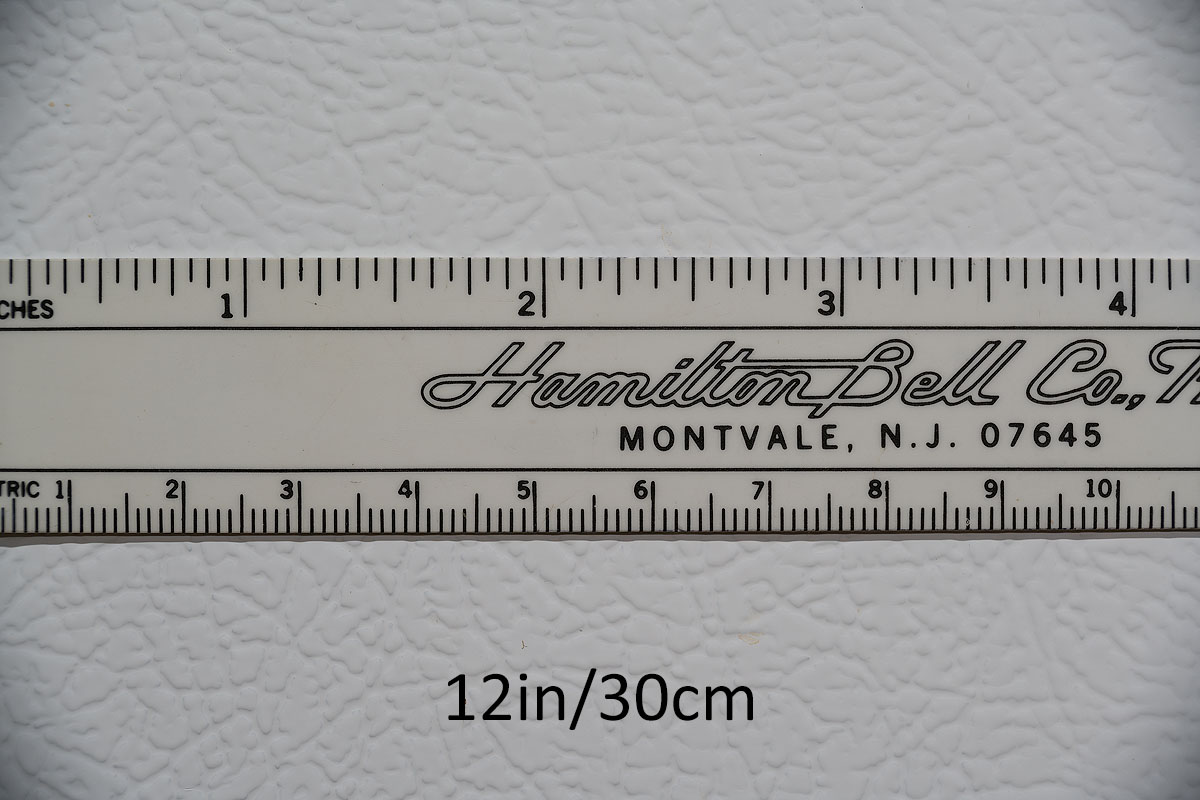

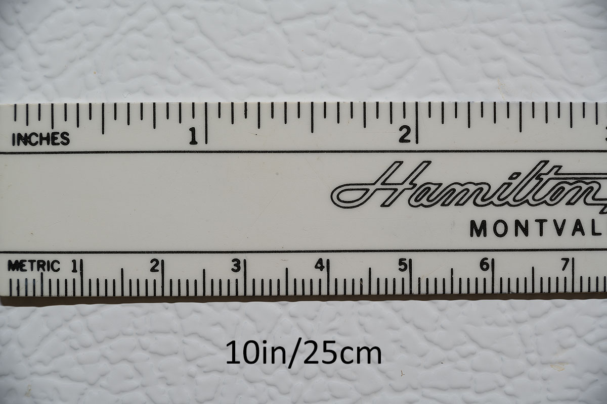

The vignetting is absent at very close distances and increases as the distance increases. With my A7R II and metabones IV, I consider the vignetting mild enough that it can be ignored from about 12in/30cm and closer from the sensor plane (in air, underwater might be slightly different). Here are examples taken at 10in/25cm, 12in/30cm and 16in/40cm.
So for small macro subjects at close distances the vignetting is not an issue, but for large macro subjects from farther away it could be for some people. In that case perhaps the Nikon 60mm could be a better solution.
