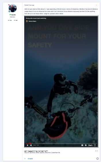

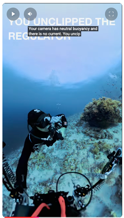

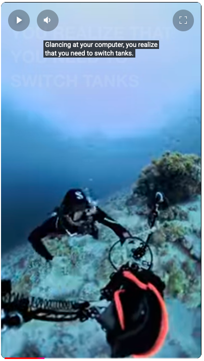

Still not sure what to think about it. I was expecting a little bit more in terms of sharpness. Weirdly it has kind of distance range where it is so so sharp but too close and it isn't (minimum focus distance obviously) but then it's like anything from 3m on is not sharp either. Judge for yourself, shot in 8k30.
as a sidenote this YouTube Short format you posted in is unreadable on my laptop (Firefox) - I get this massive long display which takes ages to load and can't display properly even zooming out.

I have the same issue, I believe it's due to the Shorts format.
I think once you get past 3m, you're limited by resolution. I thought about getting a 360 camera for B-roll, but decided against it because the quality of footage you get is nowhere near an action camera.

No I wasn't using Pure Video... honestly I forgot about that mode the entire trip, I got it like two days before. I am leaving for Indonesia next week so I will try it there. It didn't look though as there would be dark, this video was like at 18m at Yolanda reef in Red Sea during the clear day. There were other dives ideal for that I guess like Thistlegorm but again ... We will see next week ...

I have had very similar results when using Pure Video. Really not sharp, especially close to the lens. It looks best when it is the invisible stick away or a little farther from the subject.
