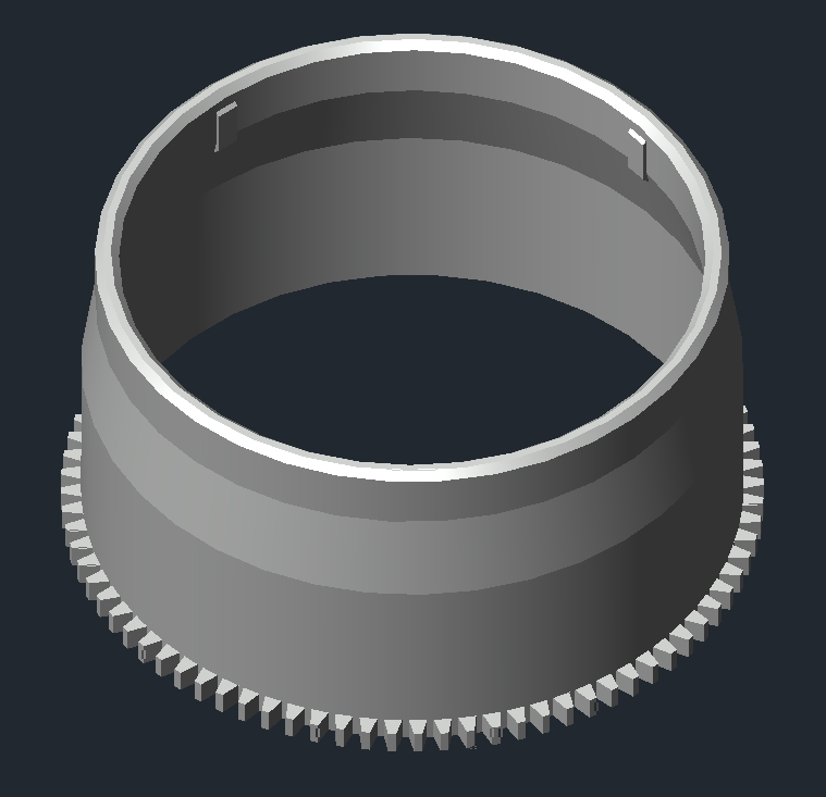

Hi All,
I've seen a little conversation about using the Canon 8-15mm, with and without 1.4TC and/or crop mode.
Just wondering if there's a source for the two zoom gear 3d print files (with and without TC)?
Any links to files or people who know would be appreciated.
Dan

3d design for Canon 8-15 nauticam gear:
https://makerworld.com/models/778776
Edited by Dave_Hicks
  • Author
Thank you.
Presumably, I can also chop 19mm out of this if I didn't want to use the 1.4TC?
Edited by foetusmachine

I print my own gears. I've just adapted the model that @Dave_Hicks shared above to be more like my current one I used on my Seafrogs housing. This doesn't require the rubber/TPU adapter and i've found it to work well. This is the standard gear, with TC extension. I'll still need to test it once I get the housing.

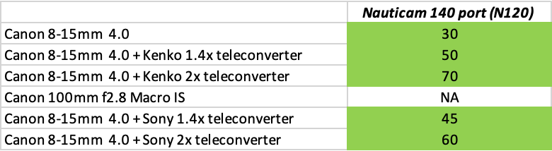

Here are the extensions that I use with the Nauticam N120/100 35.5mm adapter and the 140mm domeport (ignore the Canon 100mm macro, this is just a part of a bigger table comprising multiple ports and domeports). Usually I add up smaller extensions to give the full length (e.g. 25mm plus 35mm for the Sony 2x TC):
P.S.: I am using the Metabones V adapter...
Edited by Architeuthis
