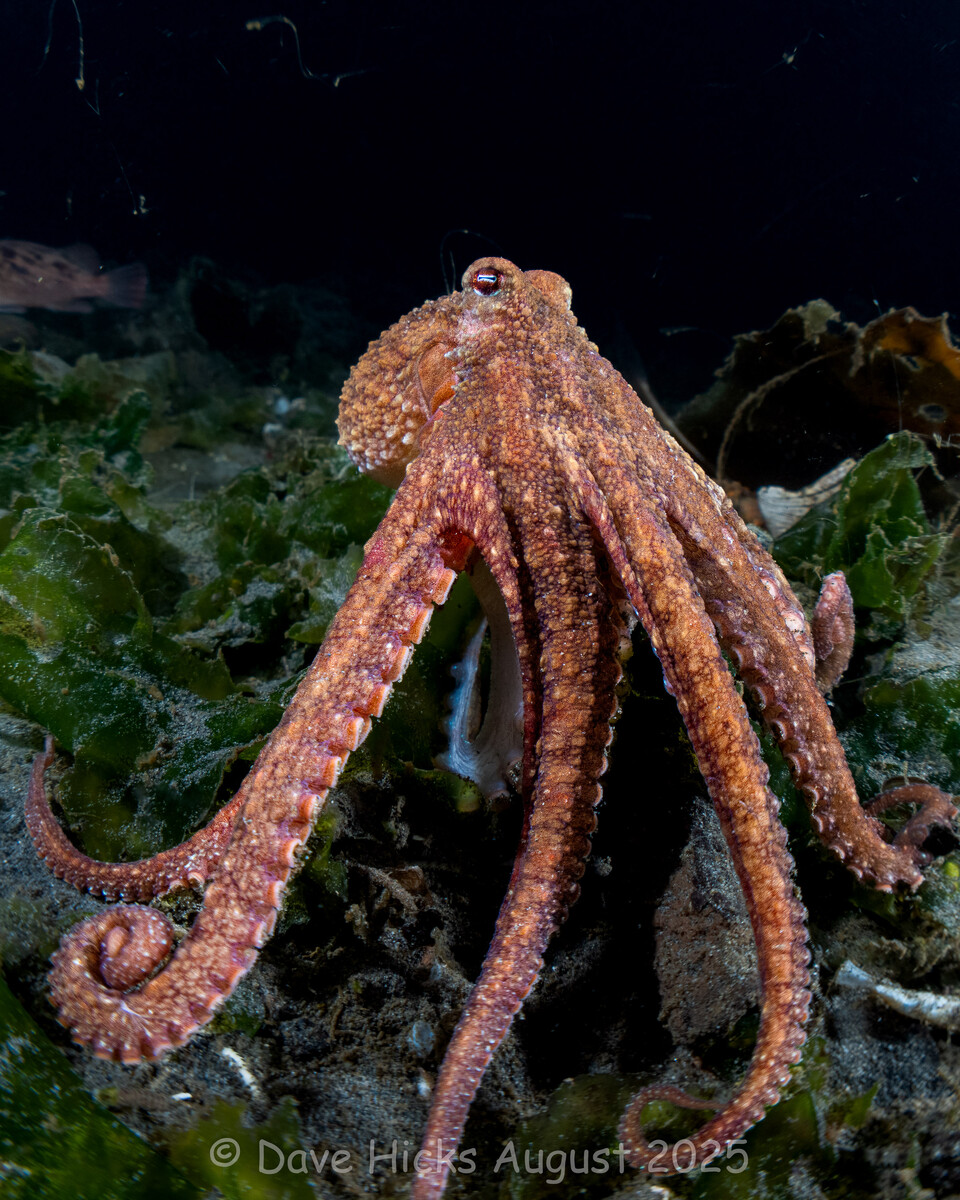

Here are a couple of images shot at f10 with the Kraken krl-09s. These are CFWA, taken from inches away from the subject.
2 hours ago, Dave_Hicks said:
I don't really care a lot about corners. I crop many/most photos anyway.
What lens does that work with that Kraken optics Dave? How do you find general IQ compared to the Nauticam WWL?

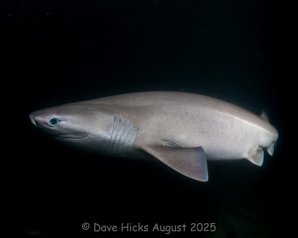

Here are a couple of more at f8:
Nikon Z8 w/Nikon 60mm lens, Kraken KRL09 WA, f8@1/50s iso800
Eight-foot long Sixgill shark on a very dark and murky summer night, range of inches.
The Kraken must be used with a 60mm lens. The Nikon af-s 60mm in my case on a Z8. The corners and overall quality is inferior to the WWL-C that I use. However, it is a great tool some conditions.
The shark pictures above were taken in crappy summer visibility conditions. The dive plan was 90 feet for 30 minutes looking for Sixgills. Then up to the shallows in to shoot small macro creatures with the 60mm and a diopter. You are able to combine true wide angle with true macro. This is a lot more range and flexibility than what some people are trying to do with the MFO-3 these days.
