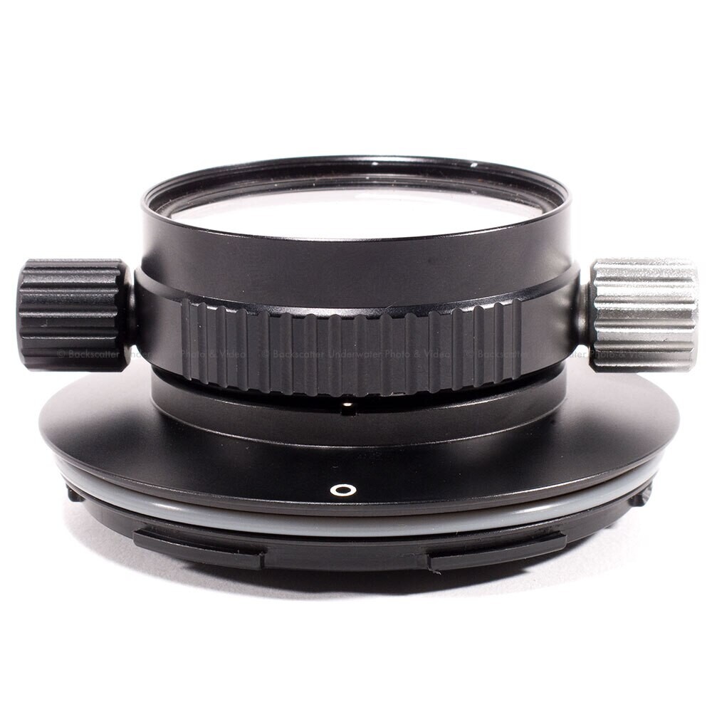

As an owner of a WACP-1, WACP-C, WWL-1B, and Canon 8-15, here is my objective, real-world experience with all. I use the inexpensive Sony 28-60 in all cases except the 8-15 for ultra-wide scenes.
Note 1 - One of the greatest strengths of all the wet optics is the inclusion of a real zoom option.
Note 2 - All water contact optics have a slight degree of barrel distortion at the wide end. Scenes such as pier legs or wreck interiors are best when zoomed in a bit to help compensate, or correct slightly in post. This is not, however, noticeable in normal reef scenes even at the widest FoV.
WACP-1: Dry Port - no water layer between the lens and external dome.
- Large on the surface with a weight of 10lbs dry
- Best image quality of the three, but not overly noticeable unless comparing side by side with others
- Very stable in-water due to size; beneficial for slower shutter or video work
WACP-C: Dry port
- Smaller version of the WACP-1 weighing only 5lbs dry, or half as much
- Not quite as sharp, but only noticeable if compared at high zoom in image review side by side with the same from a WACP-1
- Substantially lower price in comparison
WWL-1B: Wet Mount Port - layer of water between the flat port and the attached WWL.
- By far the smallest and lightest of the 3
- Very similar image quality to the WACP-C.
- My go-to choice for travel when size/weight are issues
- The lowest overall cost
- Must “burp” lens after entry to make sure no air bubbles are trapped between port and wet lens
- *WWL-C is same concept except designed for 24mm lenses vs 28mm
Canon 8-15 w traditional hemispherical dome
- Go-to fisheye option for exceptional quality
- Ultra-wide 180 FoV vs 130 degree max
- No real zoom ability
- Easily used with a 1.4x teleconverter for greater reach with no noticeable image degradation

I happen to own a unique Rebikov / Ivanoff Style corrector port which allows decent zoom through with that lens. With some tinkering, trial and error I lucked into this lens and specific uw glass combination, and I believe to currently be the only underwater photographer using such a system. There is a complete thread about my lucky find in this forum:
https://waterpixels.net/forums/topic/2637-ivanoff-style-underwater-corrector-port-on-a-canon-marelux-mx-r6ii/
