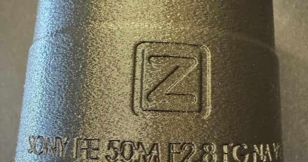

https://www.deepshots.co.uk/collections/gears-for-olympus-and-panasonic?grid_list=grid-view&filter.v.price.gte=&filter.v.price.lte=
https://eocean.eu/en/16-custom-design-machining
No image preview
F.I.T 3D printed zoom gear and focus gear of various styles
[Instructions] Zoom ring/focus ring customized production If you have any questions, please contact info@fun-in.com.tw
