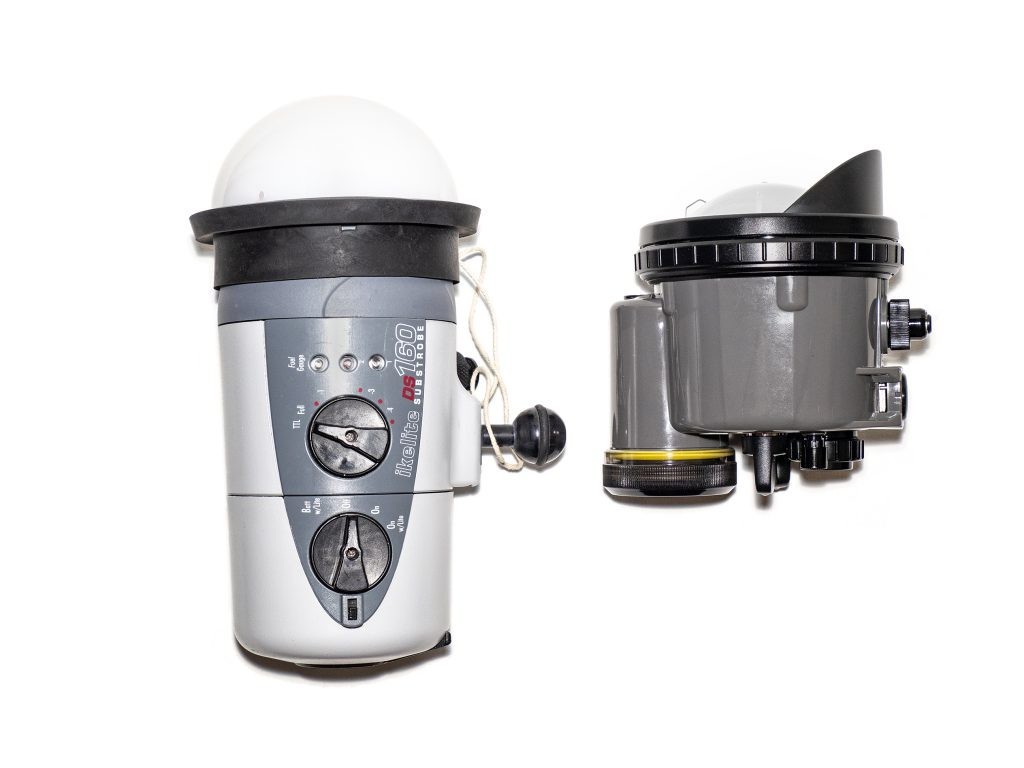

The "strobe light quality" is real and as someone wrote it is not primarily about the technical parameters of the flash except for the temperature, but it is about the physics of how the light is transmitted, bent and refracted into the water environment. If there is sufficient power, then of course the "quality" can be improved by a dome diffuser of the appropriate temperature and size. In my practical experience a pair of Ikelite DS 160 (circular tube) without diffuser has very similar light quality to a pair of Inon Z-330 II (two spot lamps) with warming filter and dome diffuser. Similarly, a pair of MF-2 with diffuser has a similar light quality to the Z-330 II pair without diffuser. The Ikelite DS160 with dome diffuser is the best of what I have had the opportunity to try. Of course the dome diffuser is not suitable for everything and if there is a lot of dirt/particles in the water, we limit what we illuminate as much as possible. I would assume that the best default light quality without a diffuser would generally be with circular tube strobes.
Well then there is ergonomics of underwater use and once the DS160 drops somewhere down the line. A pair of DS160 with a dome diffuser is really cumbersome and for freediving this is especially true. The control from the side of the strobe is also inconvenient. The specific accupack is another cause of trouble. So now I actually go in the water with either a pair of Z-330 II (for wide angle) or a pair of MF-2 (for macro). When the time comes and the Z-330 leaves me, the Retra will be a great upgrade (like the DS160, but in a practical modern way).
Exactly.
