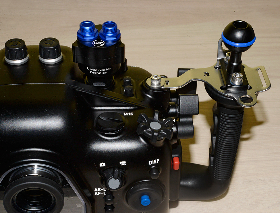

Hi Pavel, is a slave Mode on board? And could I continue to use my current Nikon Z8 UW-Technics TTL board?
Greetings
Jörg
  • Author
23 hours ago, makar0n said:
Would there be any chance for a model without the video light to appear one day?
We have different strobes in plan for future. Some of them will be without video light.
  • Author
Greetings
Jörg
Hi Jorg,
We probably can update your TTL-converter, if hardwire allows the OPTIMA strobe support. We will check. Let's be in contact by messenger or e-mail.
What slave mode do you mean, probably the triggering from other strobes? We plan to produce an external sensor (screws to the strobe input) for creative shooting with few strobes, which provides a wide radiation pattern and high sensitivity to pulse flash, but totally resistant to sunlight and torches. Such device electronics is already developed by us. This task will be covered very effectively.
Edited by Pavel Kolpakov

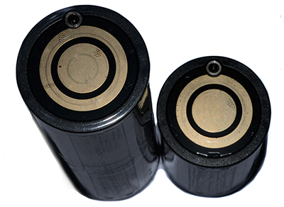

Can you give some more info on the different size batteries posted on Facebook?
Do you need to buy some battery compartment extension also like Retra booster because the info there is very vague?
When will you release pricing info and availability of accessories (snoot ect)?

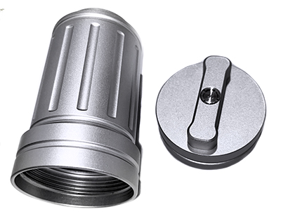

Sorry for some information delay. UWTechnics updated the OPTIMA strobe specifications for the serial production, including 16,000 lumen video-light, battery options, optional silver color for the strobe, etc. Pre-orders are also opened now.
Here are some more details about the update:
1) Optional SILVER strobe body color is available now.
2) New battery options:
  • Standard battery: 4-cell x 18650, it goes with the standard strobe kit. It uses standard length cover.
  • Extended battery: 8-cell x 18650, it is optional product. It uses a long length cover.
3) Safety pressure valve (on the battery cover), - protection for Li-ion battery usage.
4) Video-light 16 000 lumen, CRI 92, Color Temperature 5000K. Adjustment range: 0 ... 16000 Lumen (8 steps).
5) Video-light working time (at maximum flux 16000 Lm):
  • 54 minutes with Extended Battery,
  • 21 minutes with Standard Battery.
6) Strobe serial production starts in July-August 2025. So, the product is expected to go on sale in September.
7) Optical Snoot with internal adjustable aperture, and External Reflector, - both attachments are in work now and will be announced soon.

Looks like the videolight has recieved little update again, now to 18000 lumens.
[quote]Professional Video-light 18000 lumen, true colors CRI 92, Color Temperature 5000K.
Video-light working time (at 18000 lumen): 45 minutes with large battery (8 cell), 18 minutes with small battery (4-cell).[/quote]
Is the battery compartment single or dual o-ring? The cover (and thus the o-ring) will be very close to the buttons like many other strobes nowdays. I would love to see dual o-ring, but i suspect its single.
Still thinking about this, if the 2 in 1 is really worth it (instead of separate systems).
Price is of course something, also anxiously waiting for the snoots ect release.
Edited by Sokrates
  • 2 weeks later...
  • Author
Battery compartment has 2 o-rings, placed in 2 different diameters. This is for the best cover sealing.
Also, the battery compartment is hermetically sealed from the strobe. Electronics inside the strobe is protected by this way.
