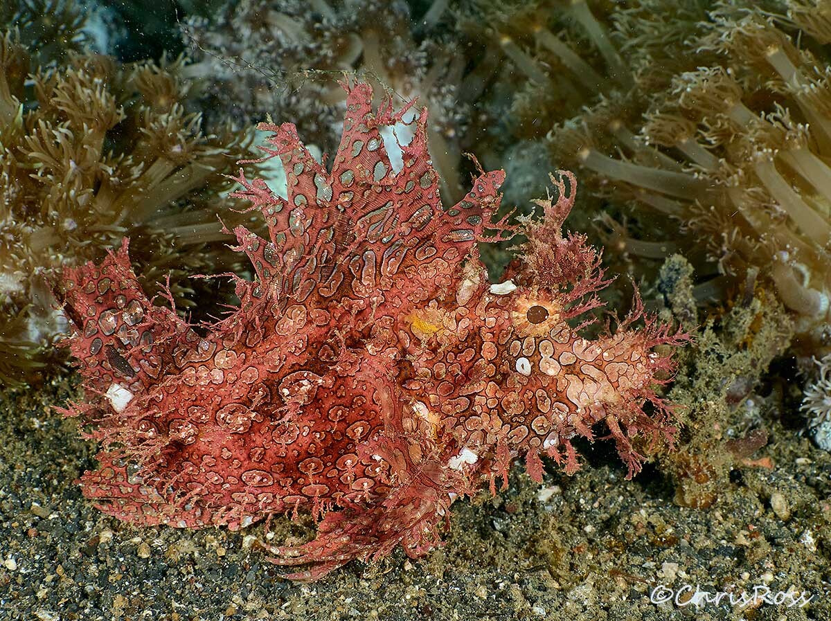

Weedy Rhinopia - slight crop:

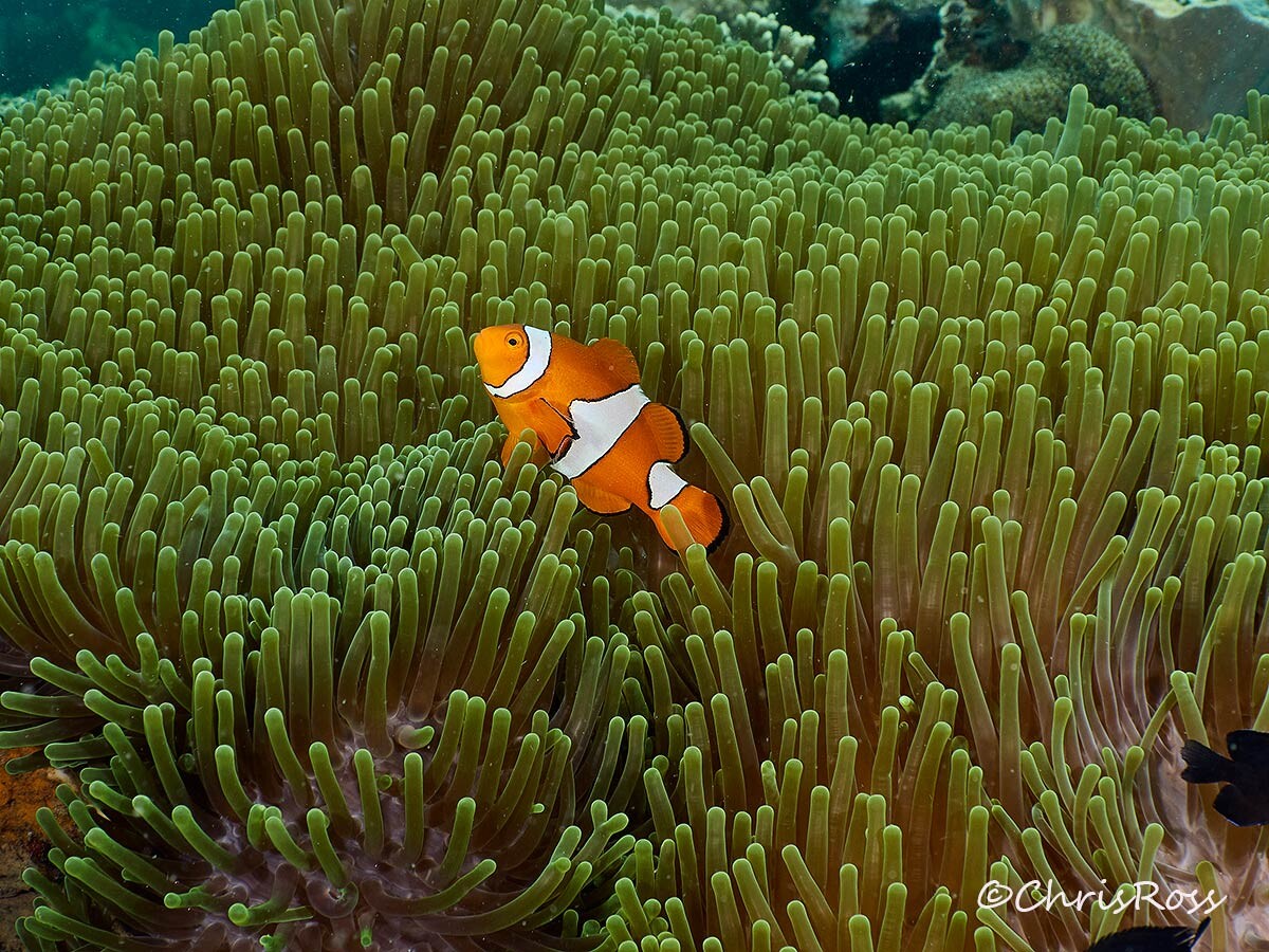

A False clown anemone fish, I would normally crop and get in closer but this shows the sharpness across the frame:

I believe it was at Tanduk Rusa divesite, black sand slope and it was in a really large patch of the soft corals you can see in the background of the frame. May might be a stretch but you can ask the guides, they normally know if one has been seen recently.

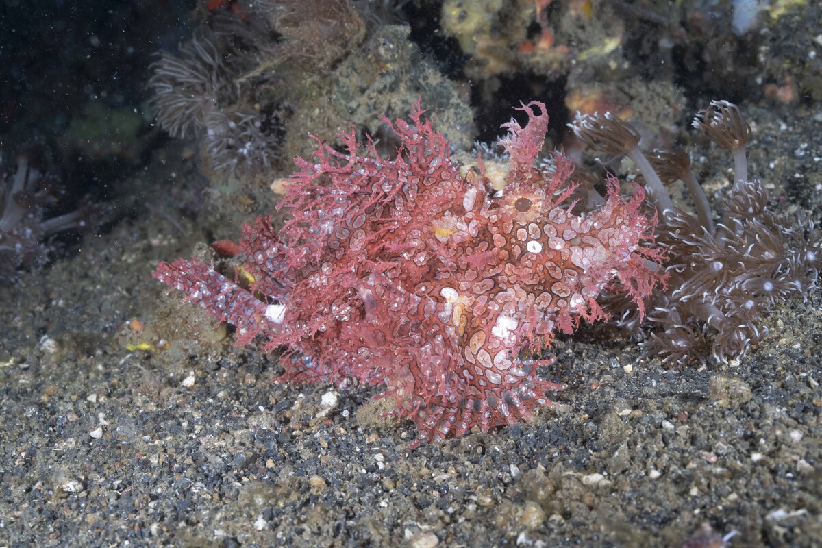

As a comparison to Chris photo, here is a pic of possibly the same fish, taken at the same site (Tandurusa) about a week earlier, using Sony 50 macro with 140 dome (A7RV) - similar field of view.
No cropping, in fact no adjustments at all (yet) although I will process it slightly when I get around to it.
Definitely the same fish, based on the color pattern 🙂

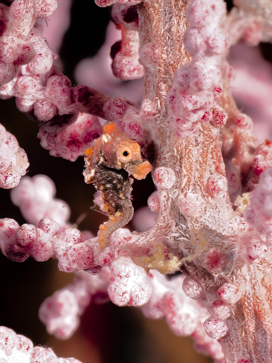

pigmy seahorse - between 1-5cm from flat port

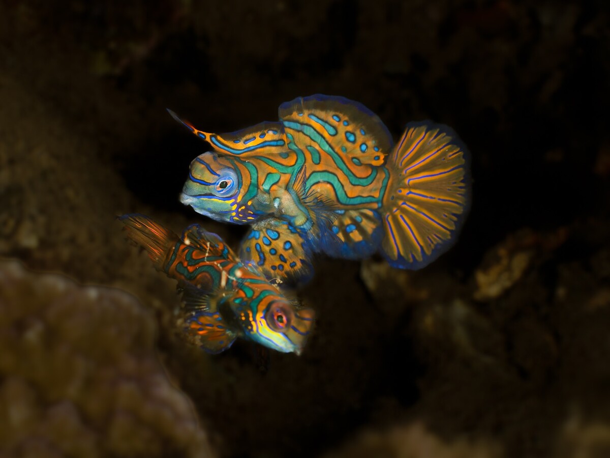

mandarin fish - night dive, very low light (non direct red light on subject), still was able to focus on fast moving subject
I used these examples as I know I would have not been able to take the pigmy and mandarin shots without the MFO3, the anemone shot just maybe but would have struggled more with distance and autofocus.
