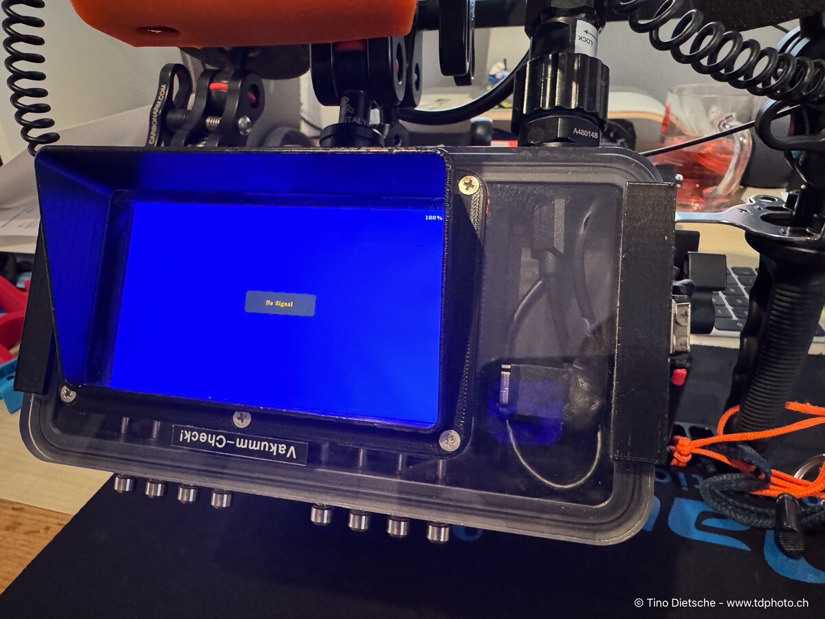

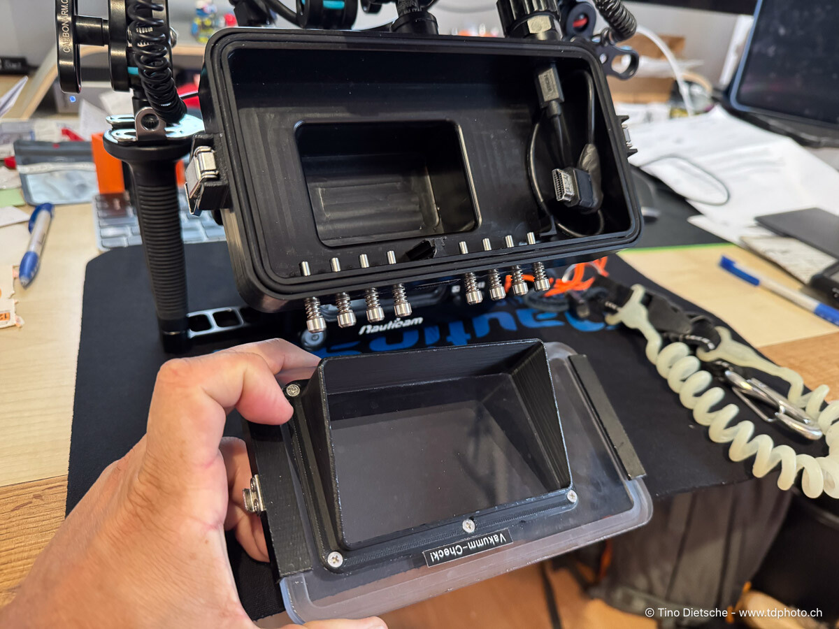

I've had the idea for a simple and lightweight monitor housing for a while now. About five years ago, I was able to turn it into reality together with the German underwater housing manufacturer UK-Germany. At that time, underwater monitor housings already existed, but they were either extremely expensive, large, and heavy, or mostly based on recorder monitors.
But I only wanted a simple monitor, a sort of viewfinder replacement.
For the monitor, I chose a simple product from Feelworld, as I absolutely had to have normal buttons on the device. We initially wanted to create our own cable solution for connecting the underwater housing to the monitor housing, but that was too complicated, so we opted for HDMI connectors and cables from Nauticam.
The monitor housing is made of POM plastic and was milled from a single block. The front is made of Plexiglas.
This is exactly what I am about, but I don't have the machines to do it, I was thinking in something like a cheap old plastic housing for a compact camera where I can adapt a monitor. Your one looks great and profesional.
This is amazing! What size of battery can you fit in that housing? And Feelworld model?

Thanks for your feedback. In my case, the milling of the case was also done by a specialist.
I might have a case from the series for sale soon. I can inquire and clarify the prices if necessary.

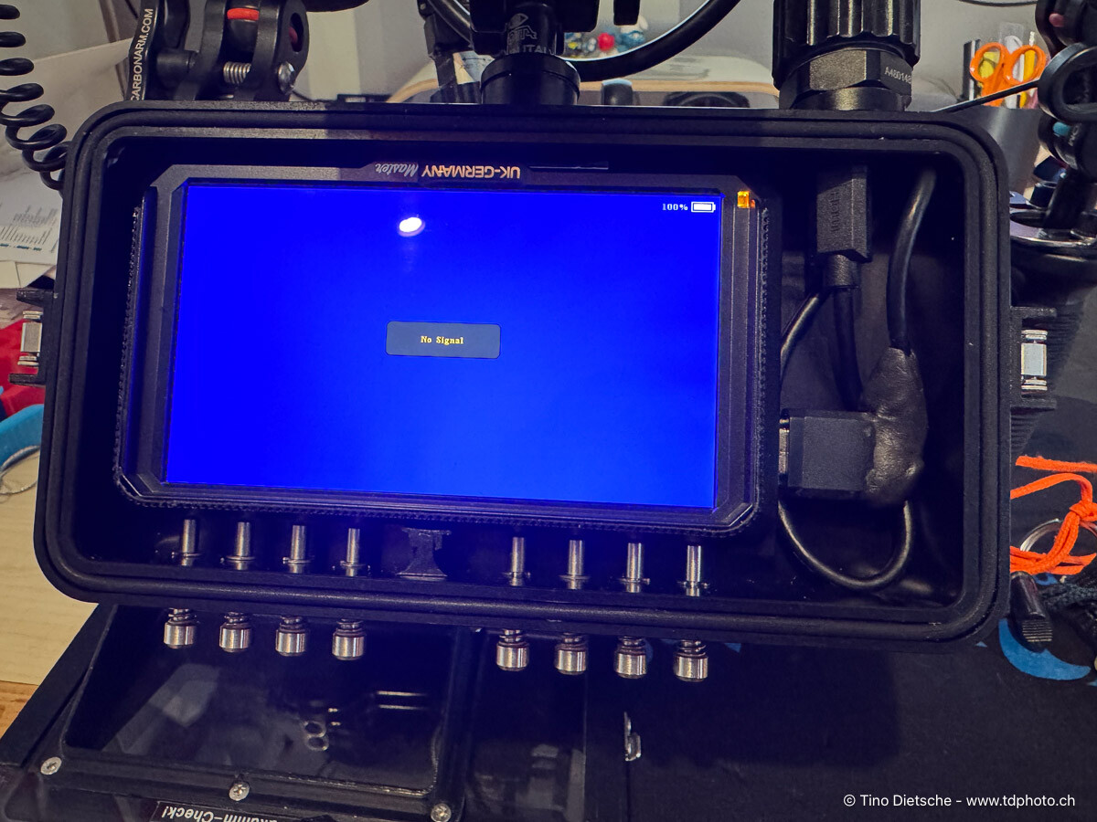

When it came to the battery, it was clear from the start that I could do at least two or three dives with one battery. For this reason, we decided on a maximum size of NP-F750.
This allows me to do three or even four dives.
The Monitor is an FeelWorld Master MA5

In the meantime, I'm considering whether I should create another series or another prototype of a case. Preferably even more compact. On paper, there are various approaches, including solutions using a smartphone instead of a regular monitor, connected to the camera via USB-C, and apps like Monitor+.
On the other hand, various products are now available. I just took a look at the new WeeFine WED-5 Pro a few days ago. It's a cool piece of equipment, also quite compact, and at around €1,200, the price is still reasonable.
My monitor case cost just over €1,000, including all the necessary sockets and cables, although the parts themselves were very expensive.

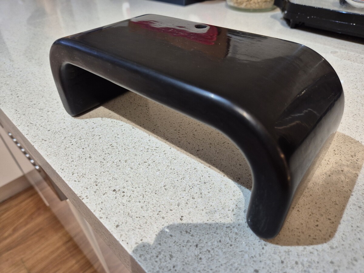

So I tried this and saw how long it lasted. I did a two hour shallow dive and it worked well... until right at the end as I was getting shallow and I noticed a pinhole stream of bubbles coming out of the top.

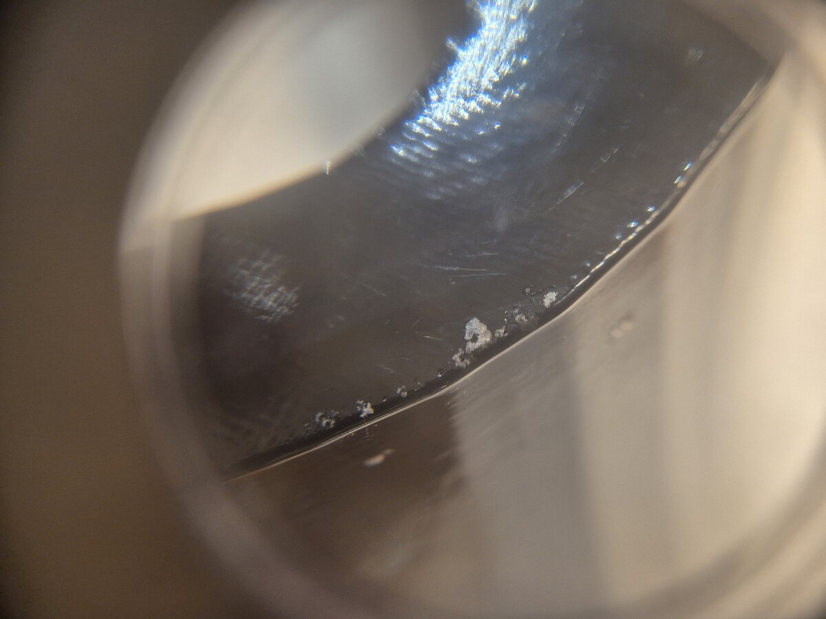

Clearly the float had spring a leak during the dive and had taken on some water.
I got it home and stuck it in a vacuum chamber and the salt water started leeching from a lot of the inter-layer gaps.

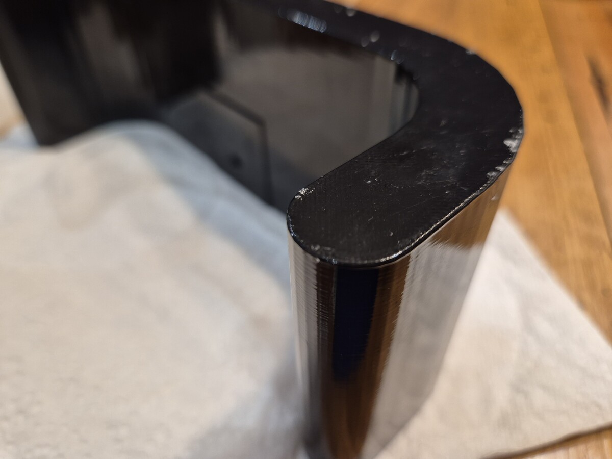

I sat on this for a while. I thought I could simply increase the number of layers and tweak the filament flow rate like some of the other posts have suggested. I believe printed ports are also made like this.
However, adding these layers meant the base weight of the float was jumping up significantly. So, in the end I decided to tweak the design slightly to have rounded edges and I layered up the part with epoxy and then top coated with layers of polyurethane. It's marginally lighter than a thick wall, over extruded print, but has the benefit of me being fairly certain it will never leak.
I've also started playing around with some ASA-Aero filament. It's ridiculously lighter than ASA and PETG, but not quite as strong. I'm planning to try a carbon fibre layup to see how that goes.
PS, im very happy with the screen itself and where I've positioned it. I had it on the lowest brightness and never had an issue clearly seeing the images from many angles.
What material did you print with? I found ABS to be a lot lighter than PETG and 2mm perimeters to be strong enough. 6-8% infill was enough to support the top layers and keep weight down. I also rounded the edges.

I used ASA. Im guessing 2mm walls is 5 layers? That added a relatively large mass to my prints that I felt was better created with definitely sealed, thin layers of epoxy and polyurethane resin.

I went through everything you are doing with resin and poly. What i suspect you will find is that the float will crack and leak regardless of coatings. If your part is not strong enough to withstand the pressure it will crack. Only mechanical strength will solve that problem. I found 4 perimeters of .5mm and minimal infill was a sweet spot with ABS. At least 100ft with 50+ dives so far. ASA may be similar. ABS and ASA can be acetone smoothed for sealing and aesthetics.
