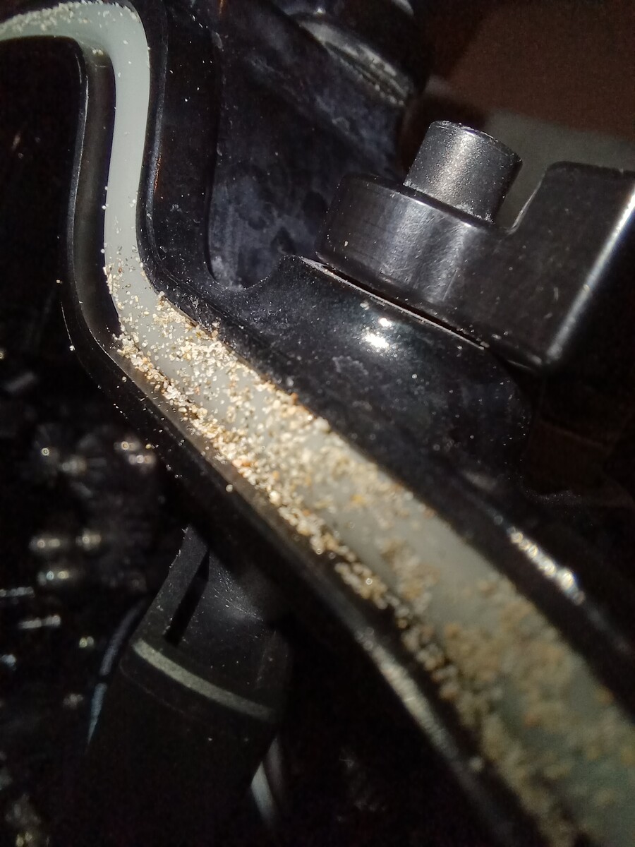

I'm doing some shore dives and each time I'm forced to remove everything. This is the main o-ring when I open the housing after a thorough wash and 1 hour bath 🤧
